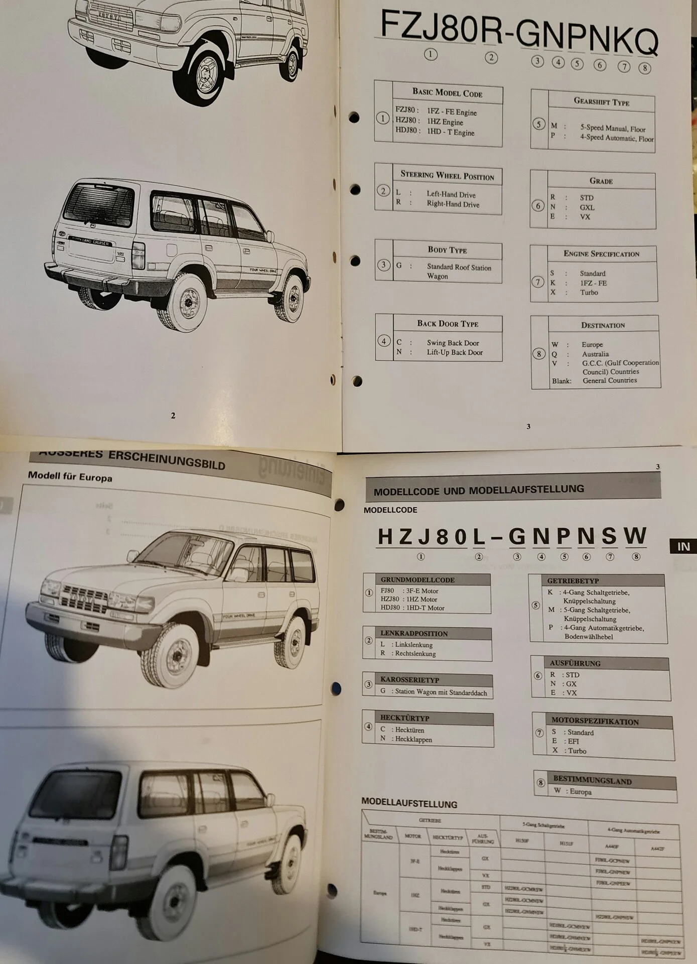

Same market?
on 2nd thought maybe not... The 1995 truck has the letter W for the market in the model code, which as far as I know stands for Europe.
The 1991 truck has the letter X in the same place, and I still have not found out what X is supposed to mean.
My truck which is a 1991 HDJ80 as well, also has the letter X, and I know for a fact that mine was imported by our Toyota dealership brand new.
Mabey X is supposed to mean blank= General export ?
This is my reference btw: https://landcruiserhm.com/images/pdfs-doc/Model_Decoder_v2_20200429.pdf
That's a good guide, but it doesn't totally match the original encoding rules for the 80 series. Here's the word from the new car features manuals for the 80 series:
I have not seen this manual before, but okay that settles this then, the trucks both have the same last letter (W) so they are both set up for the same market.
