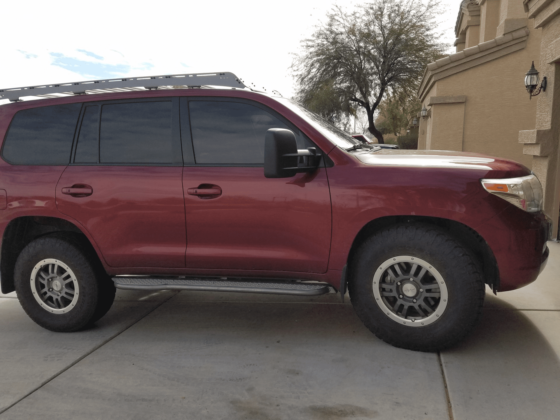

short.....doesn't ride horrible, but I do miss the Icons.
just a temporary set up while Icons are getting rebuilt.
If you have the Tundra set up ready to go, you could install everything and get Bilstien lift struts for the Tundra. They would ride a little stiff, but would be easier to sell down the road.
first pic is with Icons installed, riding at 24" from hub to fender.
second pic is with stock shocks and 10mm spacer.
