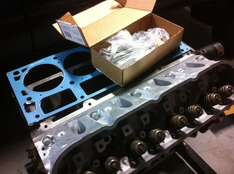

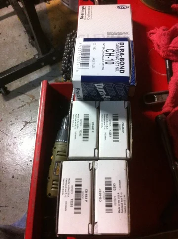

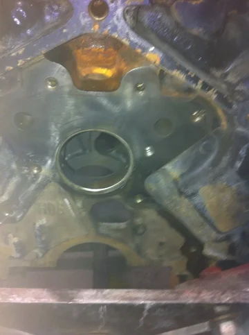

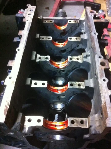

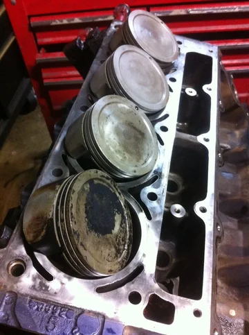

2002 Chevy 6.0 LQ4 Had low oil pressure and would foul 2 cylinders so after pulling it I found worn cam bearings and blow by on #7. So it was torn down sent off to be bored .30 over, heads rebuilt, new Speed Pro pistons and rings, Clevite bearings and Felpro gaskets. No El Cheapo parts in the motor.
felpro mls and head bolts.webp teardown #7 blow by.webp main bearing 1.webp mains and cam.webp
