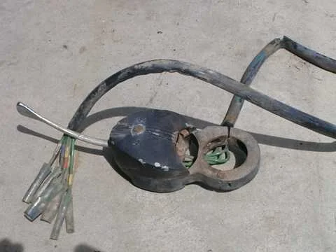

John Pardi and I had thrown around a few ideas about these awhile back and the best solution we could come up with would involve some good old fashion shop time. So today I removed the PO version of the lever with the thought in mind of coming up with something a little better.
here is a shot of the lever I have, I had nothing but this to go off of so I pretty much winged it and made something I thought looked somewhat legit from a piece of 3/8 round stock

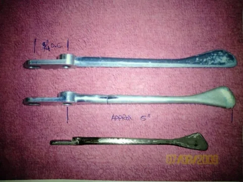

The top two are from a picture Jim sent to me a while back. The middle one is the 25 series with the infamously broken paddle.
The bottom one is my nearly finished one, it will be going to the powder coaster for a thin coat of "chrome"
The images are nearly 30 larger in scale. All measurements are very close to identical. Without the powder coating, this project consumed approximately 3 full days.
