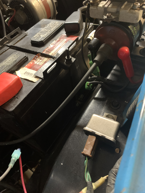

Remember guys the OEM flasher is a CURRENT activated device. It MUST have a certain amount of current flowing in order to flash. This is why the Hazards almost alwyas work as there are 4 bulbs all drawing current. In turn signal mode, only TWO bulbs draw current. If one bulb is not working, or has a poor, or no GROUND, then not enoguh current flows and the light comes on but does not flash.
So what does the headlignts have to do with this? Electrically they have nothing to do with the turn signals. The headlights have a dedicated ground wire running to them for reliability reasons. Now if your battery is weak, then yes, headlights on can pull the voltage down to the point the flasher will not activate.
So long story short: CHECK EACH LIGHTS GROUND!
