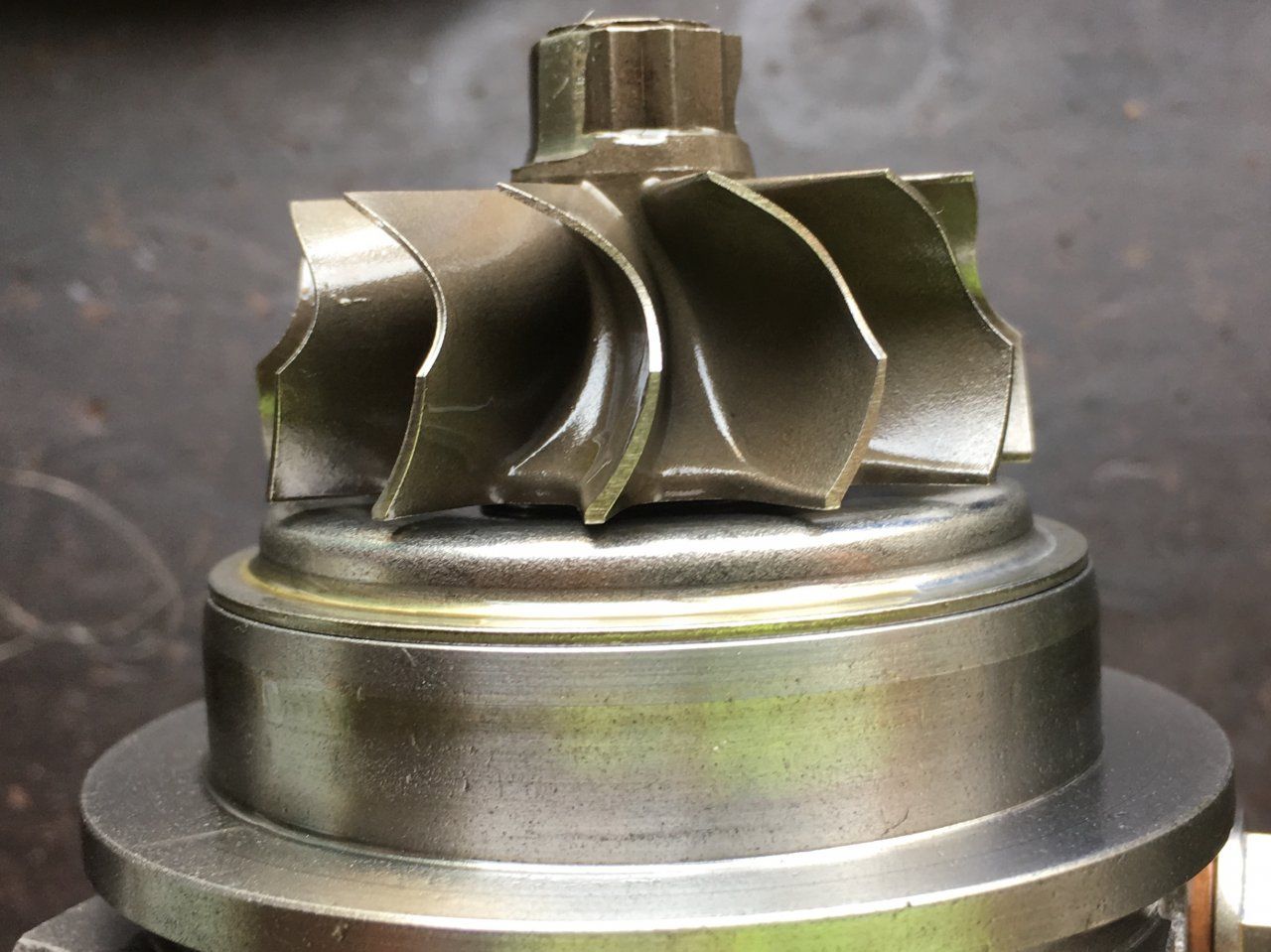

This is the td04l turbine I have . It seems to be a cross between a gen 1 and gen 2 . It has a far tighter radius in the centre of the blade than the standard turbo (tf035) . Any thought Gerg or Dougal ? I can find plenty old tech aero design turbines for the tdo4L but nothing like the new tech (gen3 ) (holset he221 or mixed flow ihi rhf style ) anyone know if they're available ? My local turbo shop gave me a Blank look when I asked. His suggestion was a gt25 garret . It was at that point I thanked him and hung up.
If your so bent on maximizing a single turbo, I'd strongly consider a twin scroll option. There are 8.5 cm versions available on Volvos. Comes witha td04L turbine. Well suited to your size. Yould have to swap the compressor and cover, but if your running high boost like that you should redo the internals anyway. You might get away with the 12t, who knows. Never seen a map on it though. course it requires a custom manifold.

The HE211 (not HE221) turbine has similar dimensions to the TD04L and might have a more modern wheel. I think I remember Dougal saying on 4BTswaps the HE211 is part of the TD04 family. The 211 compressor map has a very similar surge line to the GT2052 but flows about 9lbs/min more and goes up to a pressure ratio of 3.5.
Surely the later model Foresters (TD04L-13t) would have quite a modern wheel.

The wrx turbo is basically the exact same size turbine as the standard td04 with a 6cm housing. The td04l is a 41/47mmturbine, but more importantly the 13t is a 40.6/56mm compressor. With extended tips that goes to 58mm. It's inducer doesn't need to grab as much air as the Garrett (faster spool). So it's not flowing as much as the 52 Garrett, but much much larger exducer which give it great pressure ratios and faster spool. On my 3b it easily made 10lbs at 1500rpm. It is not a slow spooling turbo. And that was a standard 6+6 without the extended tips. Extended tips spool faster and widen the entire map. 11blades are a plus.
