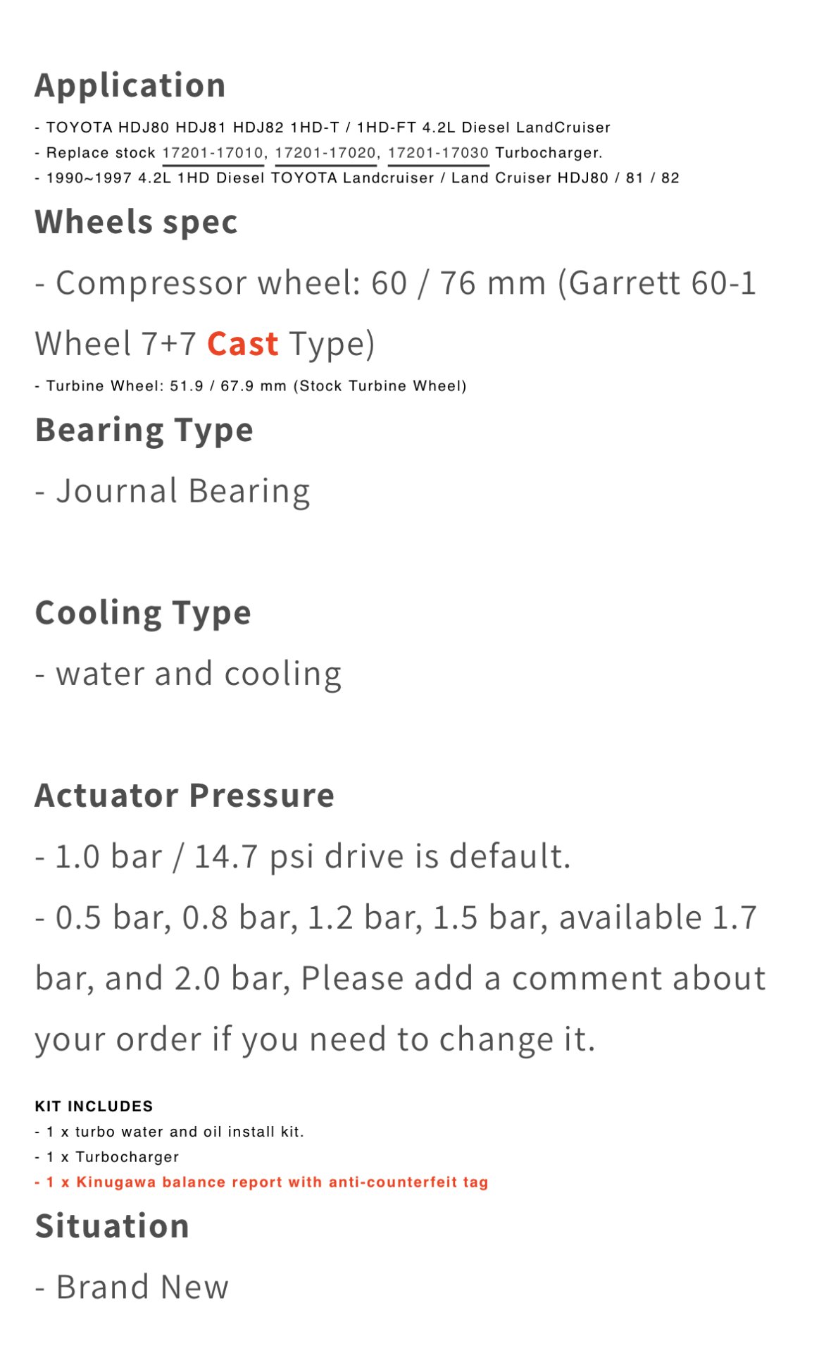

Thanks for that. I've already purchased this Turbo as it's advertised as a "Bolt On" swap and
"Upgraded " from their previous version.

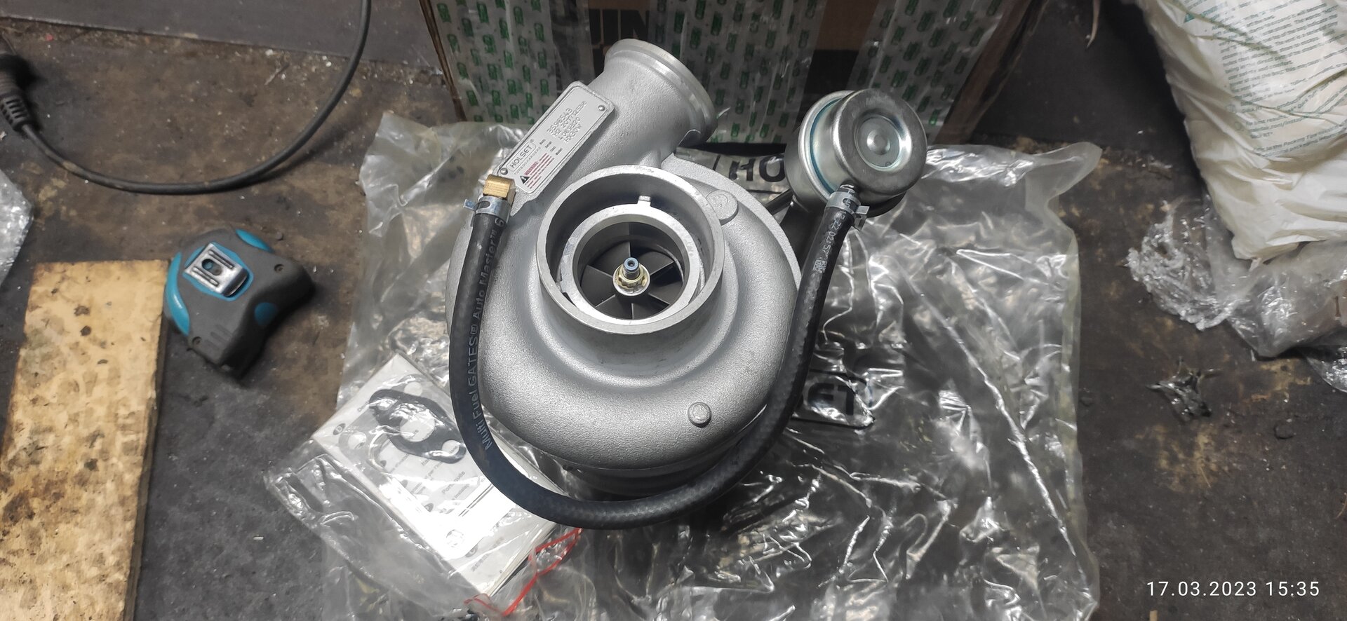

i am simply happy with my vast collection of NOS DIESEL TURBO 's ....,. :D
