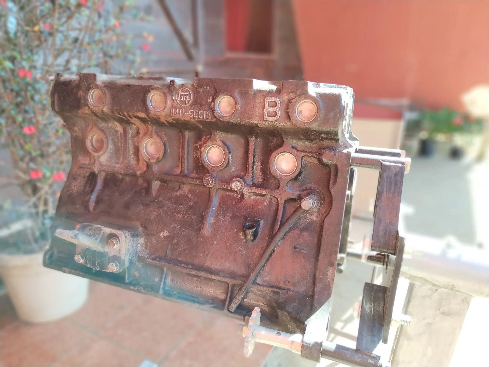

Hello guys I'm new over here and I have a project a bj40 1978 currently refreshing the engine (B engine) I am stroking the engine to the 2b specs 3.2
And I want to add a turbo on it which turbo set up would you recommend me?
Thank you very much and it's a pleasure to be in this forum.
I am from Costa Rica and the issue is that most of the turbos are Chinese over here.
I am from Costa Rica and the issue is that most of the turbos are Chinese over here. View attachment 3205992
We are the Whistle and Soot distributors for the Americas and I have a shop in Nicaragua where you could pick it up or get it installed!
td04l-13t subaru take offs, or new mamba, kinugawaw, etc
put a 'kit' together yourself, easy to do.....
if you dont wana build a manifold wistle and soot has em , or get a 13bt one, ebay etc
