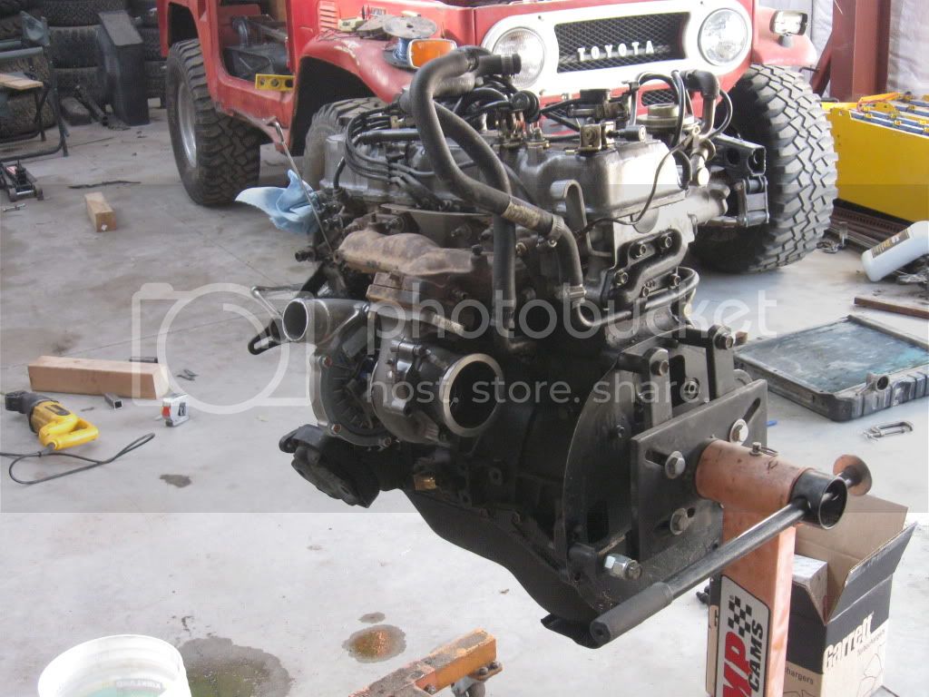

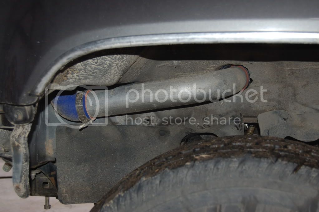

Thats where the stock pipe runs
I finally got it running, thank God, and boy howdy she gets up and goes. Max boost of 15psi, WAY too much, I'm going to put a regulator on it to keep it near 10. Until than, i watch it pretty close (lots of human error when the turbo whines for more). The other day I went to pass someone doing 45 in a 55, on my way back from work, I down shifted and the next thing I knew I was doing dang near 80.

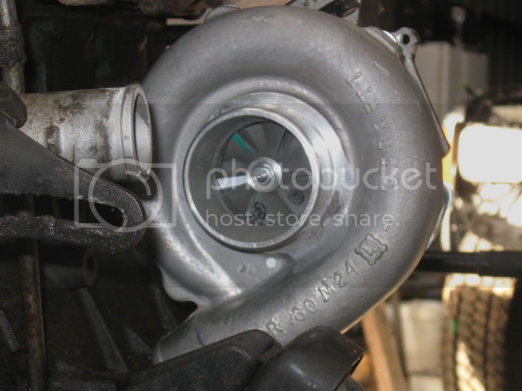

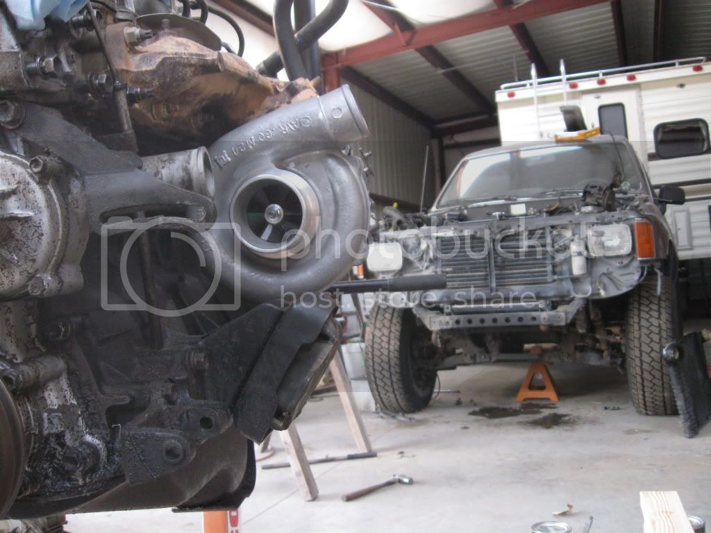

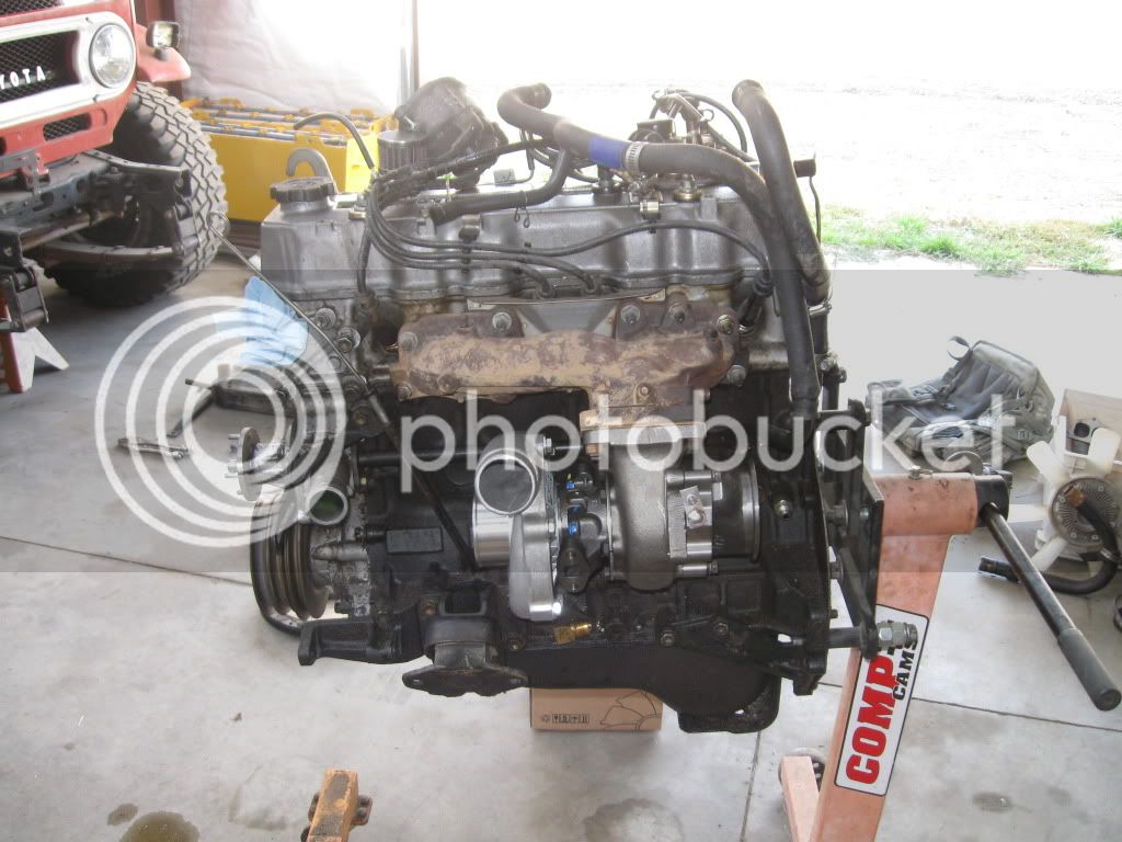

Well my turbo crapped it bearings out about a year ago on my way back to Idaho from california. I don't think i let it idle long enough after driving it 14 hours straight. Any who I took it to a local turbo guy and he said that he would have to send it out to get the races machined larger he asked if I found the turbo o. Some car or one the ground I told it was probably because I drove it 400 miles with the seals blown out of it. He laughed and said it would run me somethig in the range of $600 bucks to get the machining done. I told him to hold off and I would look into getting a new one. I found a brand new Garrett with a waste gate for not too much more than that. I bought the new turbo with no remorse intrashubg the old one.

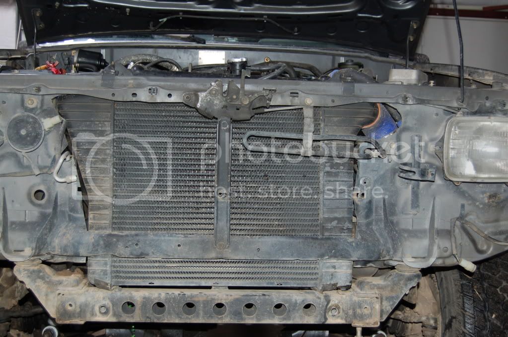

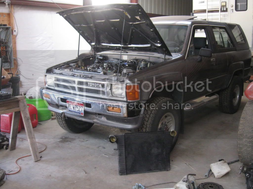

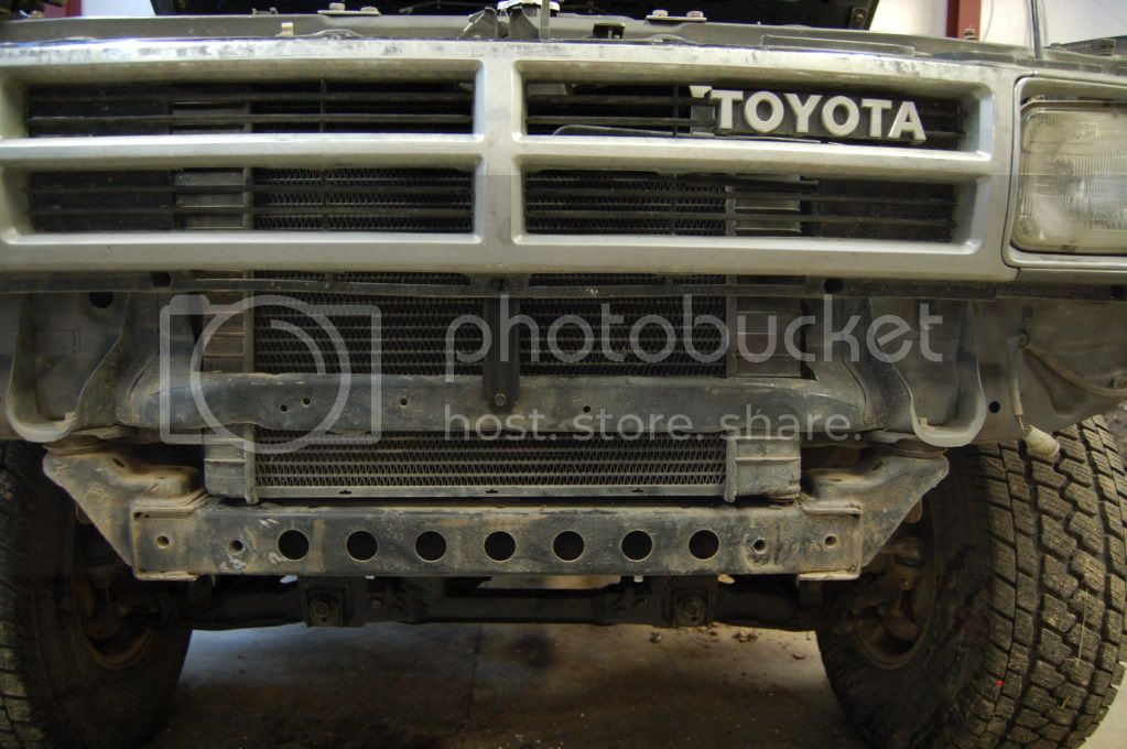

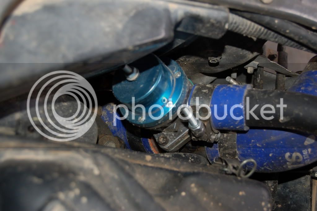

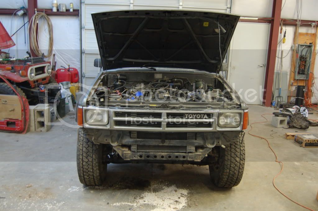

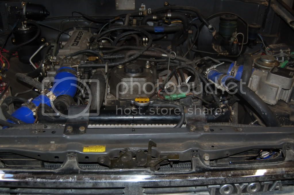

I have spent the last year getting the turbo in, oil lines run, Volvo intercooler installed, blow off valve plumbed in, and other shenanigans. I'll put some pics up later.

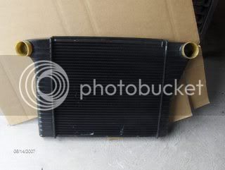

Wow can't believe almost a year has gone by. Well I've got her back up and running. The last turbo got replaced with a larger garrett. Added a large-ish Volvo intercooler from like a 740 i think? Temporarily have the A/C out. Running around 8-10 PSI. When the last turbo died I popped the head off to make sure everything looked hunky-dorey and put on some ARP studs while it was apart. As of now everything runs pretty awesome. Because of the intercooler, larger turbo, blow off valve, etc, etc, the computer can get confused relatively easily which is annoying but the only way around that is to go with Megasquirt. Some day i'll actually make the swap then who knows what will happen after that.

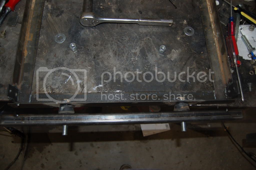

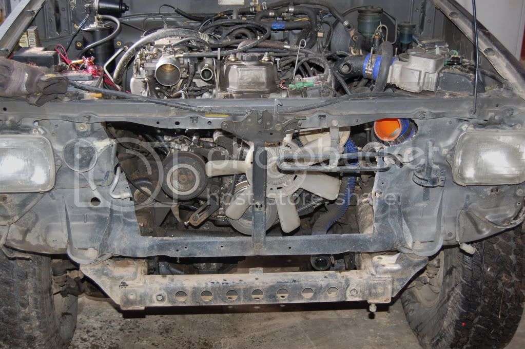

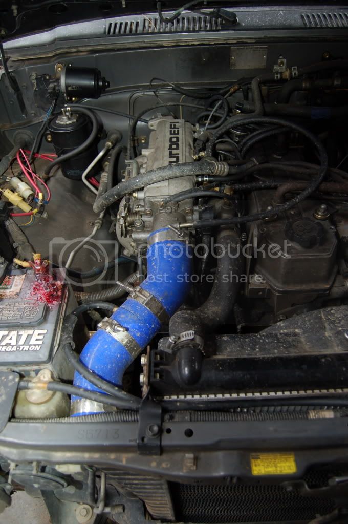

Here are some pics of my second build of intercooler/radiator and other transformations.

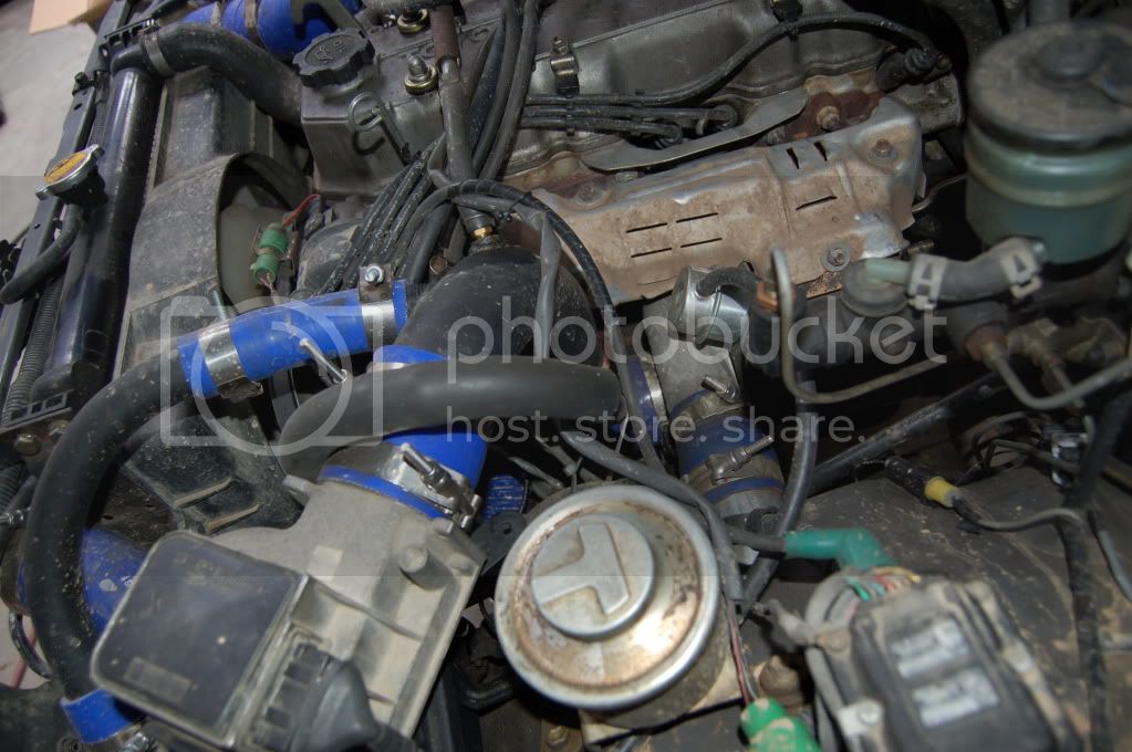

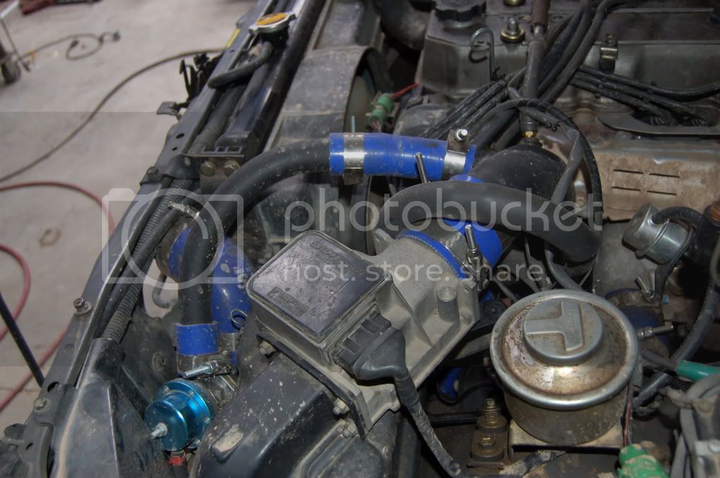

Two more of the pipe routing and the blow off valve
