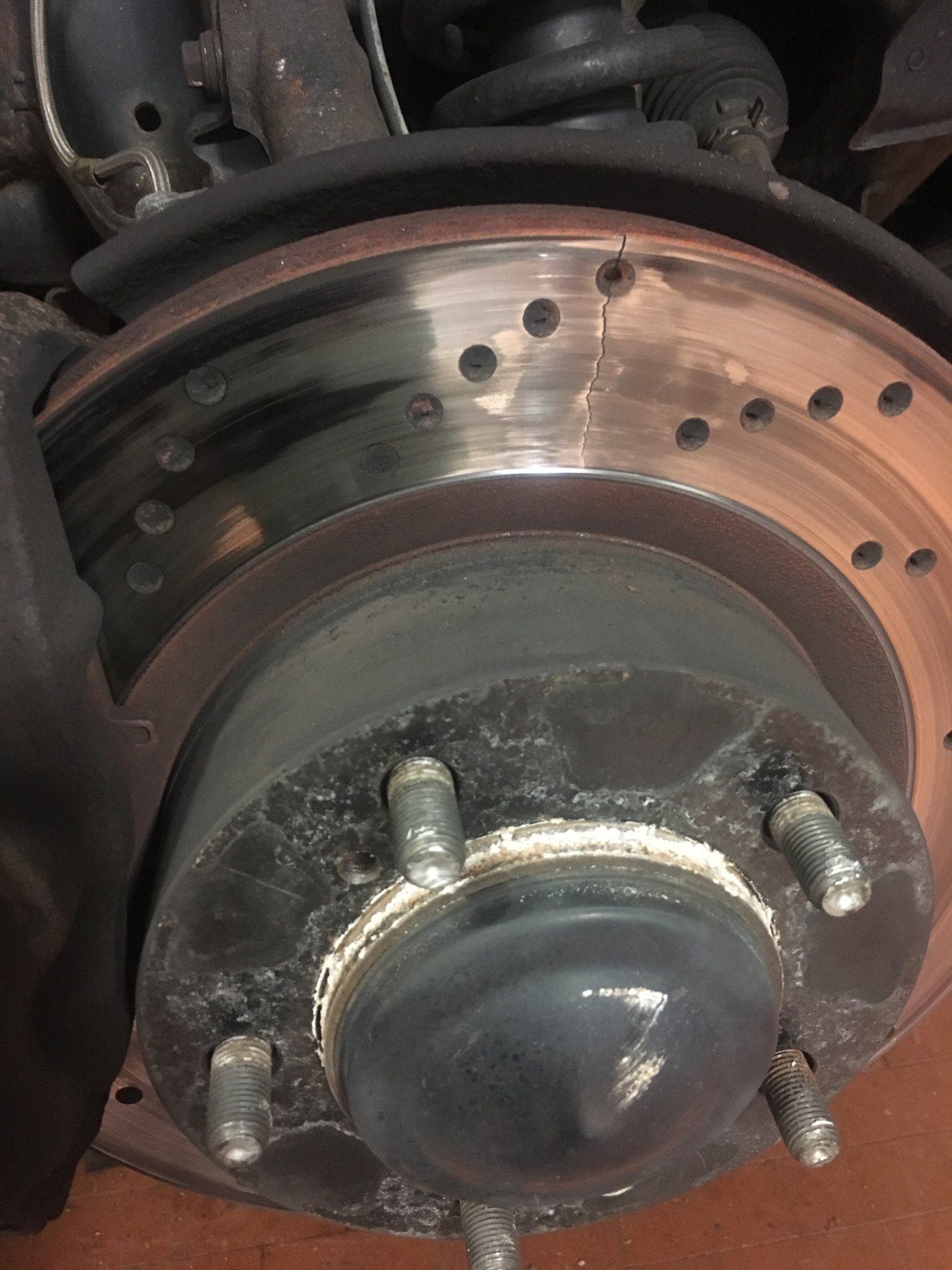

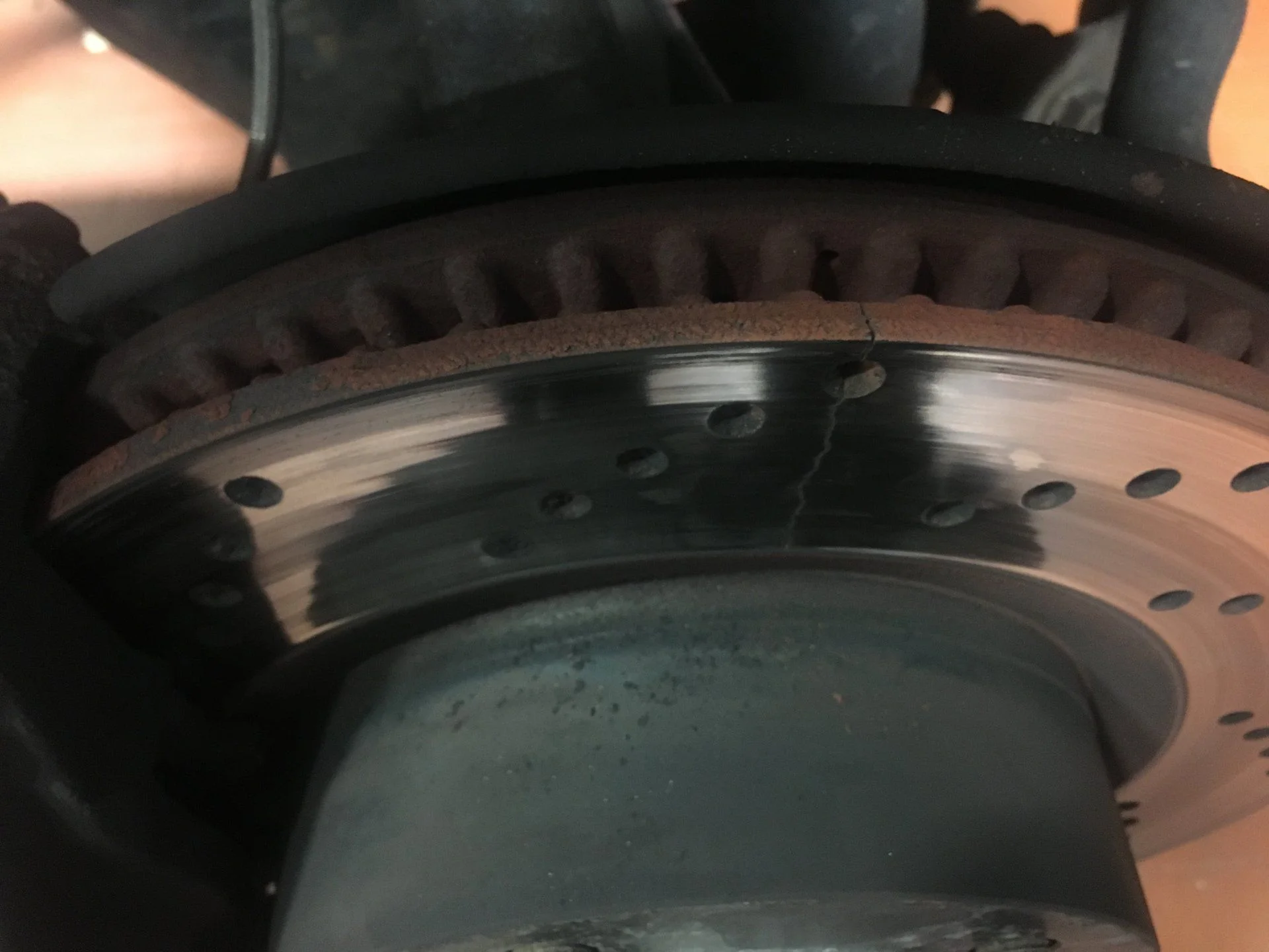

i'm in desparate need of a front caliper/rotor and front pads. After riding on Stop Tech drilled rotors+TRD pads for the past 9 months I discovered today that my front rotor was cracked (along with a bad front caliper; 2 upper piston orings blown outon rt front caliper), while doing a wheel ballance. good times... My question if anyone can help me is while shopping for front calipers+rotors, will Tundra TRD calipers+rotors fit my 08' LC with stock 18''s and 285/65/18 KO2?

9 months on this setup? How many miles? ~10k?
This is exactly the reason I won't run slotted and drilled rotors. I know better from my track days. They are opportunities for stress risers, especially for a stressed part that sees potentially dramatic heat cycles, depending on use. Yet most general users never truly tax their brakes with hard stops from high speed, yet pronounce their upgraded brakes as "better". It's a strictly a styling feature. Racers that truly use brakes avoid this stuff.
Metallurgy is another hit or miss. A lot of the aftermarket stuff is low grade castings with marketing and branding. The good stuff comes for a price. This is another reason I do OEM when possible. You know the stuff is quality controlled and validated. When most people question stock brake performance, especially on a higher priced vehicle such as the LC, it's because its worn. Refreshing it with new stock parts, a good flush, will bring performance back.

Thans for the reply. I put 21k in the past 12 months so probably aprox 15k in 9 months. My 08' has 172k so I'm guessing the calipers were oem orig. My bud who pointed out the o-ring piston fail in the failed caliper pointed out that the two o-ring pistons that were torn (?) are what caused the fail. Apparently once the piston rubber rings failed, heat caused the crack of the rotor which in turn shreaded my TRD pad like a chease grader. My left front caliper/rotor and pad show normal wear...
When I upgraded to Goodrich steal lines,StopTech drilled rotors+TRD pads I should of gone with nw calipers as well, at the time finances did not allow that...
Can I "plug and play" 07'+ Tundrea TRD caliers+rotors?
