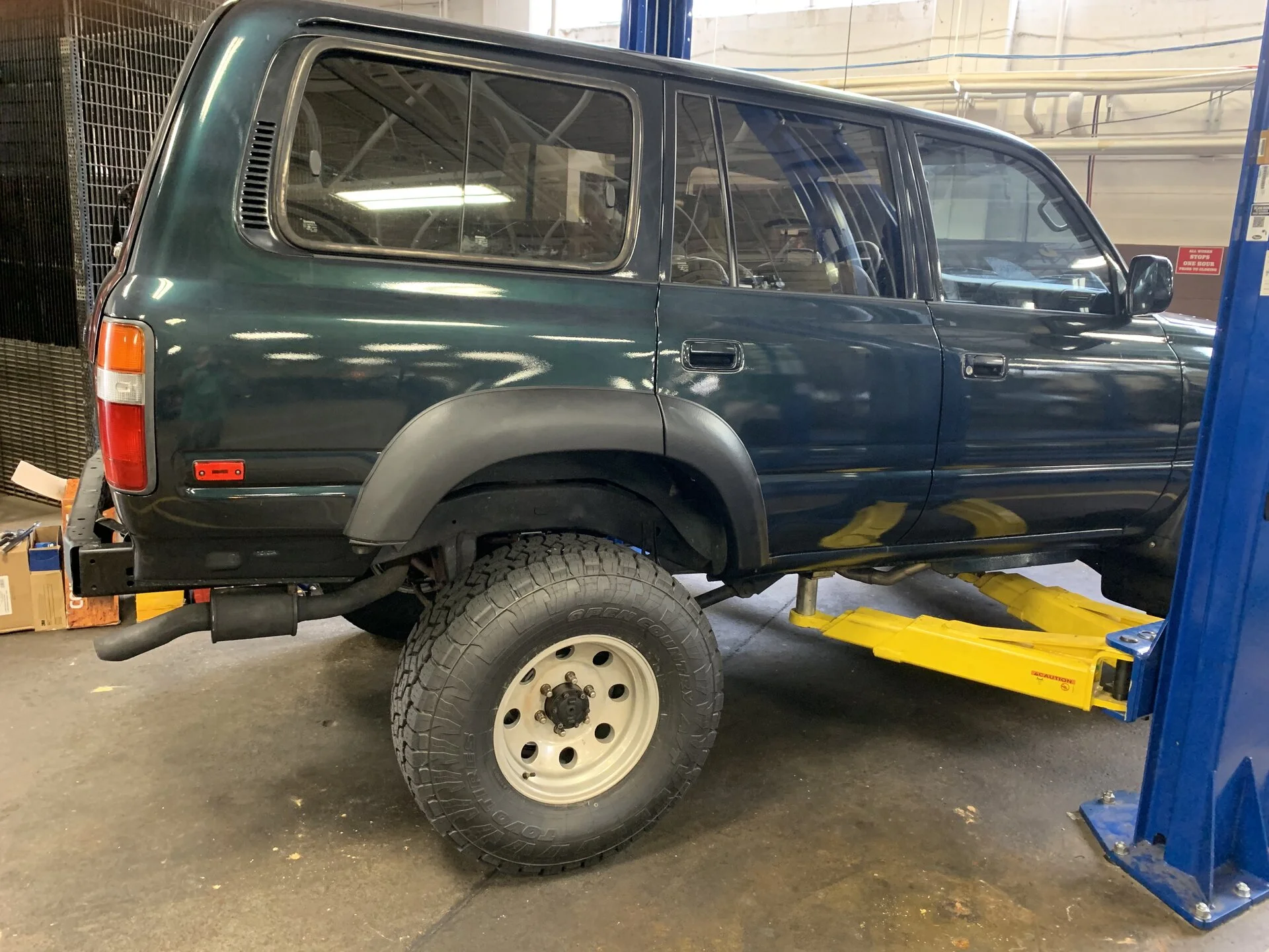

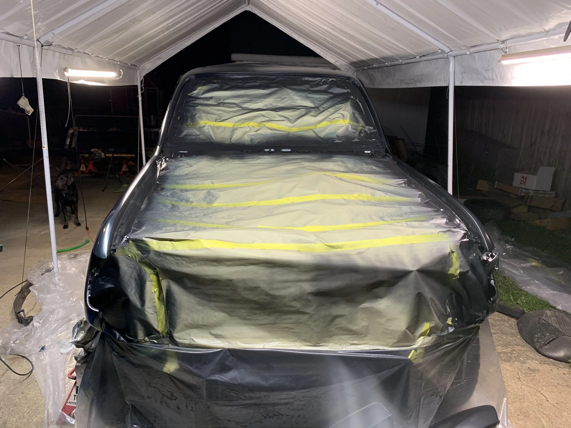

The FujiSpray turbine exceeded my expectations by a long shot! I ended up removing the factory rack on the roof and welding up the holes, patching a couple large rust spots under the fender flares, repairing rusted out holes in the rockers under the passenger rear doors, and sanding off the old clear coat. Next I used the sprayer to lay down a coat of black sealer, then painted with fresh dark emerald green, followed by clear coat. This was all done outside under a Harbor Freight carport awning. 90% of the truck turned out smooth as glass. The 10% that didn’t was due to operator error…this was my first attempt at painting, so I’ll take it as a win. Even the 10% that was the worst, was still equal to or slightly better than the factory finish. I was under a time crunch to get finished and get the truck back on the road for a summer road trip before we closed on our new place in TN, so I don’t have the greatest pictures. Here is some of what I was able to find.
I went ahead and pulled all the glass because half the rubber needed replacing anyway. That also allowed me to check for rot…which I found and fixed on the upper tailgate and DS cargo window.

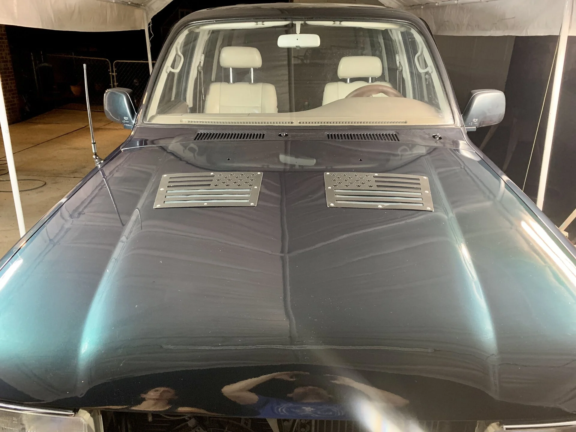

The hood vents allowed me to finish off the hood and avoid patching a large rust spot that would have been hard to keep from warping. This is a couple days after painting with the windshield back in. The dust and bugs aren’t in the clear, just on it.

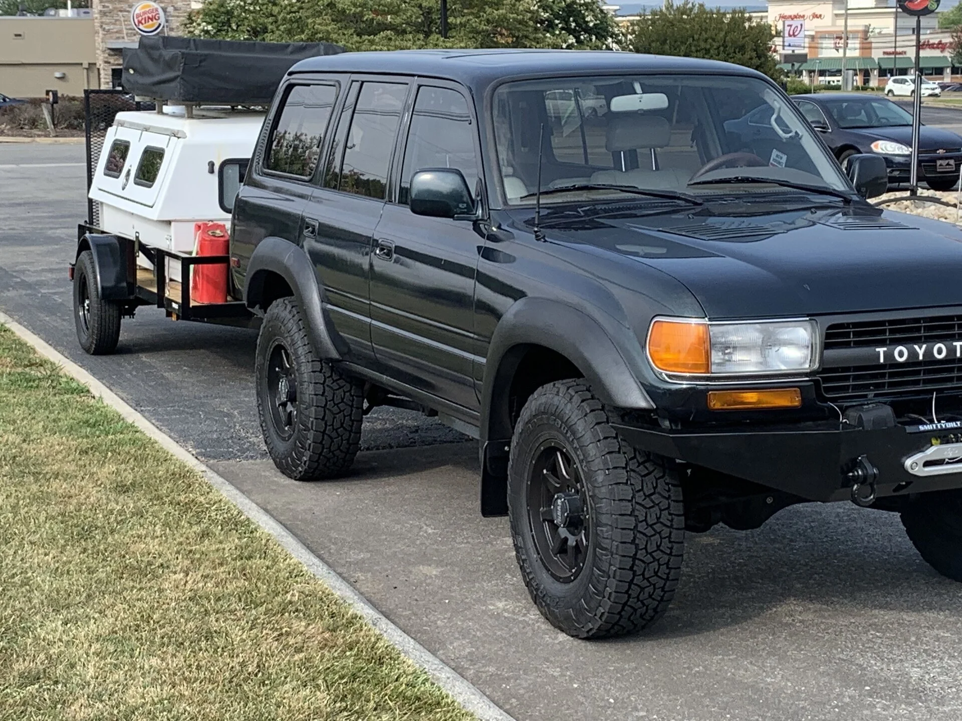

This is about a week later when I was refreshing the steering knuckles. I don’t think it’s too bad for a first time, especially for a truck intended to be off pavement.
This was the beginning of our road trip.
