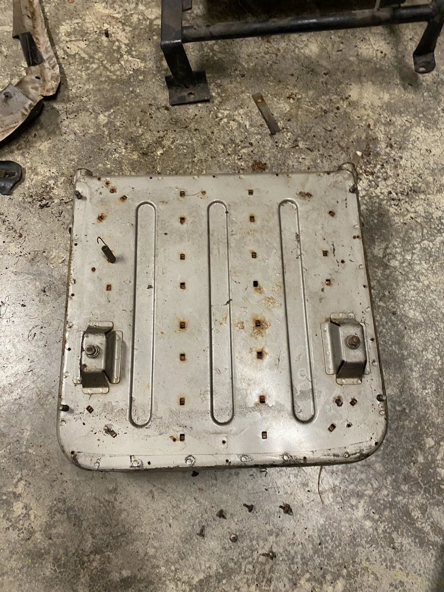

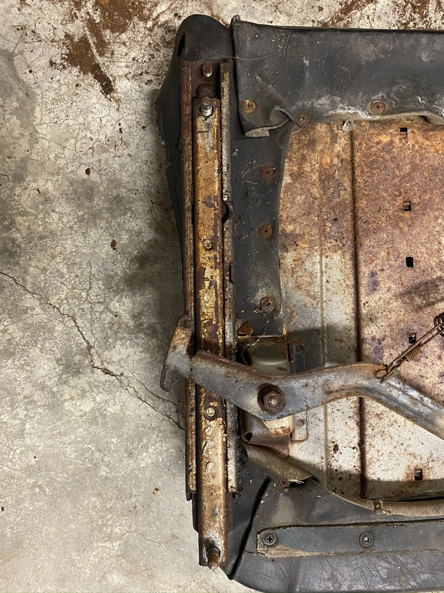

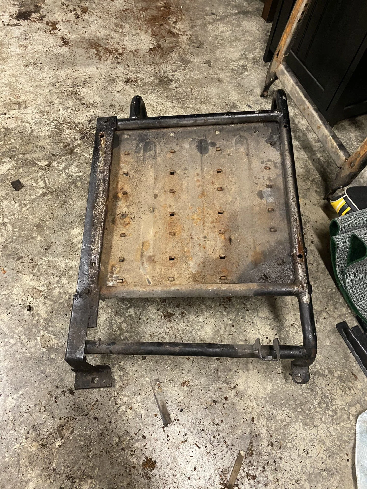

We have gotten our new seat covers and cushions in and have been taking off the original seat covers and pads. On the bottom of each of the frames, we are having trouble getting the bottom seat off of the bottom of the frame. It appears that they are supposed to slide, but the rust will not release. I don’t want to damage any of the threads on the bolts and wanted to get input from the forum here.
We have sprayed extensively with Liquid Wrench but still will not budge. Any advice?

I just restored my front seats, same vintage. It could be that the frame could be “warped” enough to create some friction at the bolts that hold the sliders to the frame. As if the mount bolts got closer together. Try a short, flat pry bar and gently walk it up, just try not to muck up the threads. I don’t know if any of that makes sense.
The PB Blaster worked! I coated the rails good and then was able to tap with a rubber mallet to get it to slide enough to reveal the nut. Thanks for the suggestion! Now lots of cleanup, repaint, and then recover!

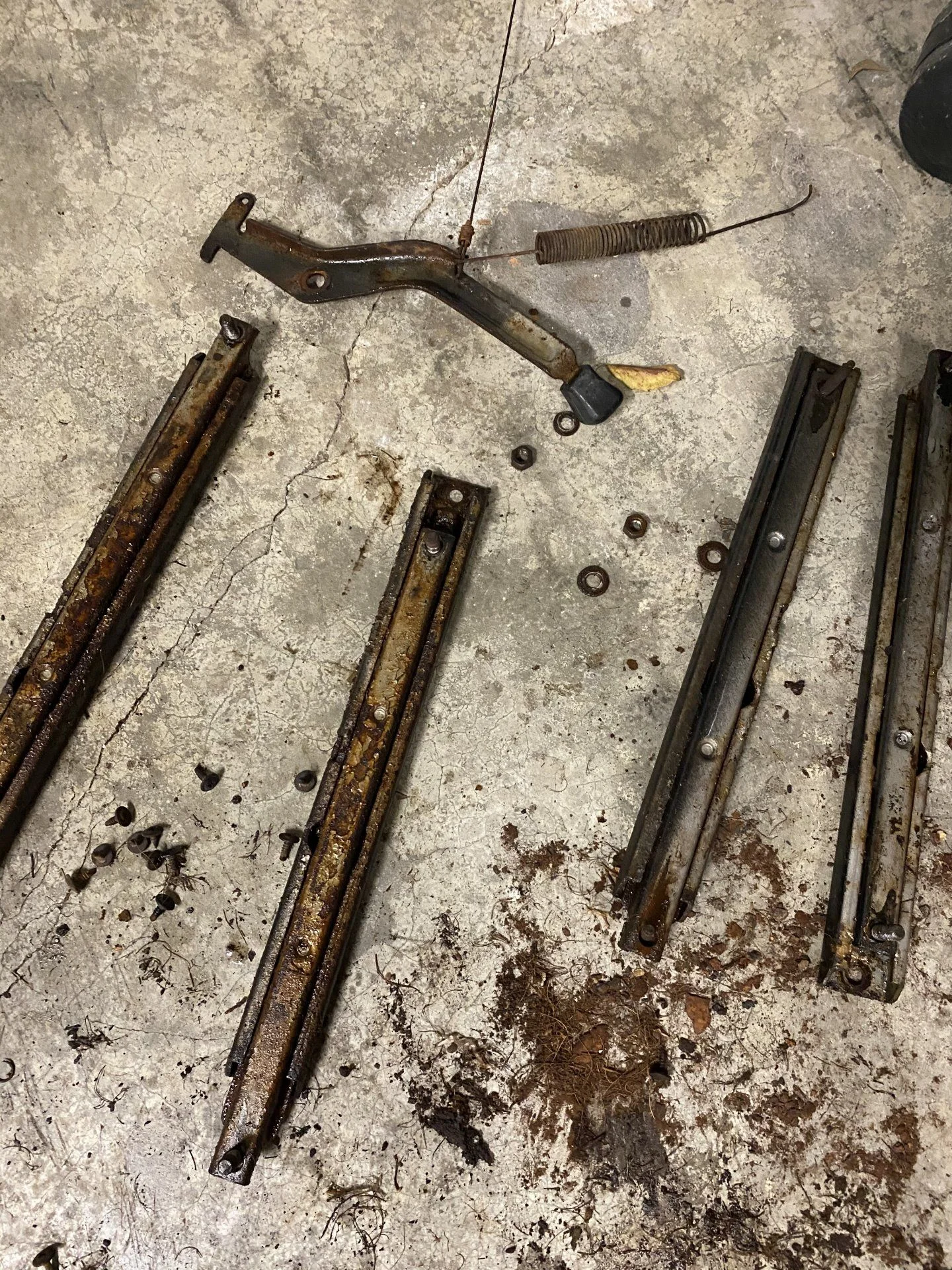

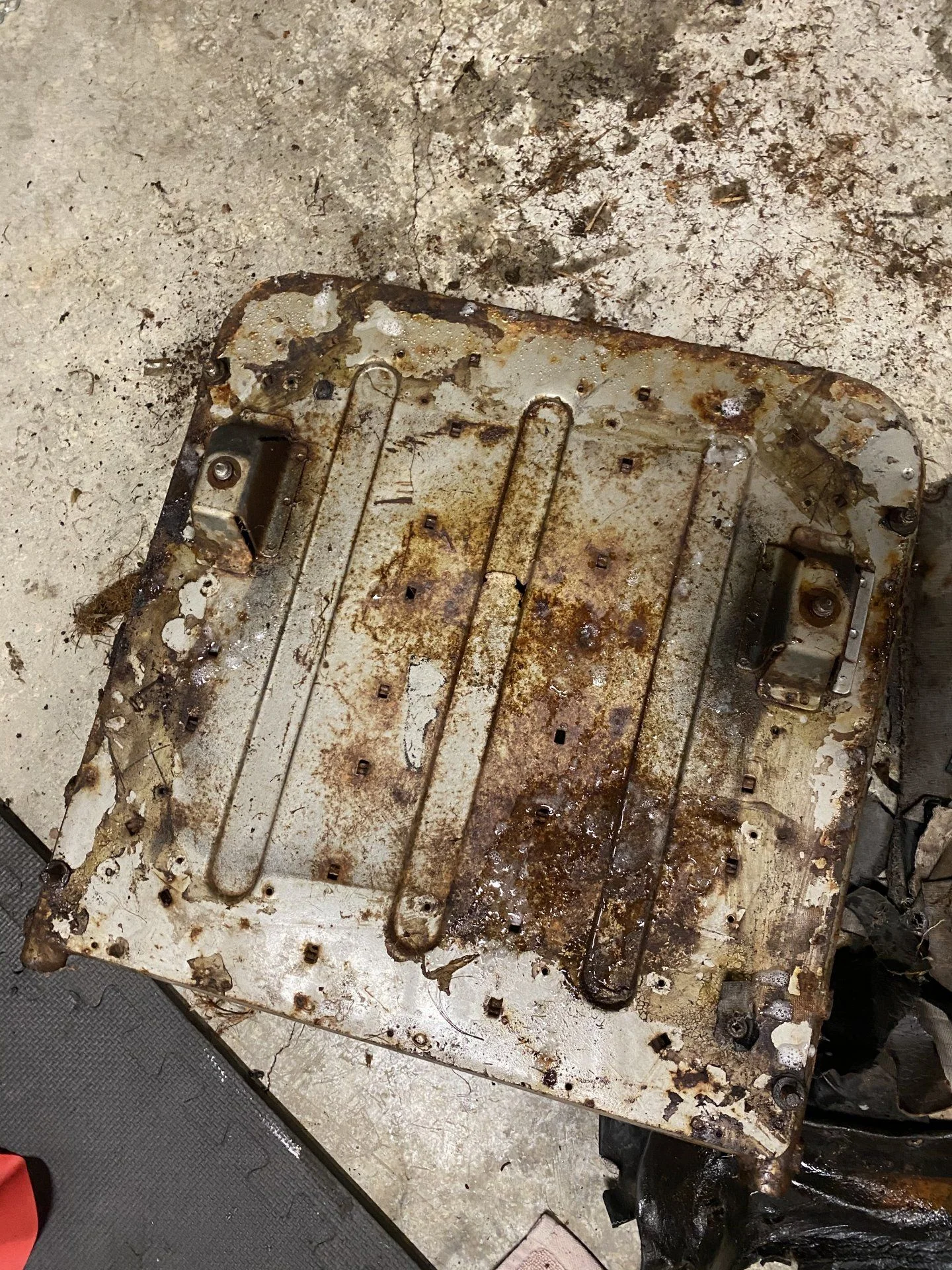

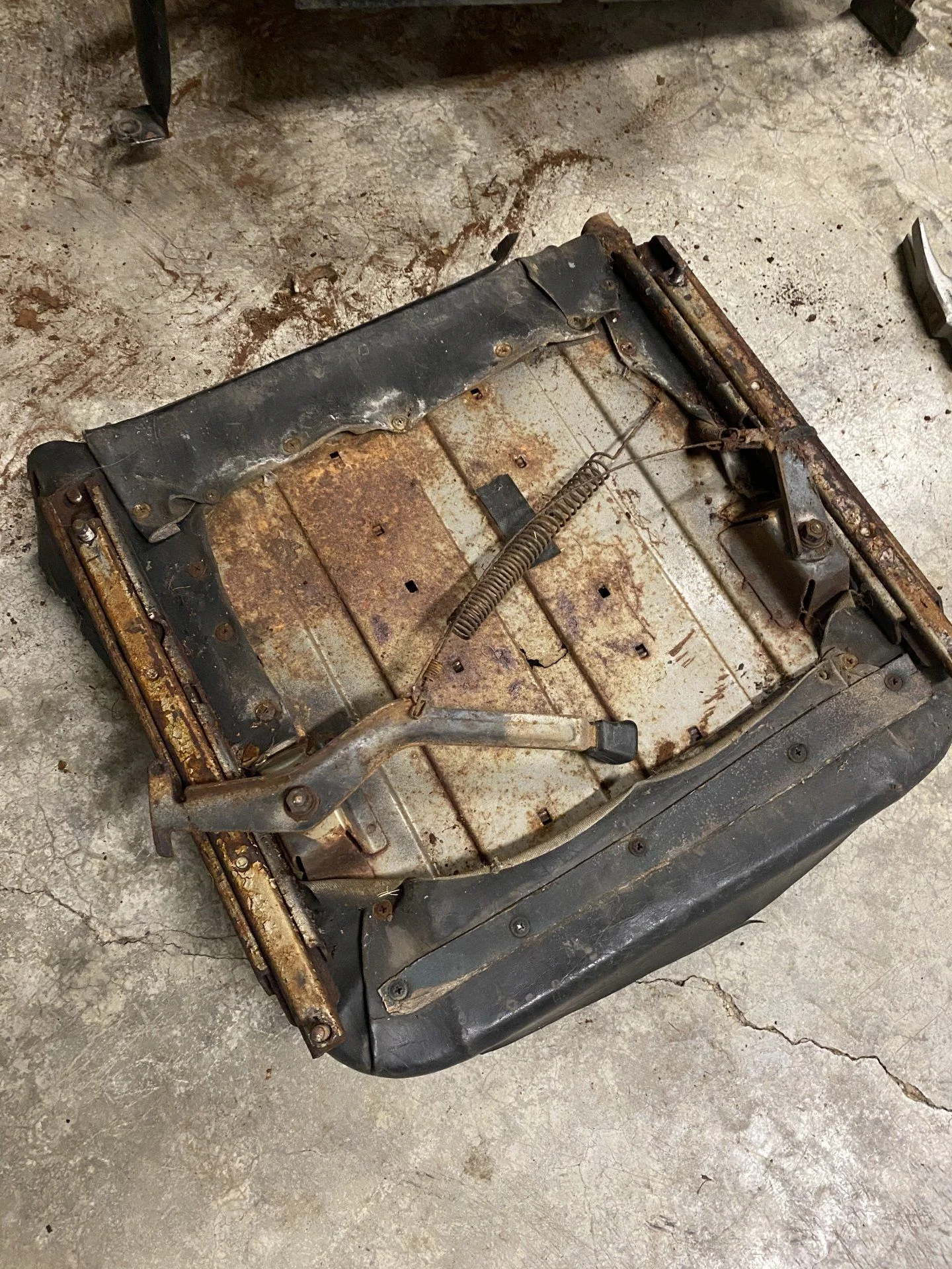

View attachment 2362489View attachment 2362490View attachment 2362491View attachment 2362492
So as we are going about cleaning up these sliders, the thought occurred to me that we might get them sliding so well that the seats are sliding back and forth. As you can see on the photos before I got them to release, one of the seats had a spring and release handle that you would use to let the seat up and back. Without that in place, do I run the risk of getting these moving so well that the seats no longer hold in place?
I would think yes, the seat would slide forward/back without having the locking mechanism in place. Both hooks hold the seat from sliding.
