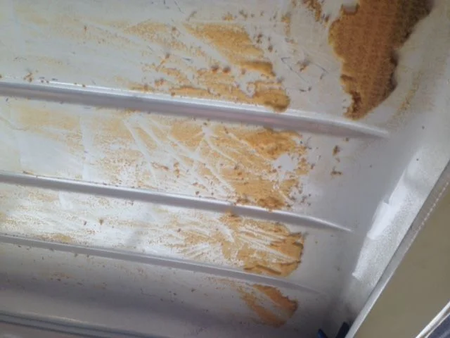

OK. Got the first section of headliner out and most of the foam. Now I have the leftover glue residue to remove before putting up dynamat's "dynaliner" then a new foam backed headliner. I've read/heard everything from 409 > peanut butter > acetone will take it off. Never heard from the TOA guys, so maybe someone here has an idea?

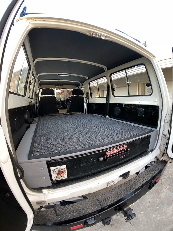

I used goo-gone citrus spray on mine along with a heat gun and scraper. I remade it in three sections like the original but out of foam backed fabric.
Untitled by CA18 Sean, on Flickr
Got a few wrinkles in it, but I was installing it by myself. A second set of hands would help! I used 3M adhesive spray, whatever the strongest one they made was. Sprayed the roof, sprayed the fabric, waited for it to get tacky and then installed. I'm happy with the end result.
