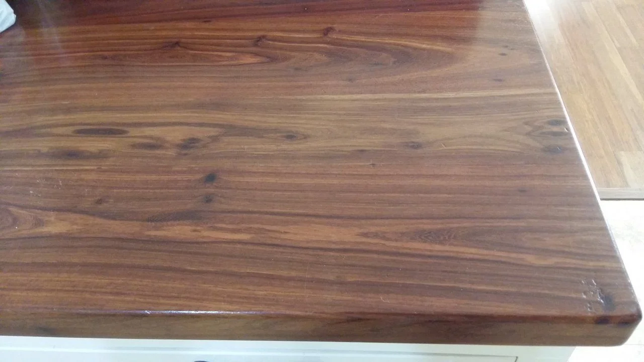

We will be putting in our 12mm plywood floor over the next two weeks. We have decided to stain the marine ply to a dark teak colour, and then seal with elvolac (a two part epoxycoat). We have used this product on our kitchen countertops, and it is completely water and heat proof. It is sold by Technipaint, and they have a branch in Joburg. I can really recommend this product, since I regularly spill boiling water on it, and it has not made any marks in 8 years.

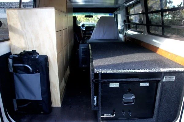

Our basic layout will be a 900mm high cupboard on the left hand side for clothing, food and kitchen utensils, with an induction plate and sink on-top, and a seat/bench running along the right hand side with the fridge behind the driver's seat. The join will probably run underneath this bench, since we plan to stop the high cupboard about 250mm short of the little door to accommodate folding chairs etc.

Hi, just a thought .... I will be making my high cupboard on the right (behind the driver in SA) as this is definitely in my blind-spot, leaving the left side lower/open so that I can see out that side when game watching. Would like to hear maybe why you are doing it on left.
One other, is that I would try to make the pull out stove plate also accessible if you are forced to cook while actually inside the vehicle. So maybe a flip up cushion/lid over the pullout stove section?
