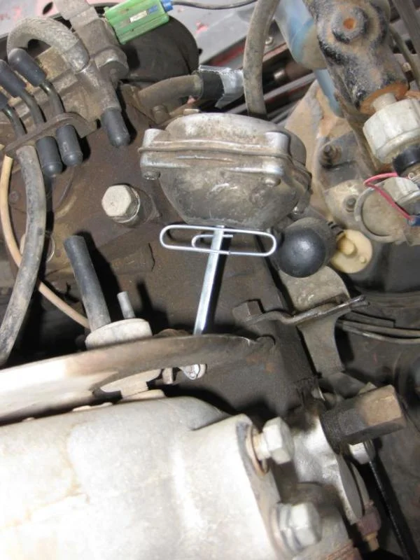

nevermind I used the search engine......I found this photo.
Wow...it ran great for about ten minutes and then finally it fell on its face for me. I turned the rig off and coasted to the side. Upon opening the hood. The paper clip is in the same position and the sight glass is empty or below view....

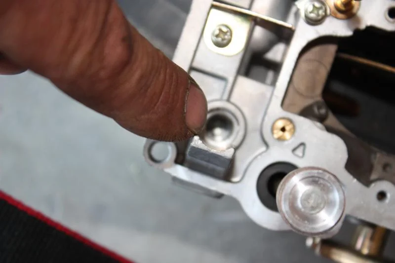

Behind the metering device off the fuel intake on the carb i found a piece of excess silcone from the jackass at the factory that maybe put a little to much on there to help the screen stay on the metering device. it was inside the filter where you can not see. The outside of the filter where dirt should be, was clean. it wasnt till i pulled the metering device out for the float and pryed out the filter that should come off with the metering device when i found the mentioned chunk of silicone....
Makes total sense now. The chunk of silicone rolling around in the metering device would occasionally get stuck causing fuel restriction...
Heres a pic of the culprit. Im removing the screen and adding another filter to the system pre carb.
The first pic I'm pointing at the culprit..
Second pic is where the screen, culprit and metering device are located.
I havent put everything back together yet..but Im sure this was my problem.
