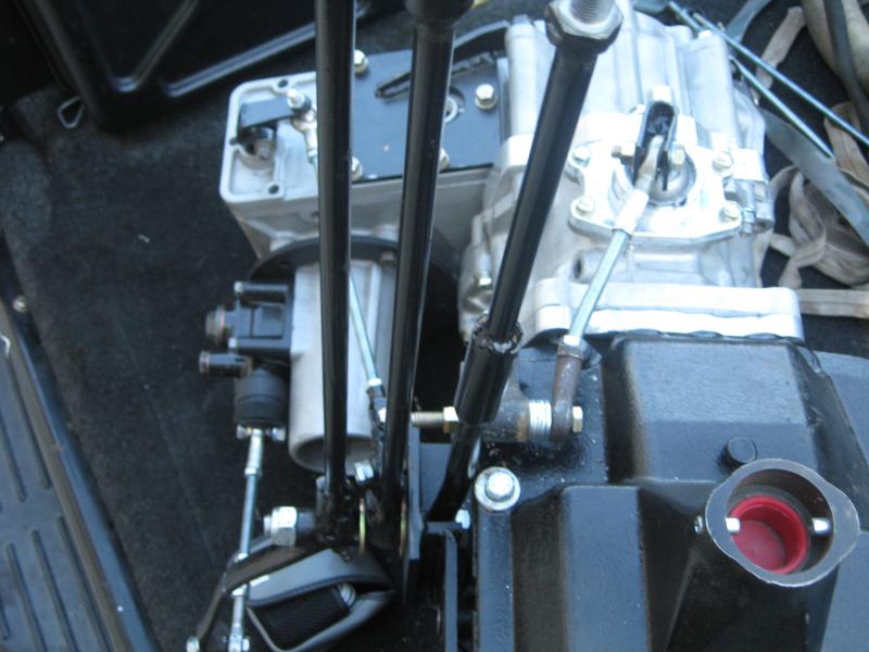

My first attempt at my t-case shifters. I needed to relocate the toybox shifter because it will be under my fuel tank.
The traditional twin stick works fine, but the toybox shifter is very hard. I am working on another idea that may work better. If not i'll just use this set up.
Has anyone had any luck setting up something similar?

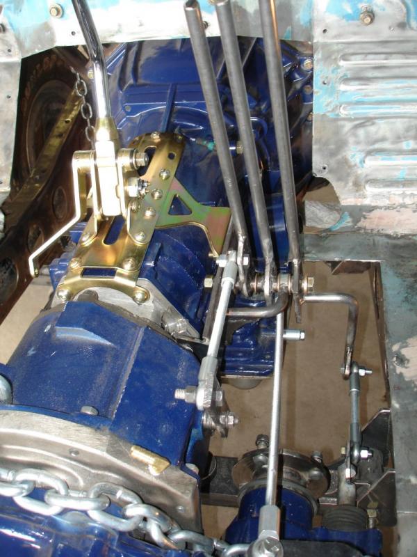

Mine is an NP203-19 spline...
Here are pics for reference. Its about the same as you did though.
I need to shorten the throws on the 203 and H-N-L on the 19 spline. Talked with Georg about this, and he said that I need to move the linkage closer to the pivot on the respective boxes.

Steve. Im sorry, I do not have any pics of how I attached to the selector shaft, and I did weld it to the shaft. Its actually just tacked on there right now untill I can pull the tub off again and get a good burn on it. I made a tab out of 1/4 in steel (follow me here) so I made PART of the tab so it will slot into the existing notch on the t case selector and the rest of the tab that I made protrudes off the END of the t case selector. I drilled a hole in the end part of the bracket and attached my heim to that.
Ill snap a pic when I can...Kind hard to describe, but when you see a pic, youll understand. So essentially the tab I made runs along the top part of the shaft on edge and sticks out off the front for the connection. I just cut the tab so it drops down into the keyed section on the shaft for more purchase.
Hope that makes sense.

I have been thinking of a removable mount instead of a permenant one. I plan to use a short piece of tube that will slip over the shaft. I will have a tab welded to the front of the tube for the linkage to bolt to. This will act as a stop for bottoming the tube on the shaft. Then I'll weld on a nut to the side of the tube and run a bolt in to clamp up the tube in the slot area. The bolt will be at the front end of the slot so it acts to keep the tube from sliding forward on the shaft.

Make the Toybox lever come out towards the passenger side of the gearbox and then drop down a few inches; (picture an 'L' shape on the shifter) you will get your leverage back and not get into the body.
Do not use thin material for the shifter control lever and you will not have to worry about deflection.
This would also get rid of those horrible angles you are trying to overcome using rod ends.
:meh:
The reason it is harder to shift is because you are using very little mechanical advantage . It would probably be better if you could just offset the shifter directly on the Toybox.
Offset Shifter Modification | Marlin Crawler, Inc.
Thanks for the input. I have seen the offset shifters and i am going to make one with a 4" offset to try. I will have to install it with the case lowered before i mount the crossmember but i think a 4" offset with a forward angle may work.
I also experimented with a linkage system that takes the angle out of the equation. It was basically a length of tubing across the back of the 465. The shift lever connected to a tab on the bottom of one end of the tube and the toybox shifter connected to a tab on the other end of the tube. Each tab was inline and by placing the rodends in the right place, it increasd the leverage needed. It worked well at first but became increasingly sloppy. I liked the idea but it willl need some work.
