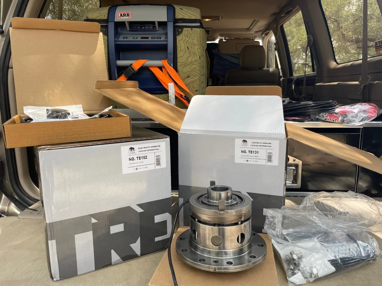

I am volunteering as tribute! I bought a set of e-lockers from TRE4x4. I believe they are chinese knock-off copies of other brands already out on the market but for $1460 for both front and rear lockers with the associated necessary install hardware I figured it is worth a shot.
I also have 4.88 gear front and rear sets on order from Revolution gear. Less than grand for front and rear with install kits. Unfortunately the rear gear set is on backorder so no ETA when they will show up. I would love to have everything here and installed before COTR II.

Lockers are in. The rear 9.5 locker is great. I dont think I would use the 8 inch clamshell locker again. It was very difficult to setup but I did eventually get it to spec out. What I don't like is that I had to use multiple shims on one side instead of just 1 or 2.
I also had to modify the wiring harnesses. They do not have any kind of relay protection. I wired them basically like the Eaton brand locker is wired.
Also the Nitro Gear solid spacers were a real PITA to get right.
@JOSHD as a conclusion do you recommend having tre lockers as a better value alternative to well known brands ?
I wouldn't say they are a better alternative. They are a cheaper alternative but do work and perform just like the more expensive Harrop Eaton lockers.
