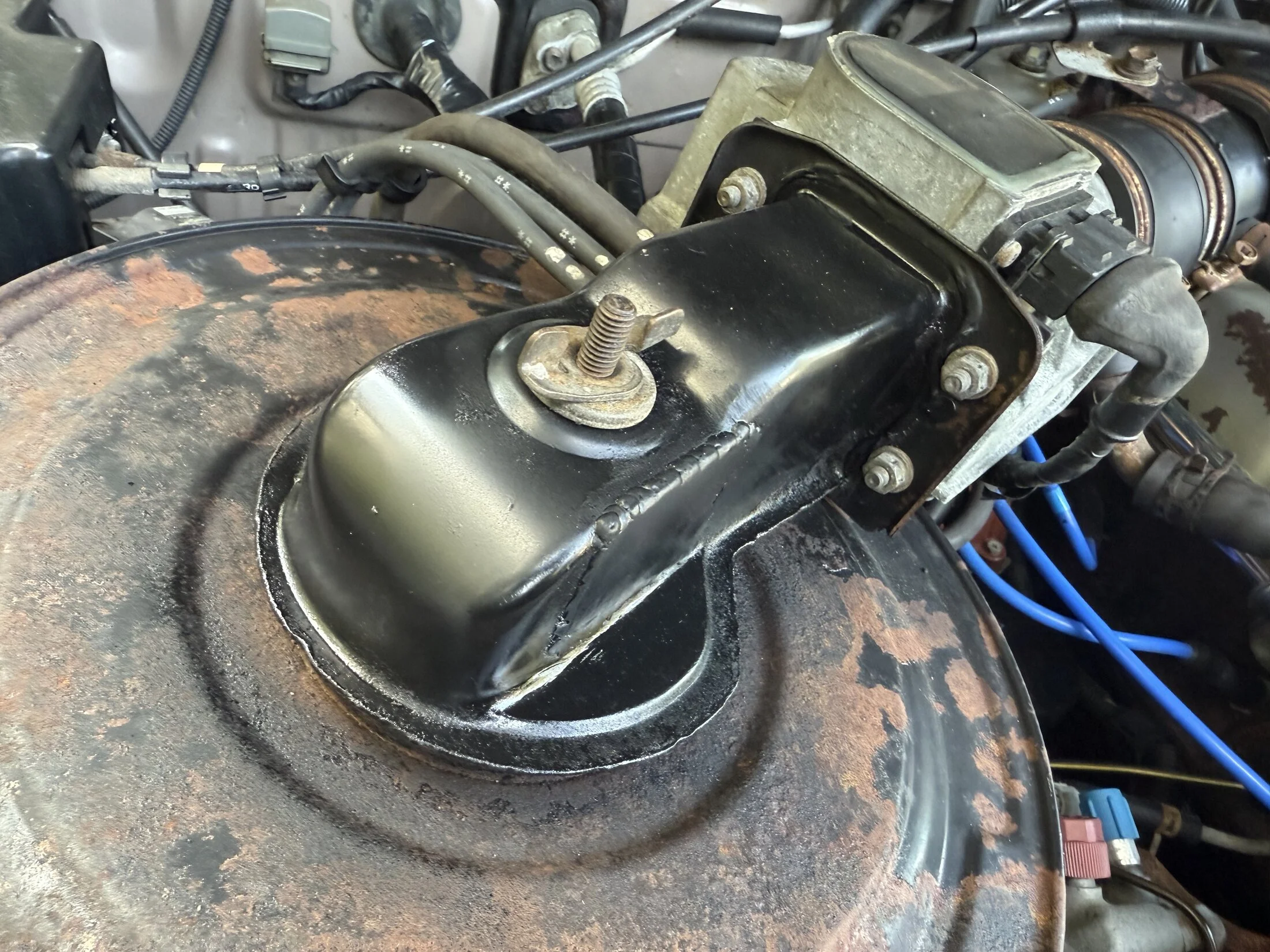

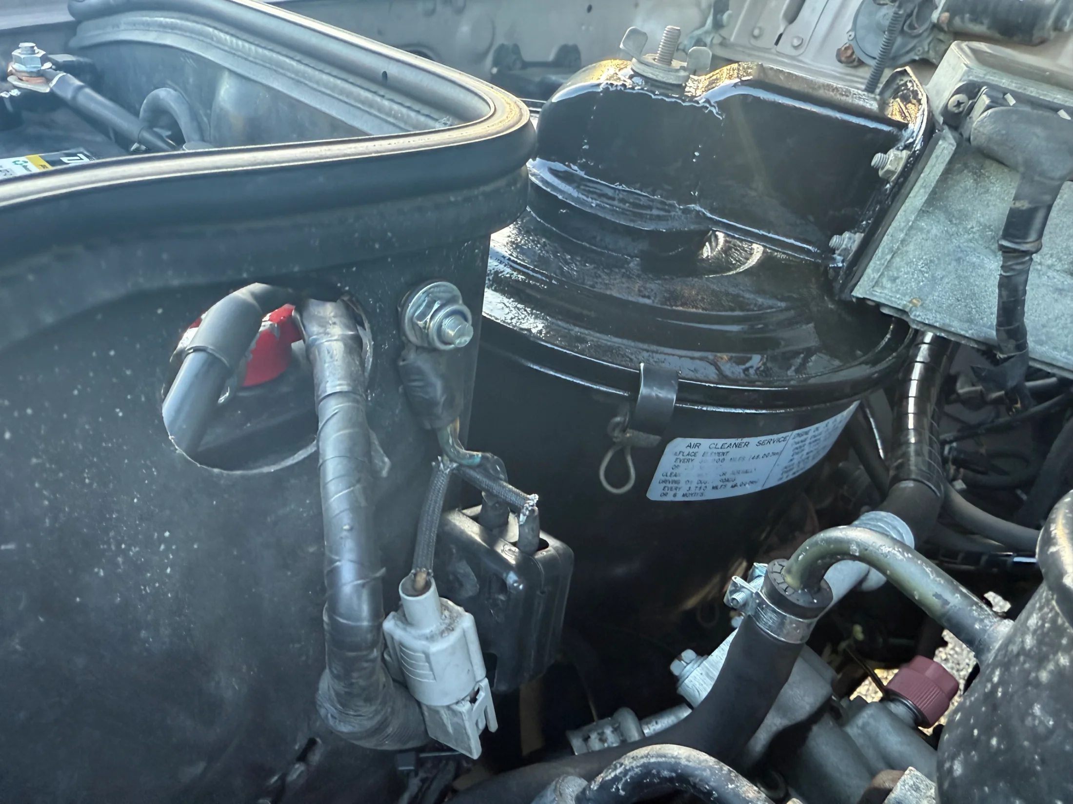

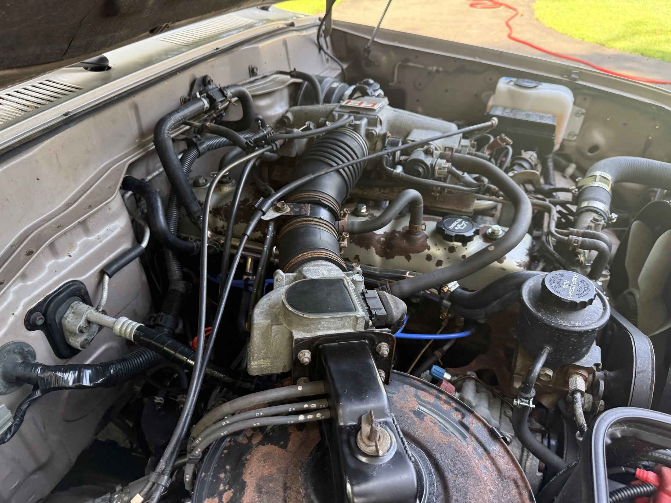

Finished up replacing all the coolant hoses, cleaned the throttle body and got her all buttoned up and filled with coolant. Also modded the air filter cap to get rid of the air pump connection. Finished by removing the rear heater and making a sandwich style block off plate similar to the one wits end used to sell
Long live the mighty 3FE

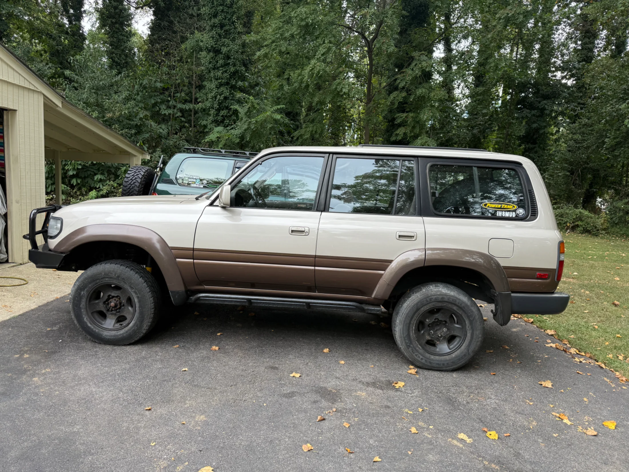

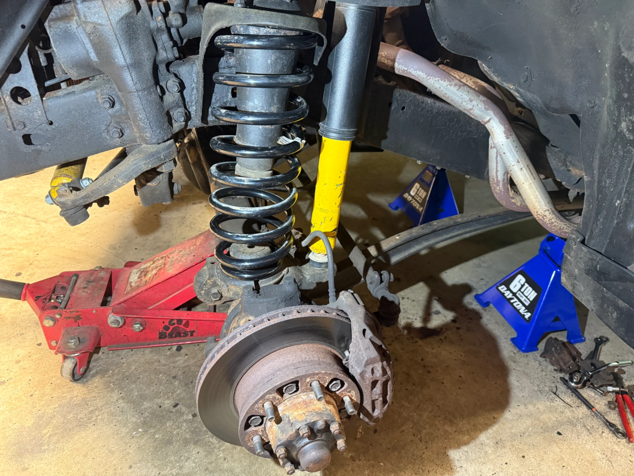

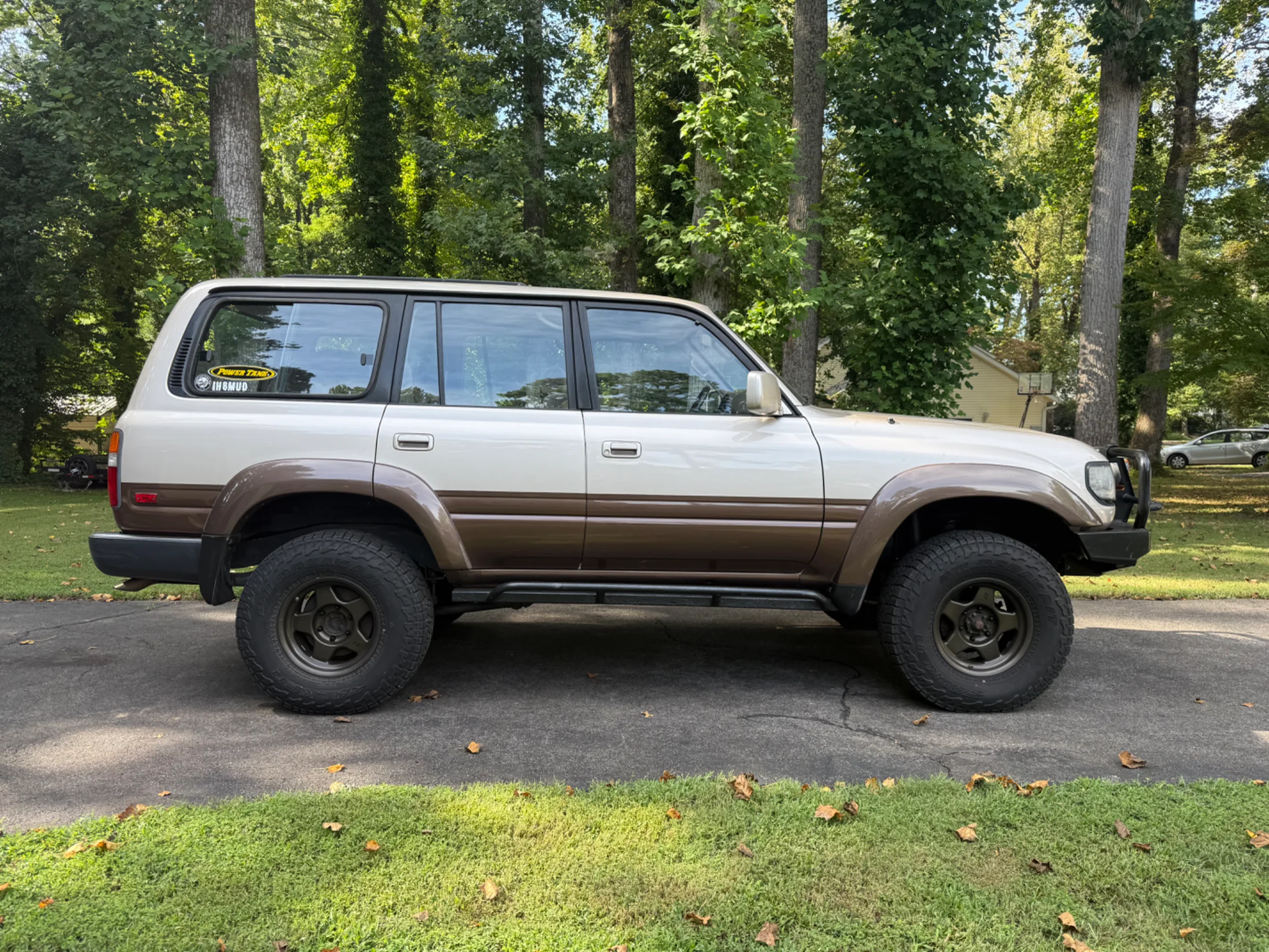

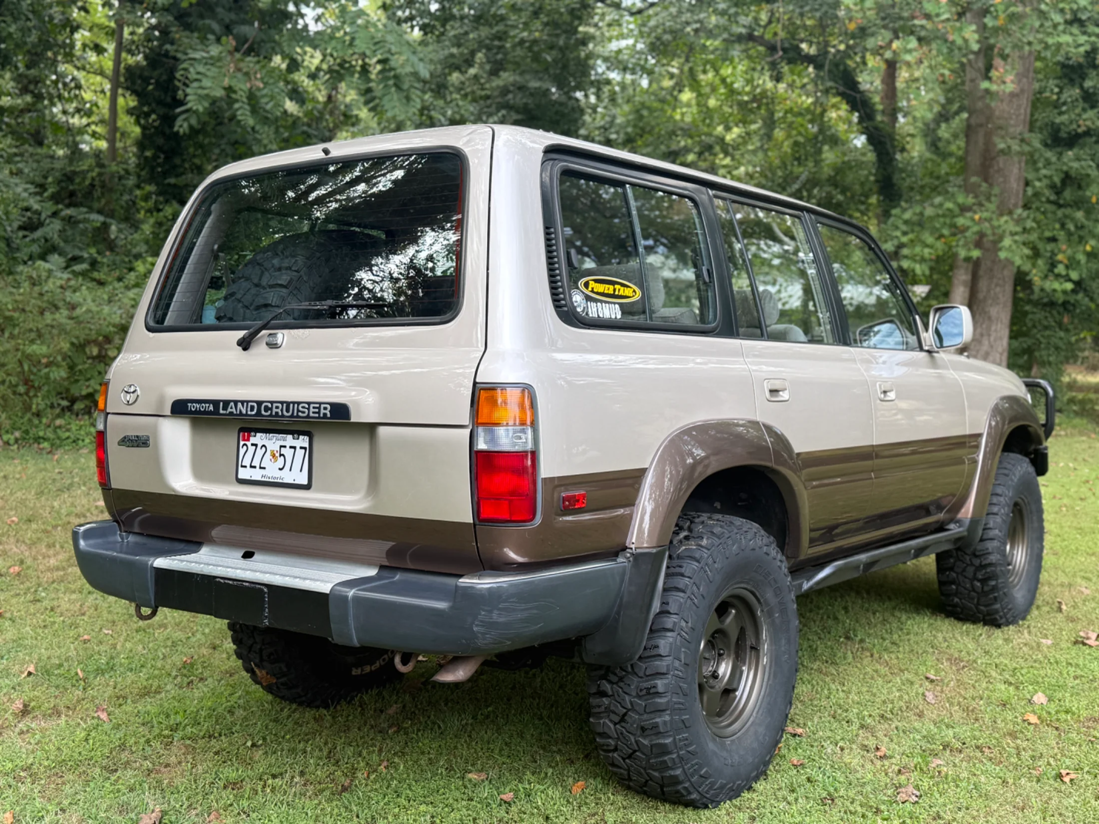

Started and sort of finished the install for the OME J lift I got from a club member. Got the fronts in, trimmed some rusty backplates, removed the front sway bar and extended the front diff breather. Pulled the truck out to flip it around to do the rear and now it's sitting perfectly level so I'm leaving it. I have almost no weight in the back so this set up makes sense.
It's now ome J's in the front with 860's out back. J shocks all around. Drives great, if I ever add a back bumper (cough cough @CrabCake ) I can swap in the rear J's.😎
Time to get the 35's mounted and then that will give me the motivation I need to get the new axle housings installed

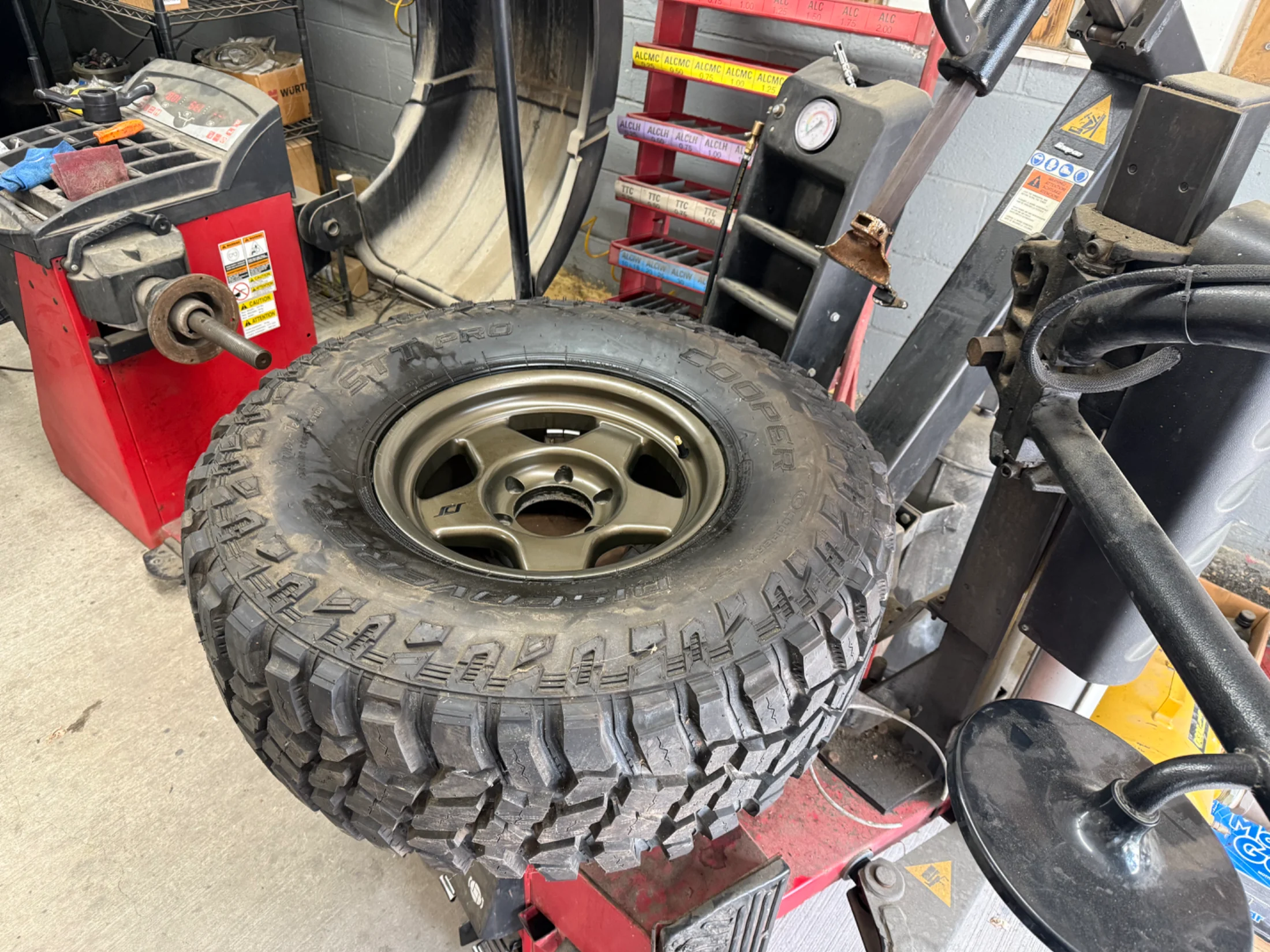

got all the 35 stt pro's dismounted off my spare 100 series wheels and one swapped on to waffles spare. I'll take the other 4 into work on Tuesday and finishing up the mounting but that's enough for one day
Until then we have officially skipped leg day

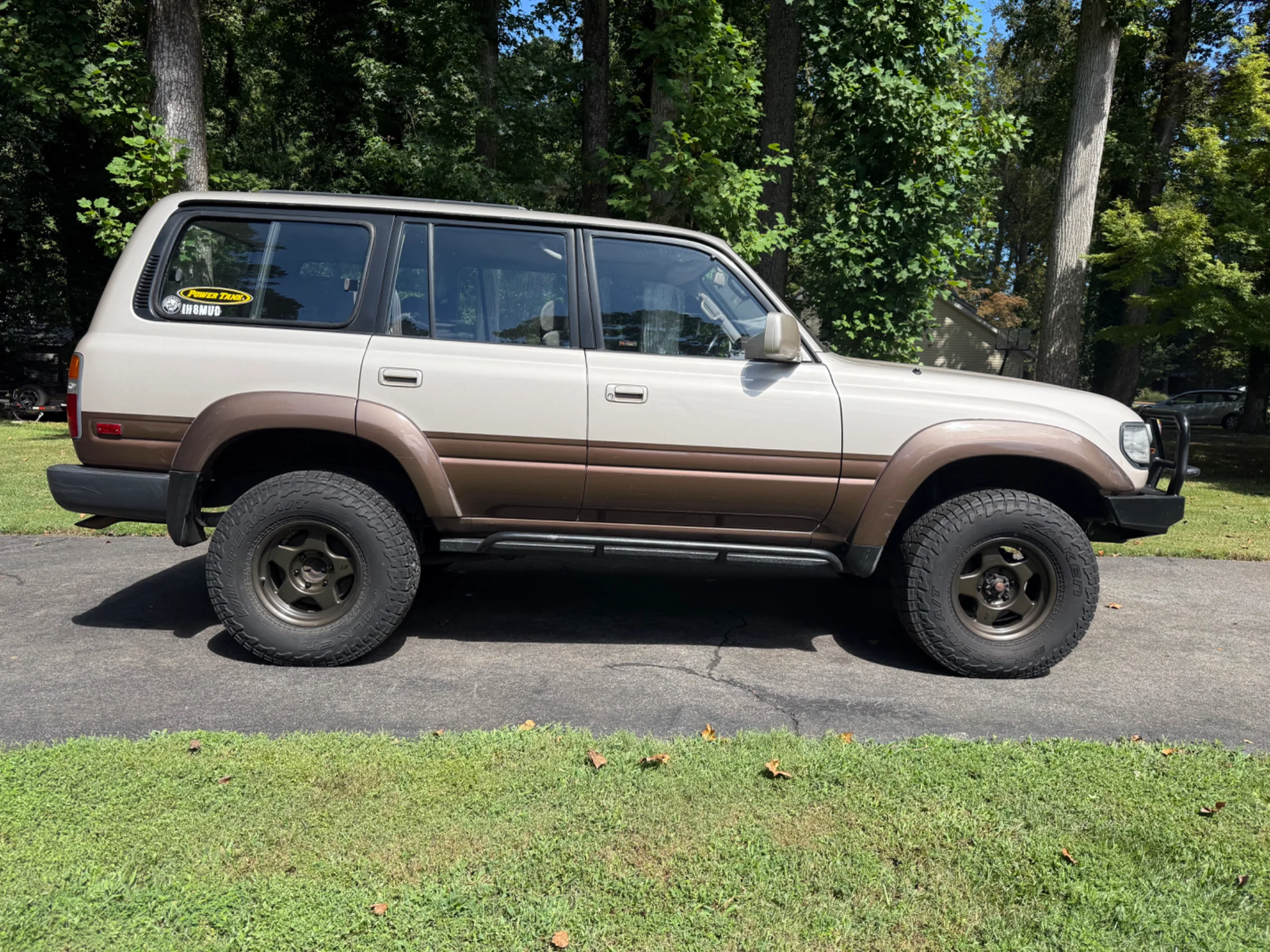

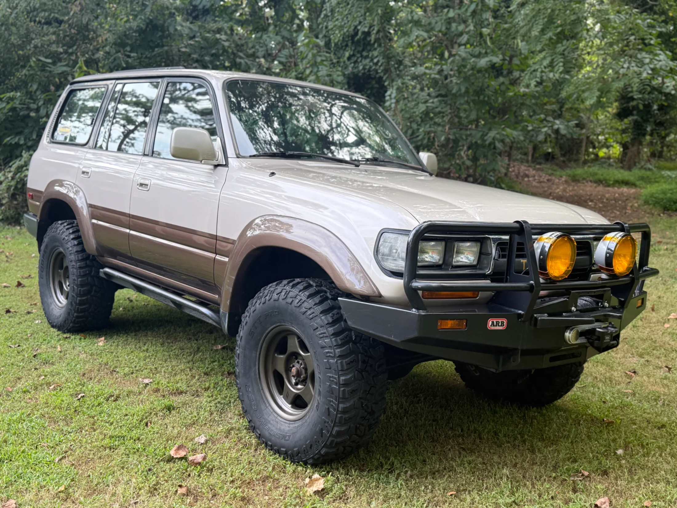

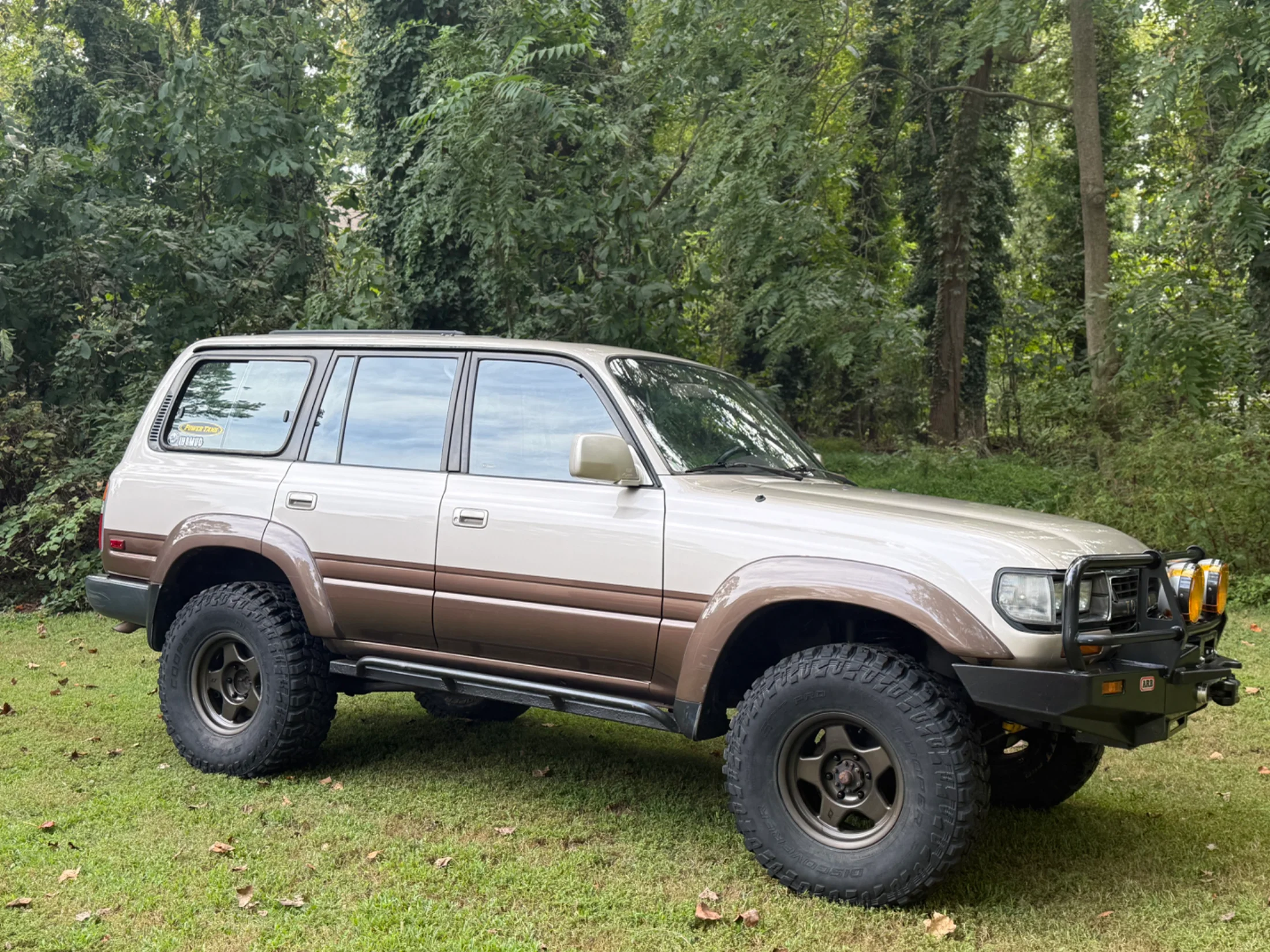

Only regret is not doing 35's sooner, looking like a proper 80 now. Gave it a bath and interior clean. Hope everyone had a great weekend
Looking great! I promise, that rear bumper is coming soon! 🦀

First was getting the Slee caster correction plates on. After the front J springs this was a necessary modification. It was very "twitchy" at highway speeds. As I was installing I also swapped out the complete radius arms for a low mileage set off a friends LX450. Drives like a dream now

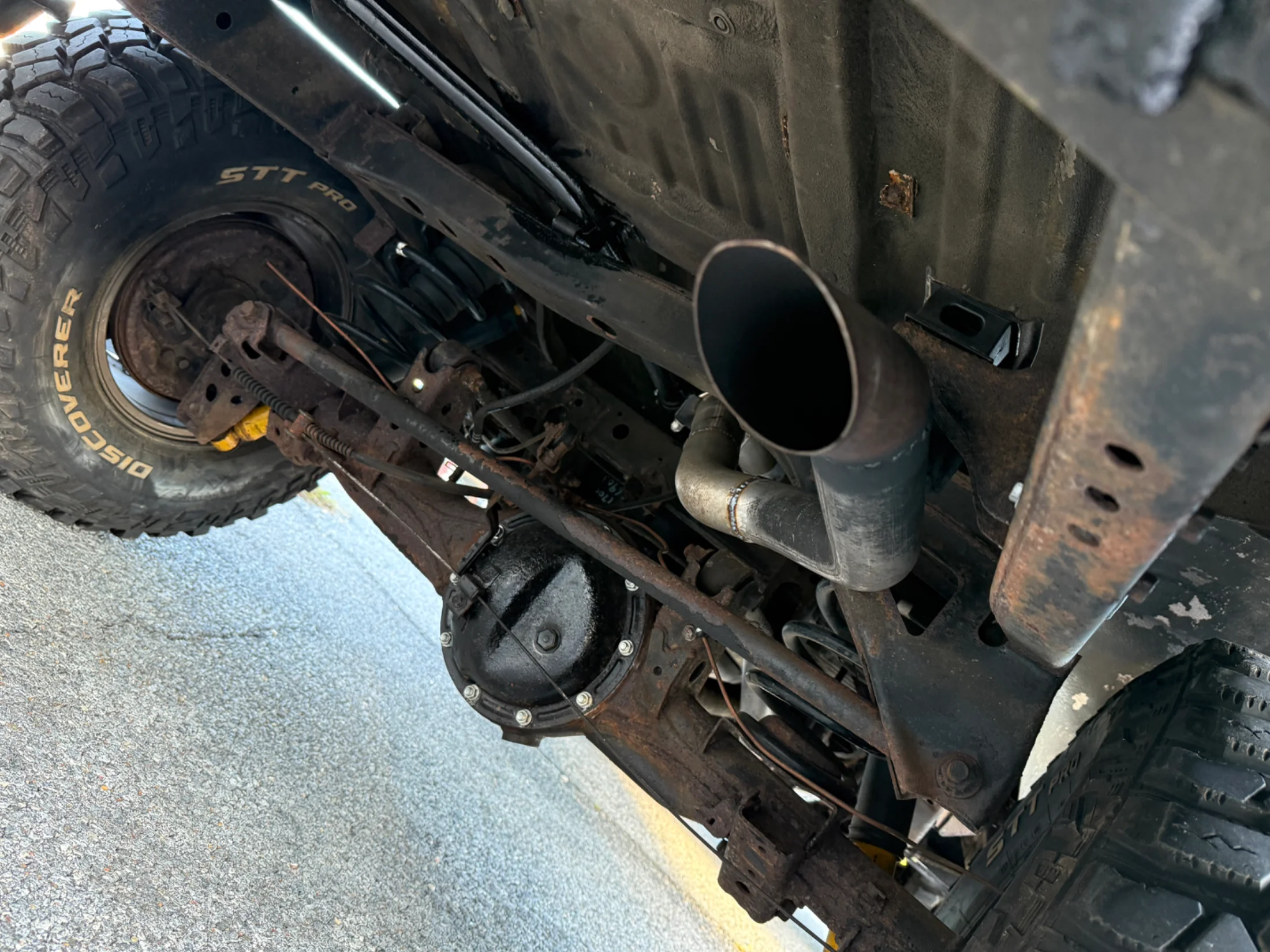

Next up I did a few flex test at work. Upon the first flex one of the rear sway bar end link left the chat so I decided just to remove the sway bar until after the event. Due to a very leaky passenger birf I'm just going to trailer the truck to the event but I was surprised on how well mannered the truck is with 0 sway bars but I fully understand the dangers of this. I will get some new bushings and links before reinstalling it. Also noticed that under flex the passenger rear tire was contacting the exhaust I made. I ended up redoing the axle back section making it run inboard of the frame rail. moved the factory exhaust hanger too, retaining the OEM style rubber hanger

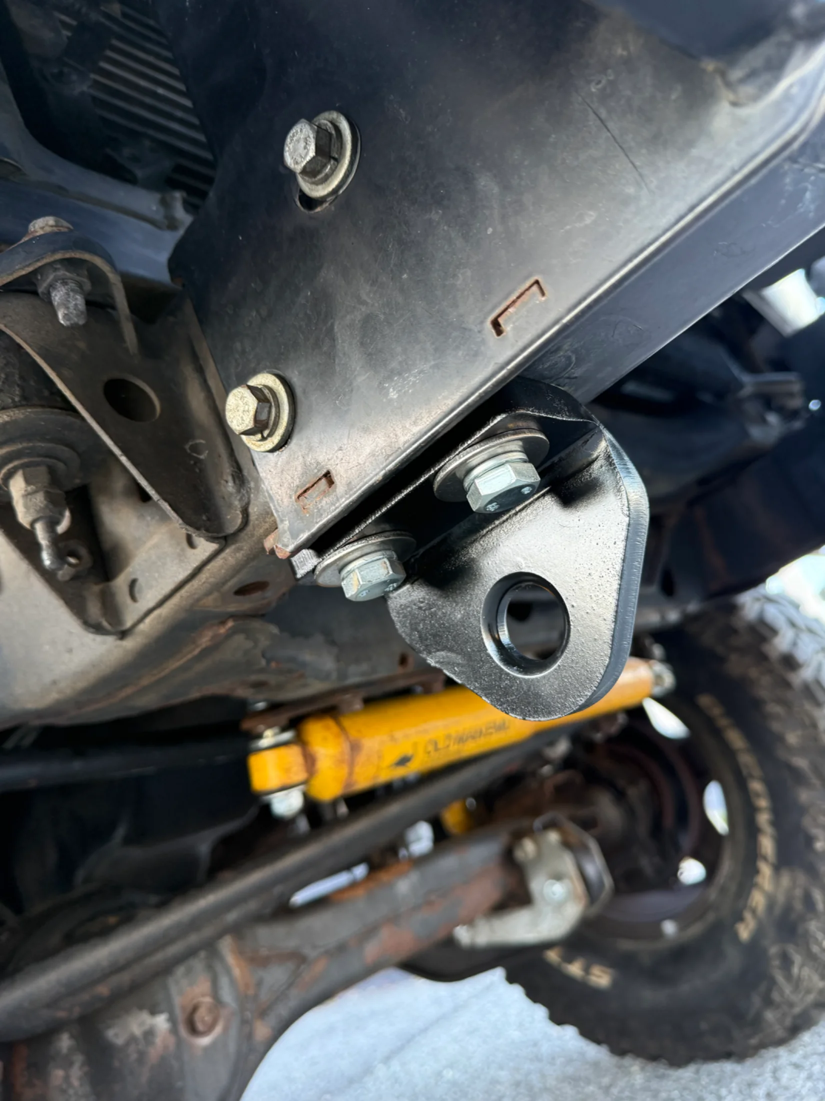

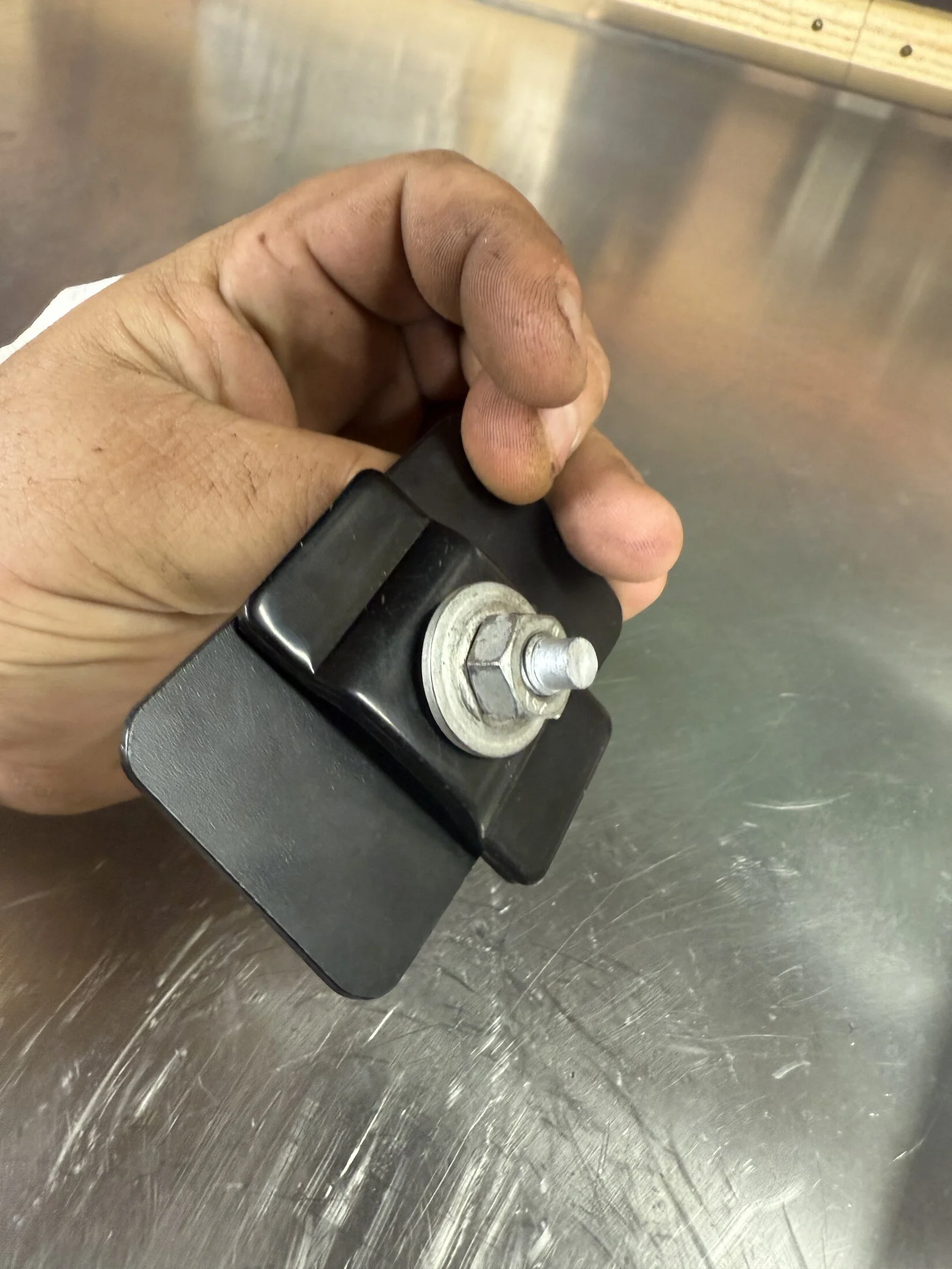

Had some of Jason's (Trail Taylor) rated recovery points that I acquired from @NearJetties got them painted and installed

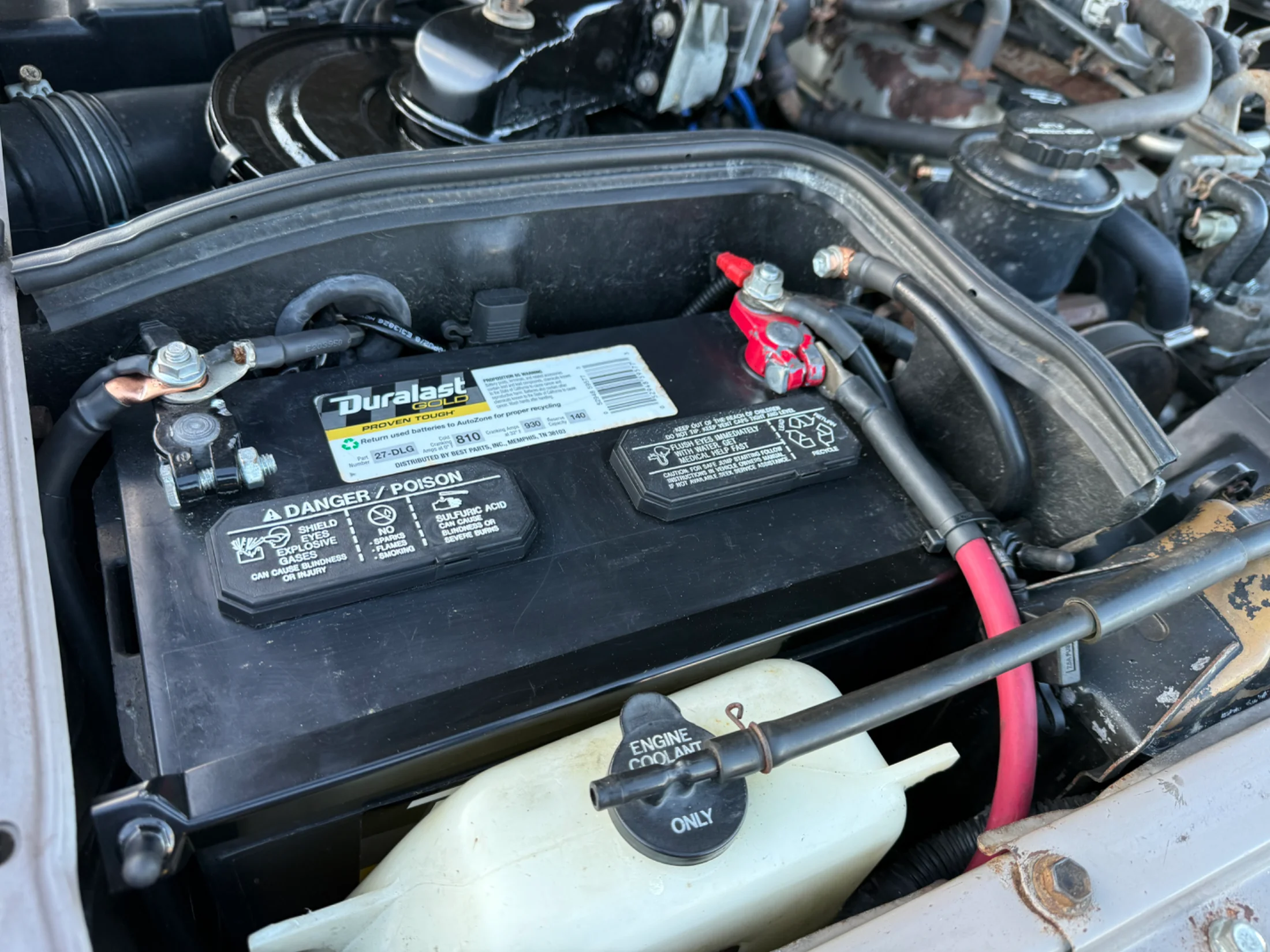

Truck hasn't had a battery hold down since I had acquired it so got that sorted and while I was there cleaned up and changed the positive terminal and cleaned up some wiring. Made my version of @LandCruiserPhil anti-stress fusible link mount. I think this is a great idea to not have to move the link while changing the battery and you should check out his kit. I also like his battery hold down kit but im limited on time and the stock on is better than not having one lol. I'm gonna pick up a new fusible link, mine looks tired lol but its still working, I'll toss it in the glove box as a spare.

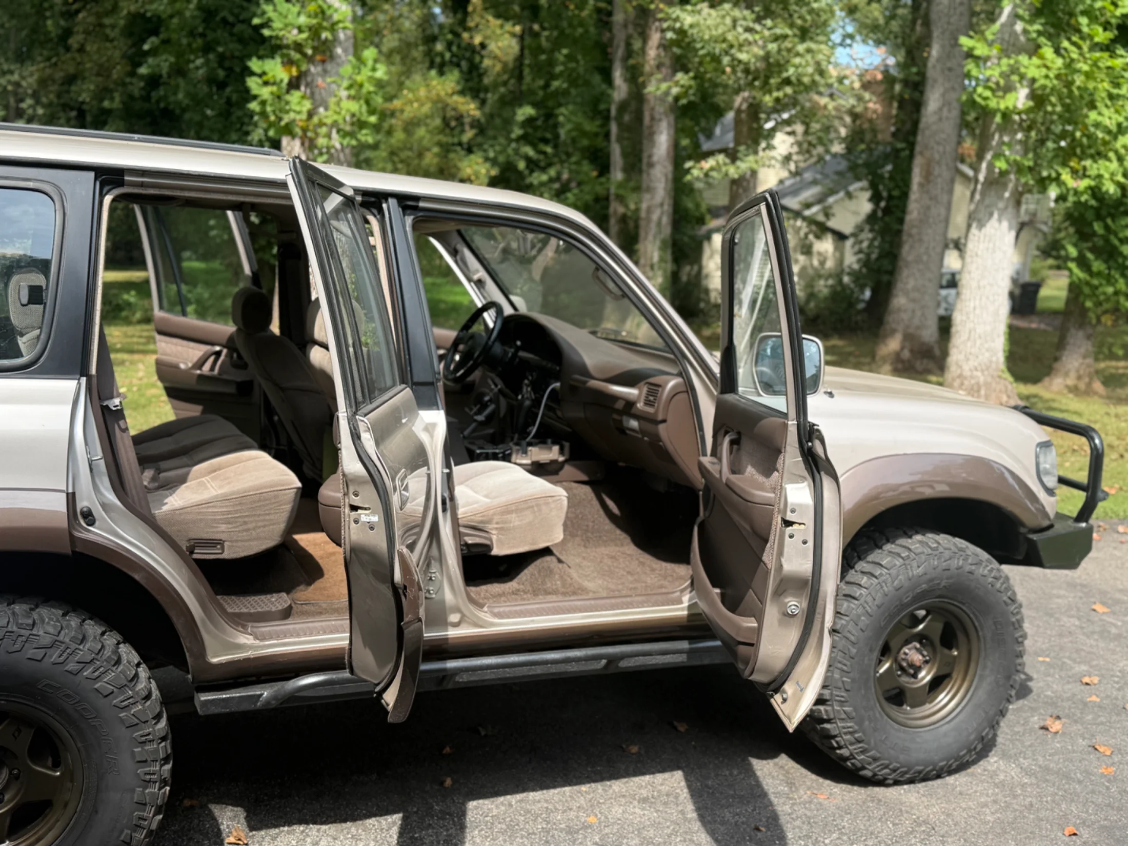

Working on the last quarter flare. I saved the best for last lol I knew this was gonna be the worst one. The front bolt snapped off in the bracket so I drilled it out and installed a rivnut. The flare itself had some previous damage. The rear tab for the mud guard has been snapped off since I purchased the truck and the mud guard was held on with a zip tie. I had saved the quarter flares off the part out truck from earlier in this thread
Today I'm working on repairing some chips in those and we are gonna see what we can do about "color matching" the faded flares
I knew there was some rust on the lower quarters and was able to get a good look at it. Picture is of the passenger side, the driver is a bit worse but not hateful at all that will most likely be the next project I tackle.
Paint work came out good, we had to play with the color quite a bit just due to the fade but I'm happy with it
And so it begins
Got all the rust removed an started making patches.
back at it, took a break from the quarters the other night and pulled the passenger quarter window. I could see the faintest hint of rust between the window seal and molding so I decided to investigate and as I thought there was some corrosion but not bad at all
Got the driver side rust all patched up, seam sealed and painted. Pretty happy with the results. I'm ok with the "cut out" look, ultimately once a bumper is back on you won't notice much of it anyway. Made sure to give all the inner quarter crevices a healthy dose of cavity wax before putting the interior back in.
Good for another 20 years, now to mimic the passenger side
