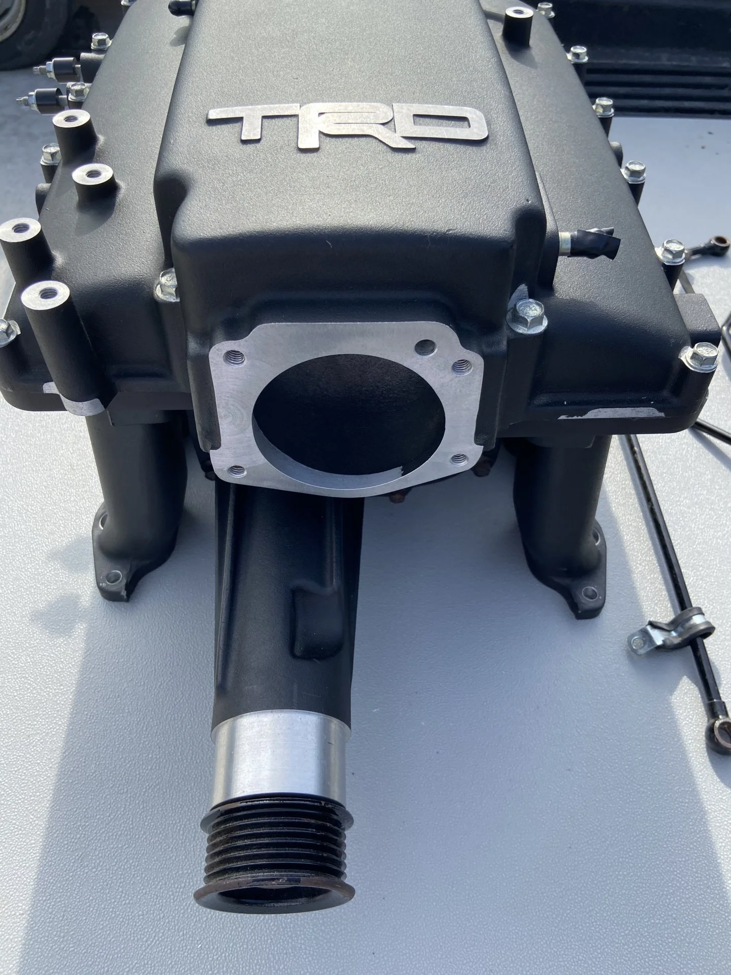

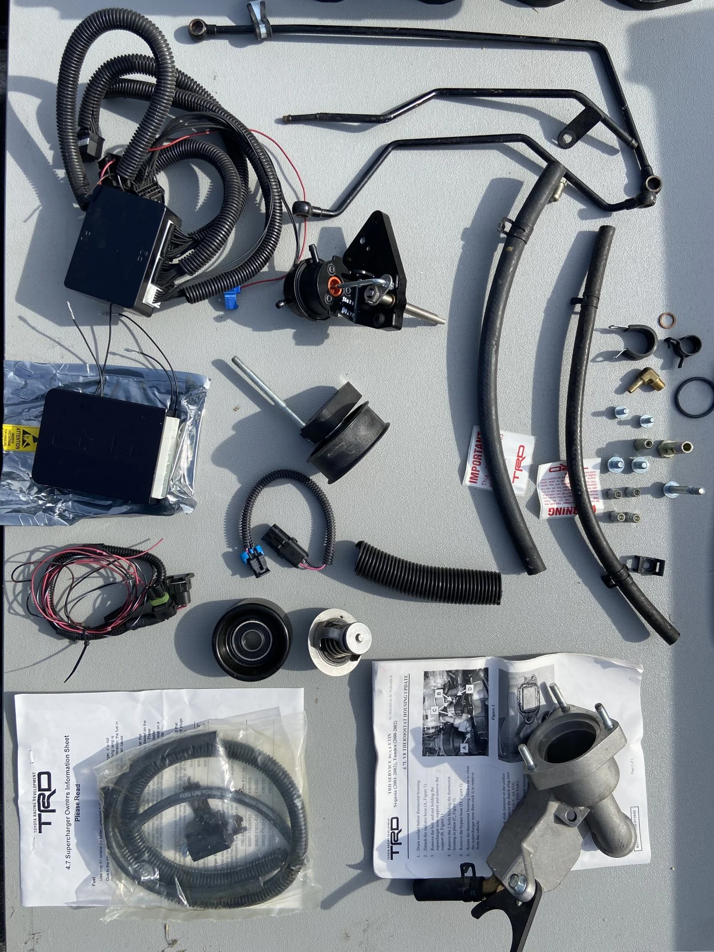

Good evening all - Well! Today went ahead pulled the trigger and bought me a TRD Supercharger for my LX and I am hoping someone can help me and let me know what Parts I am missing. I know is kinda too late now.
Here are some of the pictures that I just took and I am pretty sure I’m missing something.
That looks pretty complete. I didn’t see the triangular pulley bracket at first but I think it’s next to the pulley right in the middle of the first picture. That pulley had ridges on the side to hold the belt in place on the pulley. I was having issues with the belt being so tight it would slide off center of the other pulley that’s smooth. I ended up getting a second pulley with the raised edges and then it held the belt in place. Maybe something wasn’t 100% lined up perfect but I tried multiple pulleys and spacing and this is finally what worked for me. There’s also some spacer/sleeves that fit into the pulley to shim it to the bolt size and space it properly for the belt.
Thanks for your response. How you like your Supercharger. Can you tell the difference? Also, Would you happen to have Parts for all the Pulley and Supercharger Belt? The ECU’s just plug and play?
