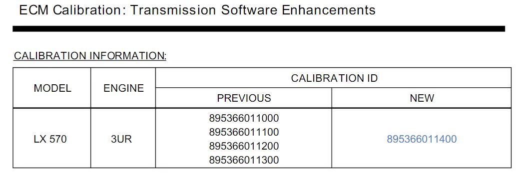

Update: The dealership did the software upgrade and wow, what a difference. Completely solved my issue which the TSB describes as "Shift shock 1st to 2nd gear when the water temperature is below 60°C (140°F)." In my case I wouldn't have called it shift shock as much as a hesitation between the 1-2 shift and 2-3 shift, and only when the engine is cold (as the TSB states)
However the extra benefit of the update is that the vehicle drives MUCH better now across all RPMs and gears. Before the update I was really missing my old 6sp in my 08, but I am much happier now. It has only been 1 day so maybe I am jumping the gun, but for sure there is a very noticeable improvement.
For everyone's reference I was expecting to get software version: 895366011400 as stated in the TSB however they upgraded to 895366011500.
Here is what the TSB says:
Here is my Programming Report:
Looks like I went from the '300' calibration to the '500' calibration. Also notice the issue date of 5/9/2018. So if anyone has the update prior to this date you will likely have the '400' calibration and might want to consider the the '500' update. I have no idea what went into the '500' update so YMMV
