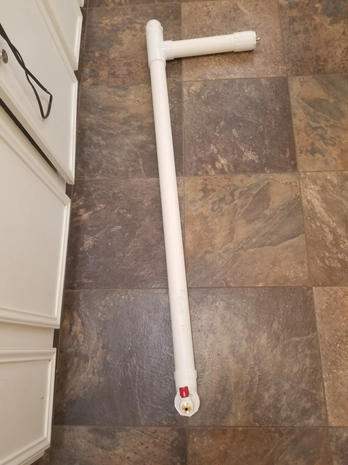

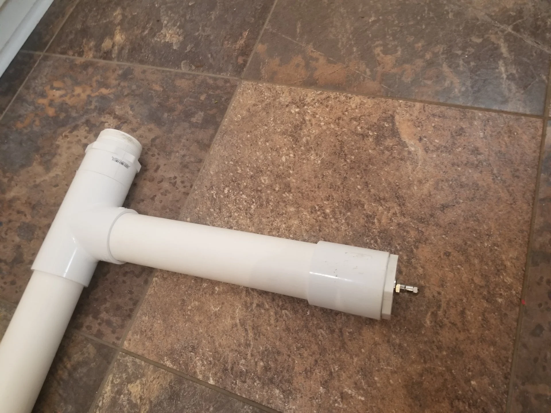

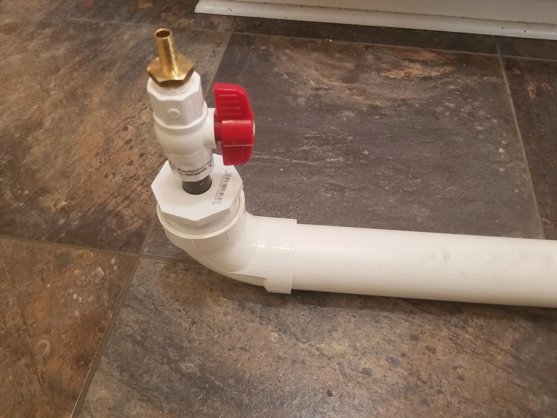

As long as we're discussing fluids, I made a compressed air fluid injector for my upcoming diff and TC fluid change. It uses 5' of 2" PVC, a metal valvestem, a simple ball valve that leads to a barbed fitting (for a 3/8" plastic hose that leads to the diff), and a threaded cap to hold air pressure (not pictured). I'll bungee cord it to my floor jack handle to keep it upright when in use. It holds around 2.5-3 quarts of fluid.
I tried it last night with water and 30 psi of air pressure and it shot the water 20 feet into my yard within 3-4 seconds! Should be much quicker than trying to hand-squeeze diff fluid under the GX.
It would have also made my transmission fluid exchange/flush MUCH quicker as it took like 5-10 minutes for 2 quarts to drain into the return line by gravity. I would have made this out of 4" PVC to keep it shorter, but prices are bonkers right now....even using 2" PVC, it cost me $55 in pieces from Lowes.
The $8 harbor freight hand pump works good too.
