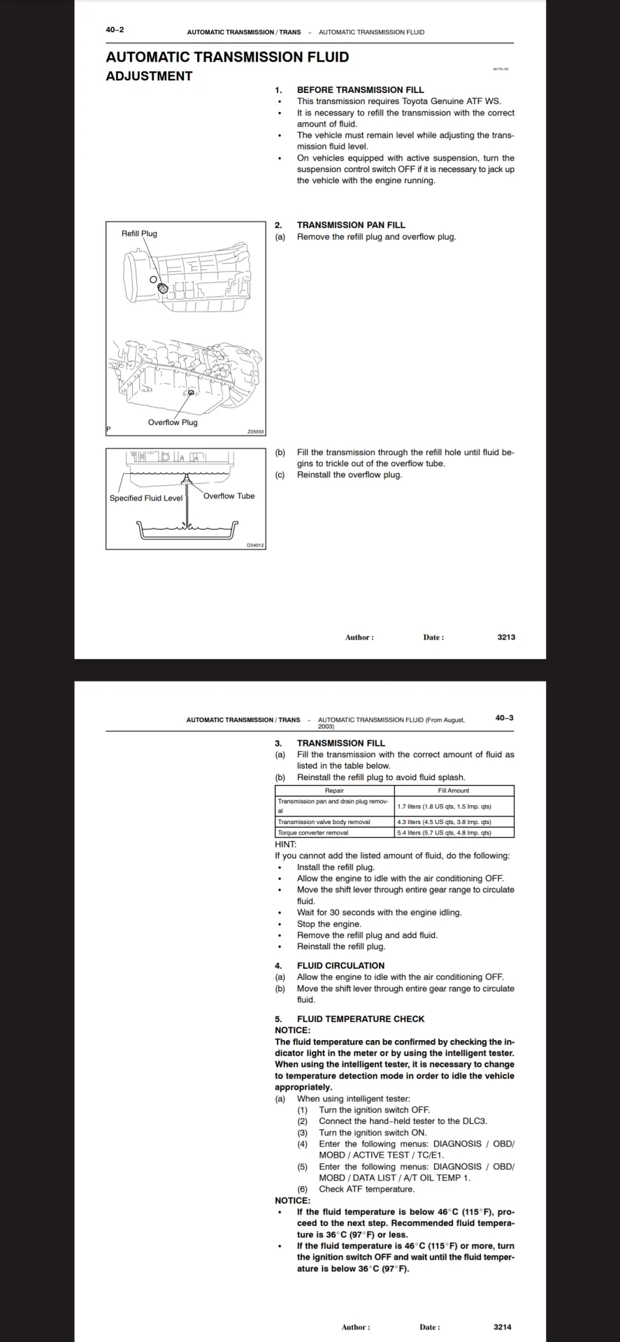

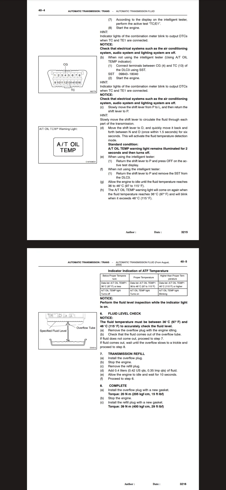

For reference, I attached the relevant pages of the FSM. I always forget about the jumper/blinking light method for checking the temp!
You can do this with normal tools and no techstream or anything electronic.
