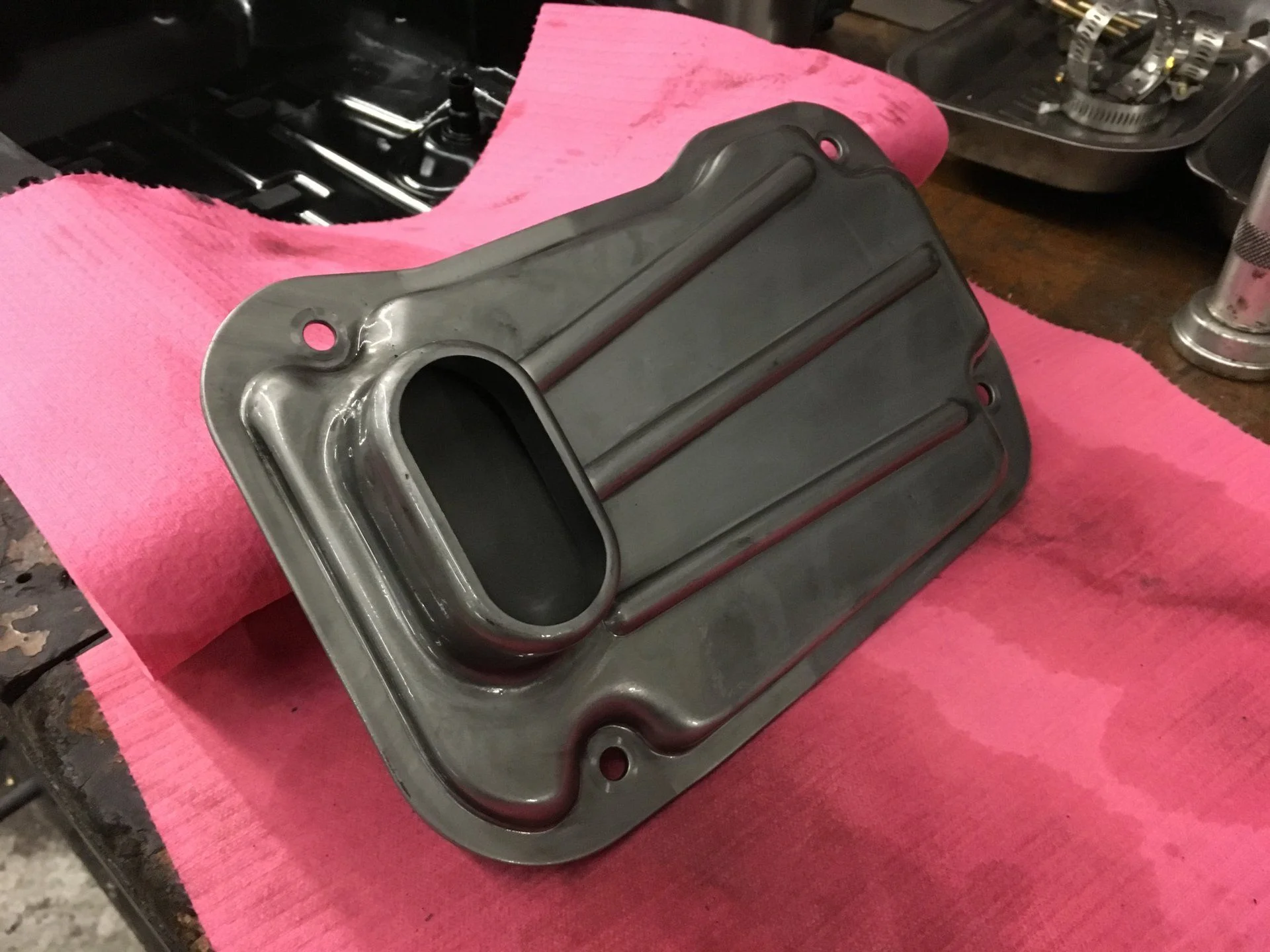

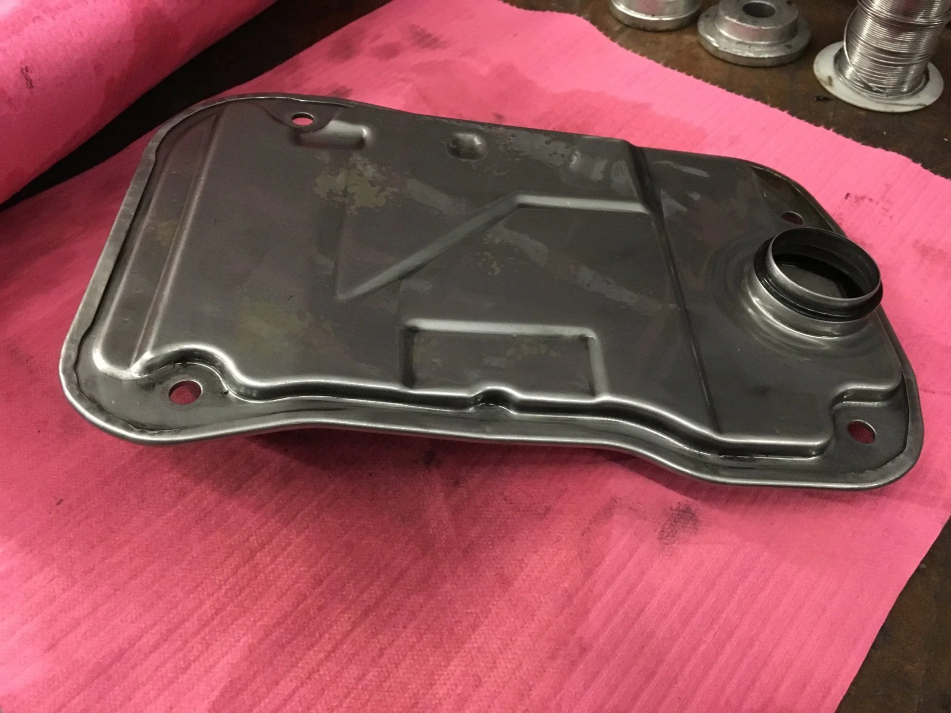

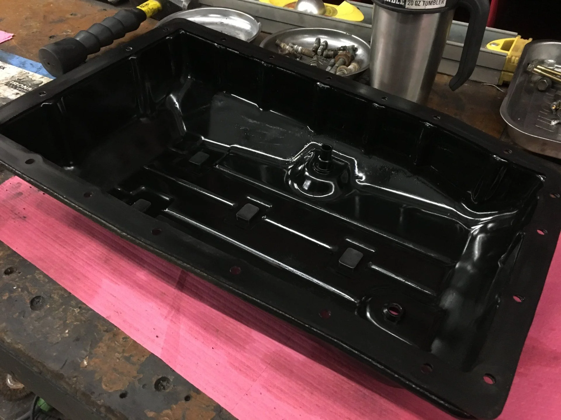

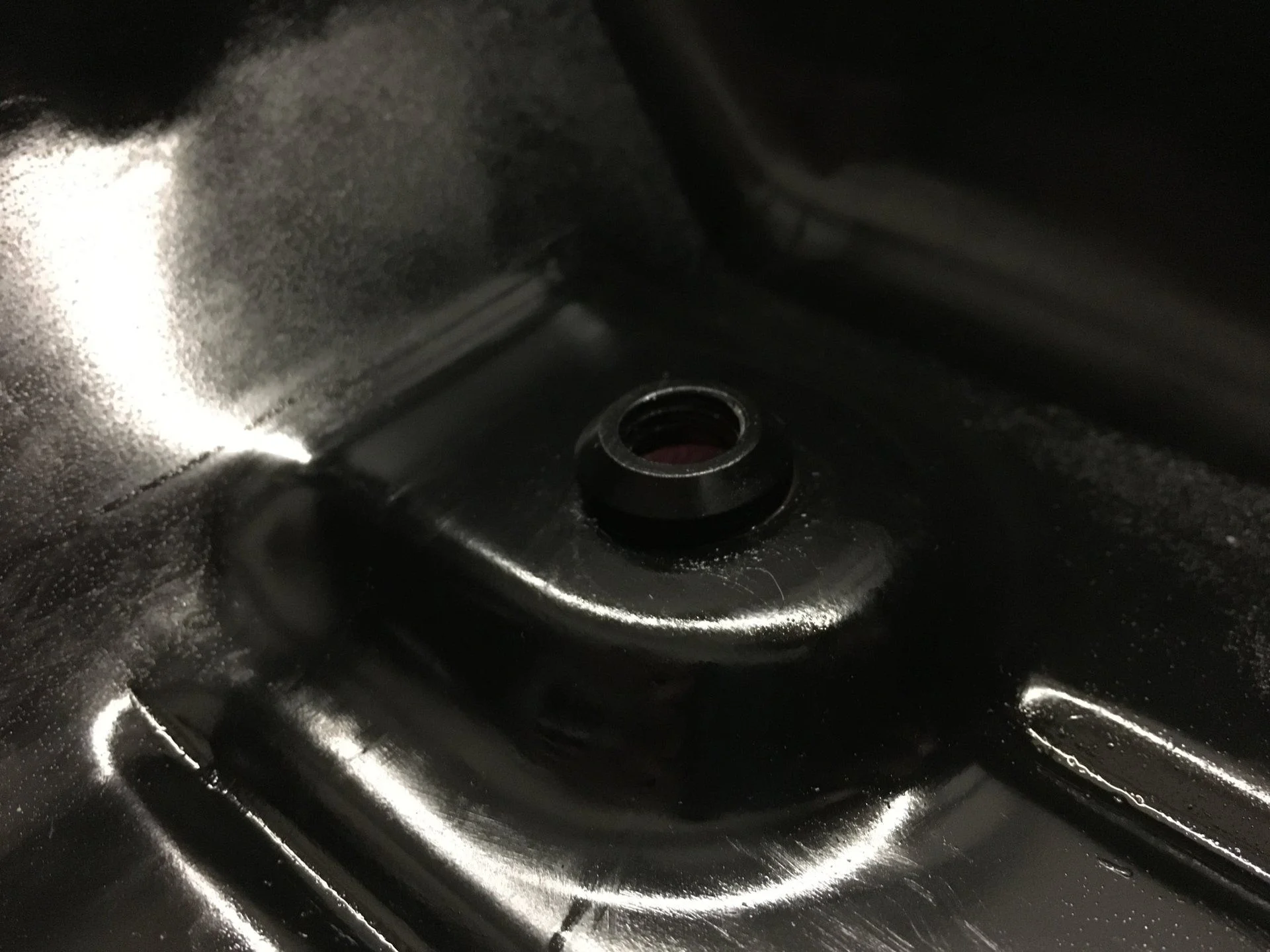

Cleaned up the pan and screen before putting it back together and it looked remarkably pristine upon initial examination. The residue was a carbon black but very very fine and just a small amount of film stuck to the magnets. An even finer "patina" on the metal screen filter assembly but it wiped right off.
