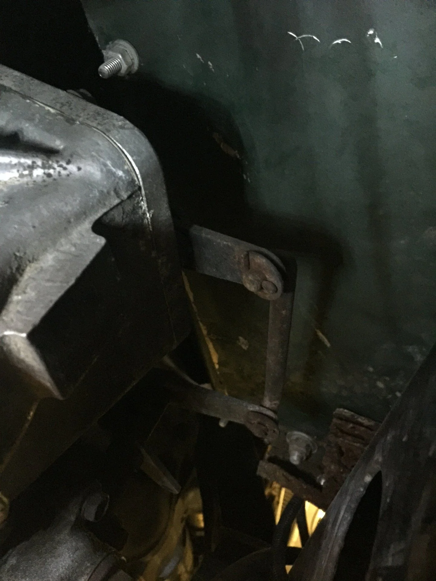

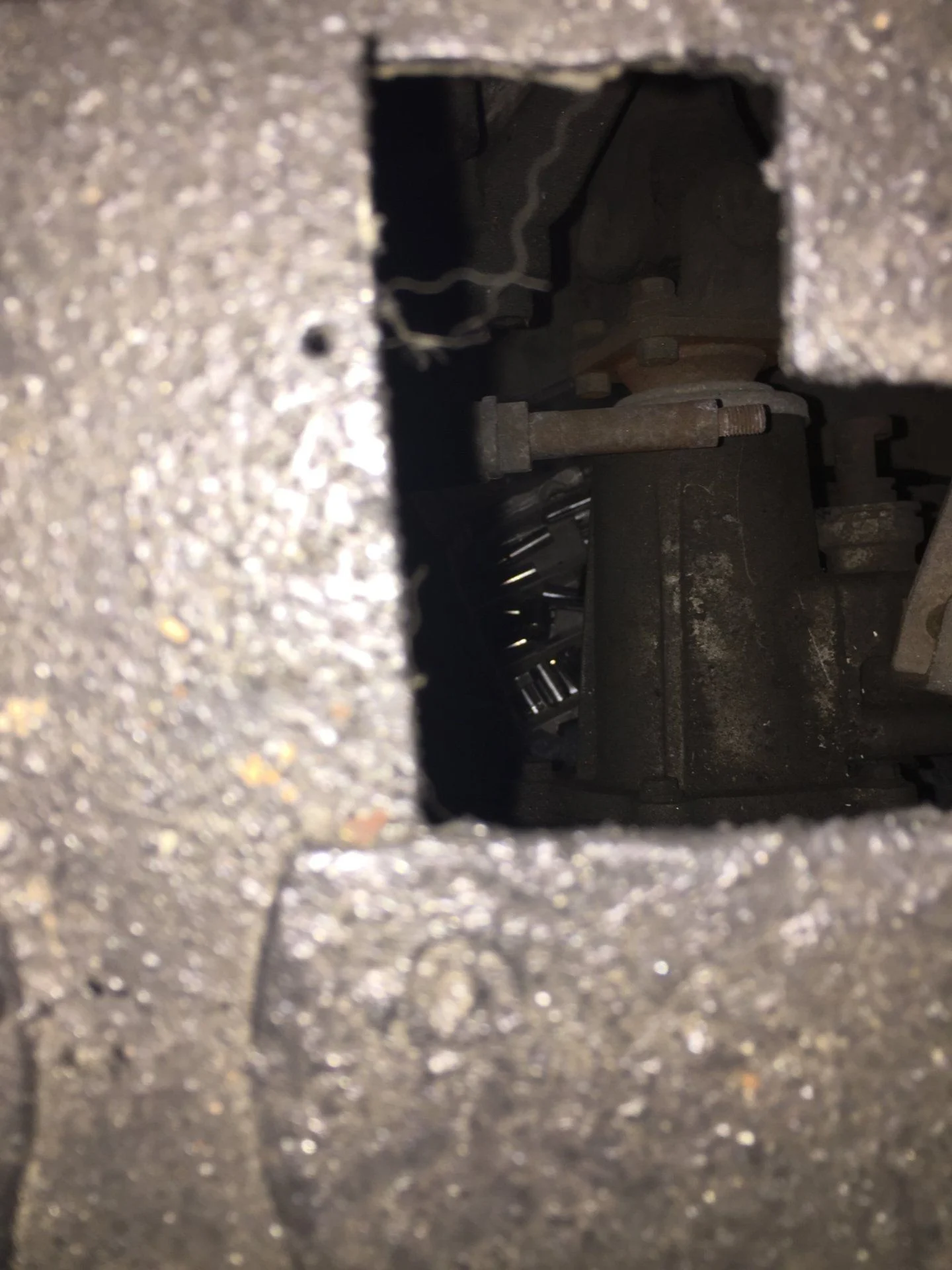

I have a 71 (3spd/350) fj40, with a missing transfer case shifter. Can any of you awesome folkes help a novice identify what additional parts I may need. Thank you, sorry for the awful pics.

First, I'd need to know if you have the 1" thick Downey adapter, or the 5" thick Advance Adapter between your tranny and transfer-case. Next, your 1st photo above shows that you already have the shifting chamber, your 2nd photo shows that you already have the pivot bolt for the shifter, your 3rd photo shows that you already have some of the low range linkage, sooooo how much are you missing ???. Next, if you were able to use the Advance Adapters 4WD shifter mounting bracket #715521 on the side of an Advance Adapter (if that's what you have), you could always heat/bend/weld the shifter lever to a more forward position in the tranny tunnel to avoid hitting the front seat or gas tank.
