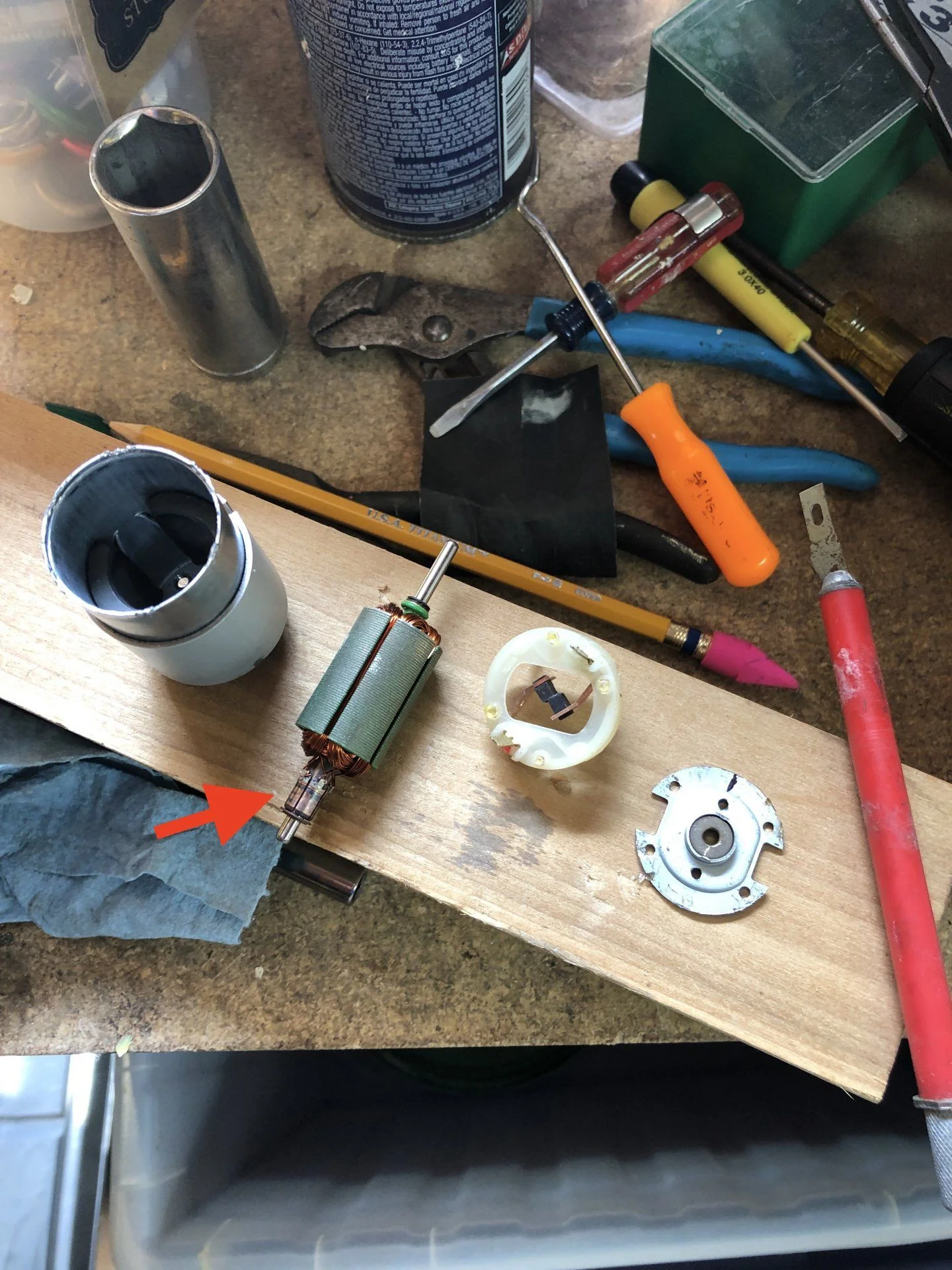

  1. Using a very small flat head screwdriver and a very small channel lock pliers, I peeled the tabs back that hold the metal end plate. DO NOT cut of the small plastic tips sticking through the end plate. I did, that was not necessary and a pain to get back in place.
  2. Using two small flat screwdrivers, I carefully leveraged the gear off the shaft. It's a friction fit only.
  3. Gently tapping the gear side shaft on the workbench, the end plate eventually came out of the housing.
  4. Here is where the failure was made obvious. The Pick Up (part where the brushes make contact) had one section completely brown with surface corrosion / patina. I guess this where some water intrusion sat long enough to cause it. I also speculate that because I did not cycle the 4x4 for a couple of years, this static position of the motor was allowed to corrode....this is a WAG.
  5. Using a fresh pink eraser and a can of contact cleaner, I carefully removed the Pick Up corrosion and clean the entire rotor until it's shiny.
  6. I also took some 400 grit sand paper and went over the rotor metal, carefully. Forgot to mention, I inspected the winding wires connection points for failure, too.

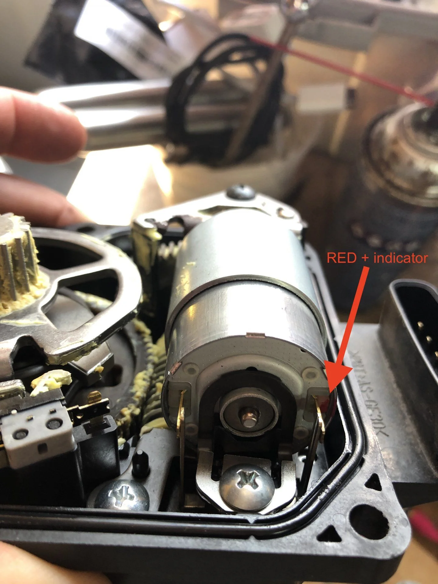

  8. NOTE, very important, be sure that the RED (+) plastic mark near the outside contact is at the 3 O Clock position to the motor housing. I failed to mark the body and end plate orientation and had to break the epoxy and re-assembly it...so don't do that.
  9. Using a pair of bent-nose needle nose pliers, I opened the brushes up and placed the rear shaft back into the rear plate bearing.
  10. Holding both the Rotor and the End Plate together, carefully feed the assembly back into the housing. The magnets will grab the assembly quickly and pull it into position, so move fast.
  11. Check the end plate and body orientation.
  12. Using a socket on the gear shaft side to hold the body up, I used a smaller socket to gently and evenly press the end plate into position. Working incrementally, I check the free rotation of the shaft regularly. If it was binding, I'd tap the gear shaft on the table slightly, freeing it up, and resume assembly.
  13. As you would guess, end plate bearing alignment is the critical part of the assembly.
  14. Once the end plate appears seated in the body properly, and you've rotated the shaft by hand easily, carefully bend the small body tabs back down. I also had to put beads of epoxy on the through-holds of the end plate, to make up for me cutting them off, thereby separating the end plate and the plastic brush / contact assembly. Again, NO NEED to separate them.

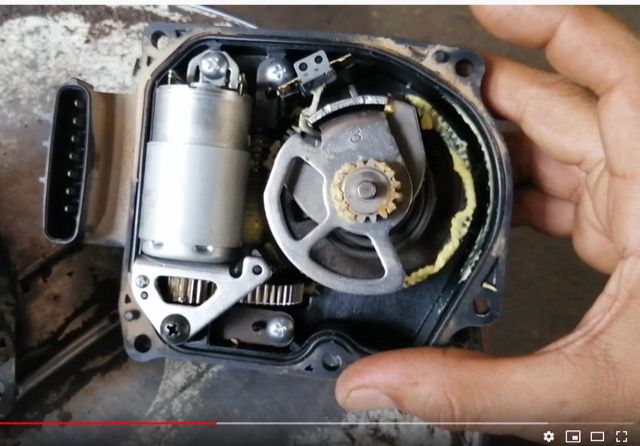

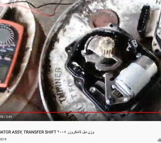

  18. GEARING - I scoured YouTube and found some Arab videos of a similar Toyota actuator. The attached screenshot is what I used as my alignment guide for the TOP HEAD. The bottom head (HiLo), is misaligned very slightly but I know what I did wrong. Luckily, it's easy to get to so I'll fix it shortly.

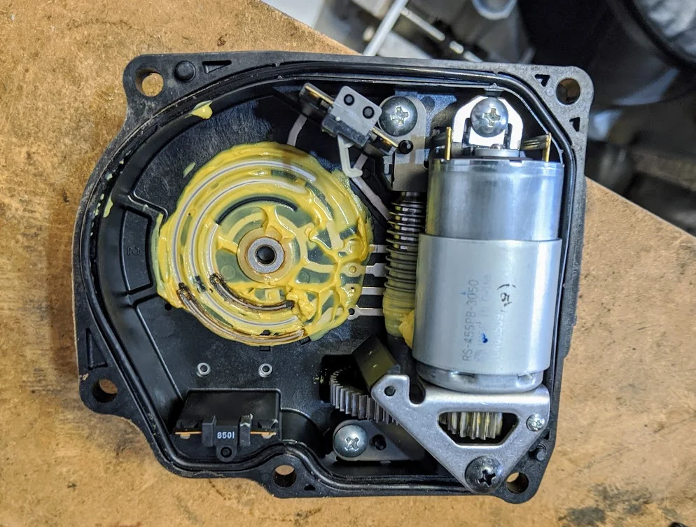

Thinking about rehabbing both of mine - can you describe a little how you ensured you kept the gearing/teeth correct?
Anyone know a source for the yellow grease? Maybe there is enough floating around and it's not necessary, but I will be taking mine apart soon and I'd like to know what that grease is if I need it.
See the screenshot for the upper (4wd) actuator gear alignment. That's what I used and it worked. Be sure you hold it in place given the assembly is upside down upon assembly.
For the lower assembly, I wrongly left the micro switch alignment in the gap vs. aligning to be be engaged (closed?) right on the edge of the cam. When I attempt to engage 4LO, I get the Christmas lights and it fails....I've been lazy to get under there and fix it. I'm confident that's the issue.

I pulled both actuators apart. I sprayed out the inside of the diff lock motor first and then ran it with my voltage supplier. I didn't realize how slow it was until I did the same for the lo/hi motor. The lo/hi motor was screaming fast. I assume theyre both supposed to be the same speed at the same supplied voltage/amps? I may pull the actuator back out to see if I can clean the brushes better to get more speed. I tested them at 12v and 1.0 amp. Any idea what amperage these motors normally pull?
The inside of the contact switch was badly oxidized. In fact the entire surface was black. Definitely recommend pulling the switch apart to clean it. My hi/lo switch continuity was intermittent when tested on the bench. It was fine after cleaning.
The half moon contact surface that appeared oxidized cleaned right off with a q-tip. I think it was mainly burnt grease.
