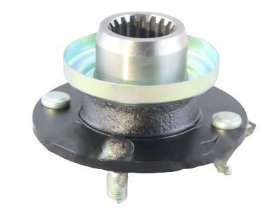

$146 and possibly still available.
Flange has pressed studs in it.

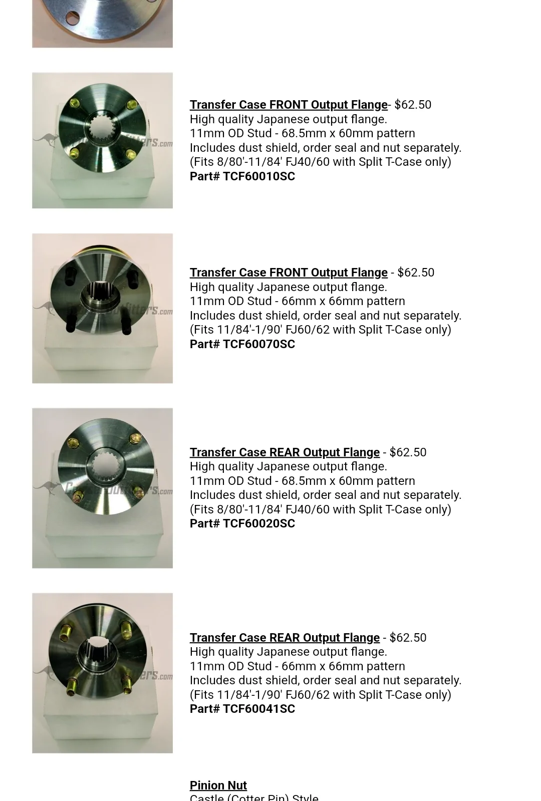

For clarity it's true that we (Cruiser Outfitters) do not offer split transfer case flanges with multiple drilled patterns. This because the studs would prevent it from being and ready to install solution.
We do however offer split transfer case flanges with both the early and late pattern, high quality Japanese at a significant savings from the OEM Toyota flanges (which we also stock)
The TCF60010SC and TCF60020SC would fit a 1/1974 and later (4spd) FJ55 driveline.

The difference is the bolt patterns - any of the splitcase flanges will fit any of the splitcases.
Kurt- thank you for the clarification and information. Will the TCF60010SC and TCF60020SC flanges work with the late model split case that we bought from you? Listing says it works with the early split cases. Please clarify so we can make a decision and thanks again for the post. Gary
Correct, fronts will interchange across all split cases and rears will interchange across all standard split cases (w/o park brake) too. Shape (rectangle vs round) and flange pattern are the only real variants.
