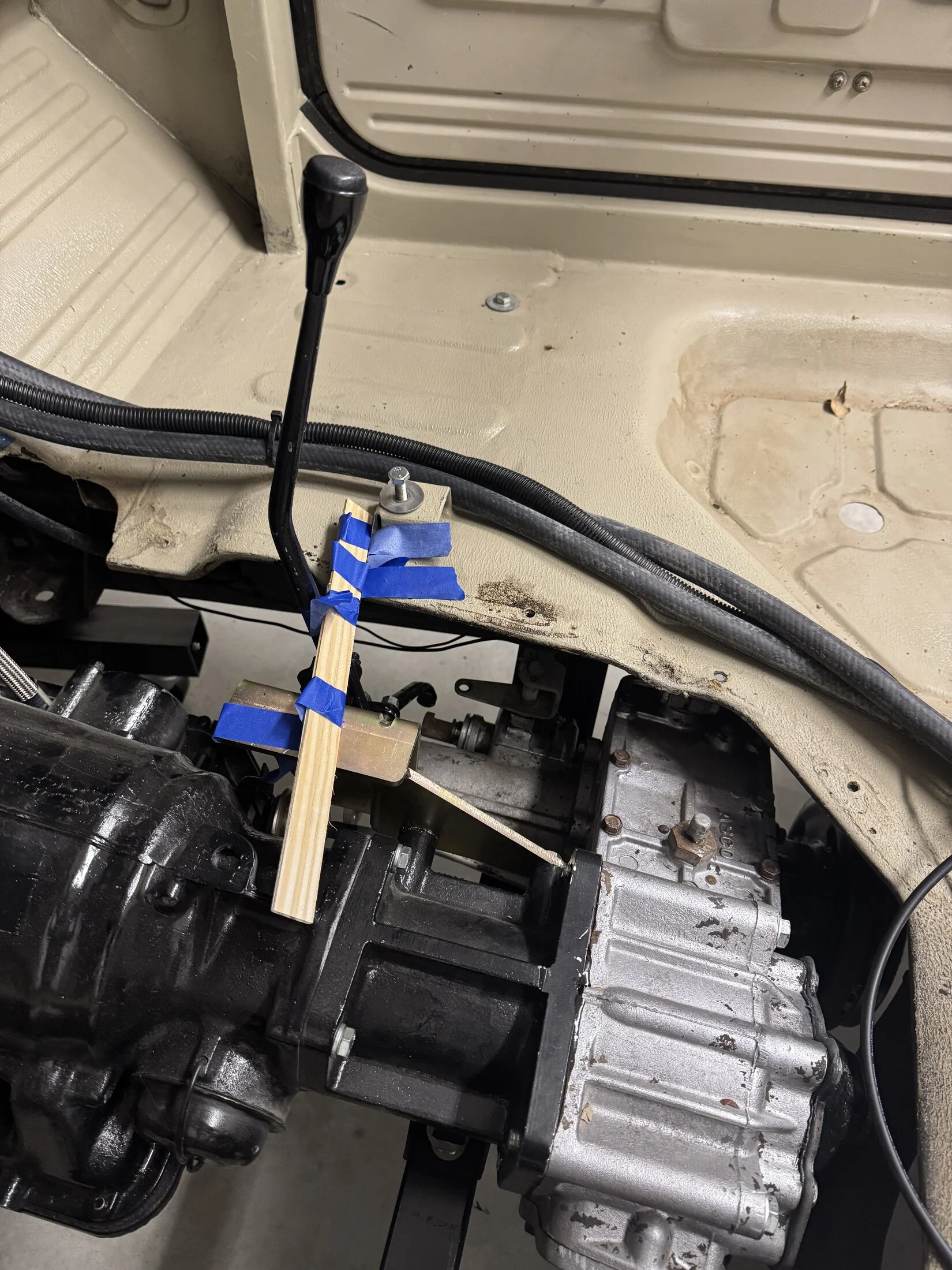

Does anyone have pictures / advice of what you did in this situation?

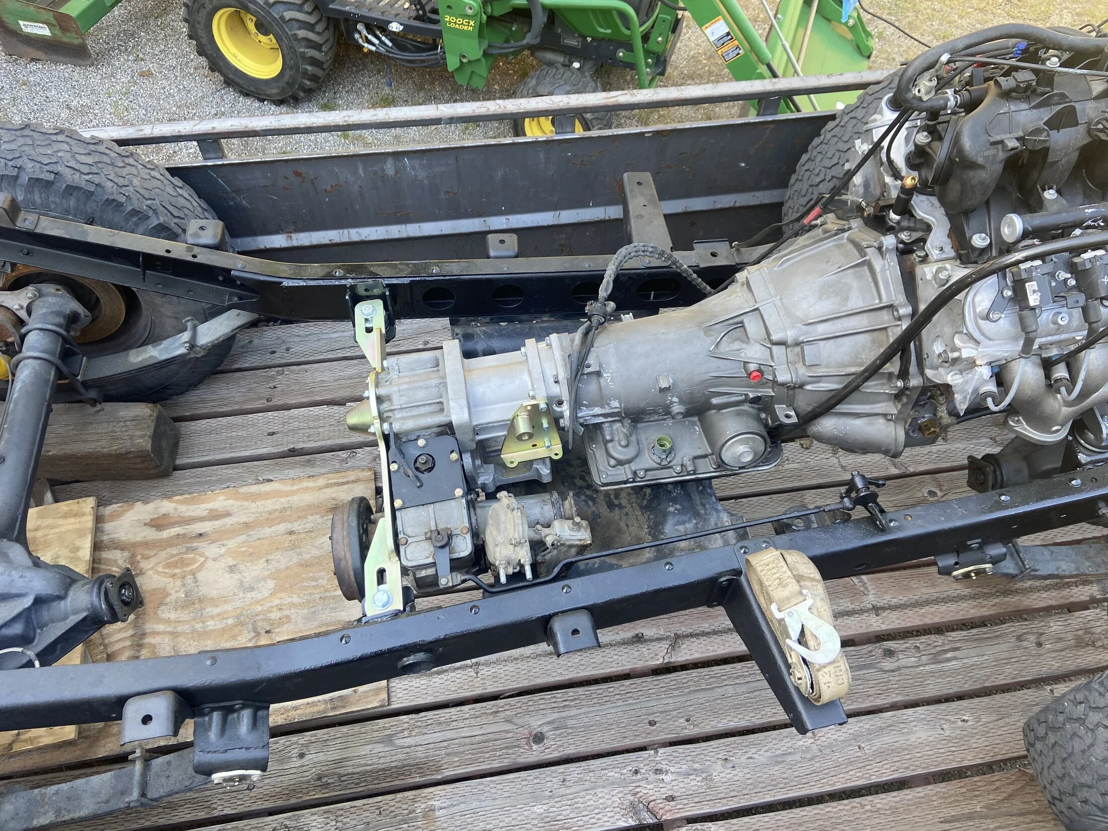

Sorry, couldn’t resist. I kept the original linkage and lengthened the rod about 7”. That was for a 4L60e and the original dash shift. What year is your 40?

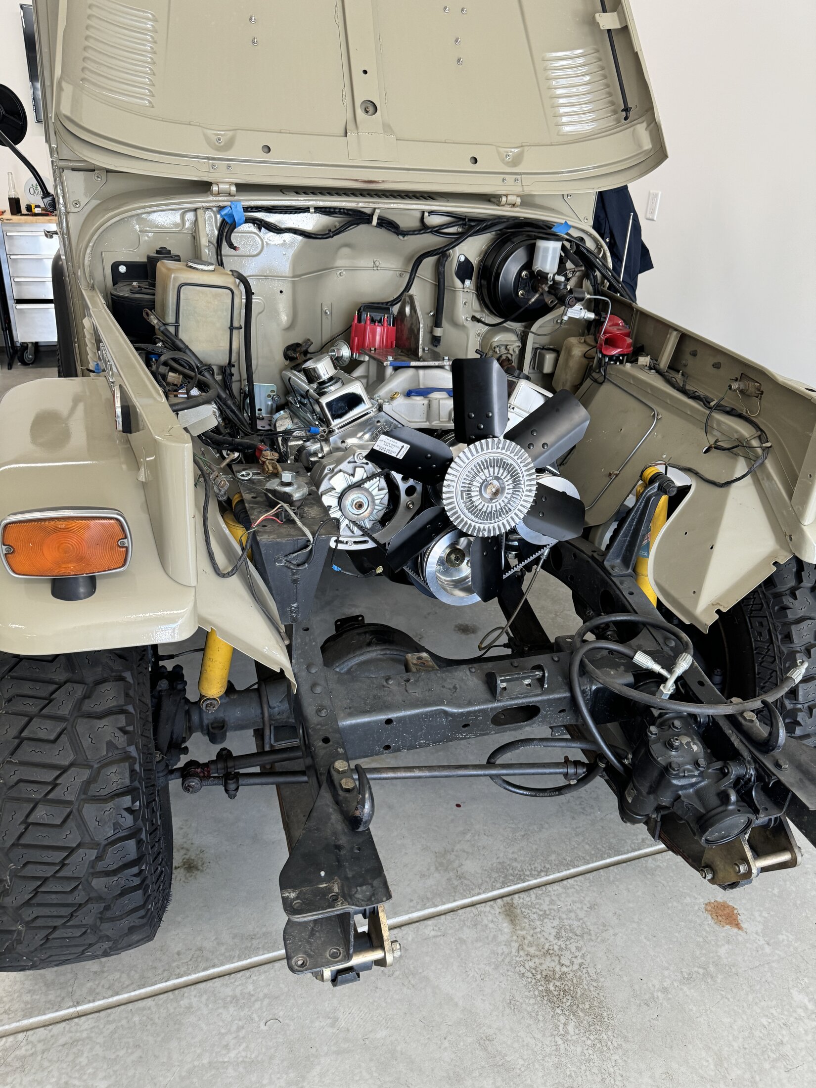

Mine is a 1973. I installed AA’s relocation bracket but as you can see in need to makeup some real estate. I had the original 3 speed transfer case rebuilt while it was out. I purchased this FJ40 in 2011 not running with rotten floors and such. I pulled the original engine out and dropped in a 327 I’ve had since the early 80’s. I bolted it up to the original 3 speed transmission. I did some bodywork and paint and started driving it in 2013. I purchased a new motor from Blueprint this year and had a local shop build me a transmission with AA’s adapter parts. Just down to the small but time consuming items

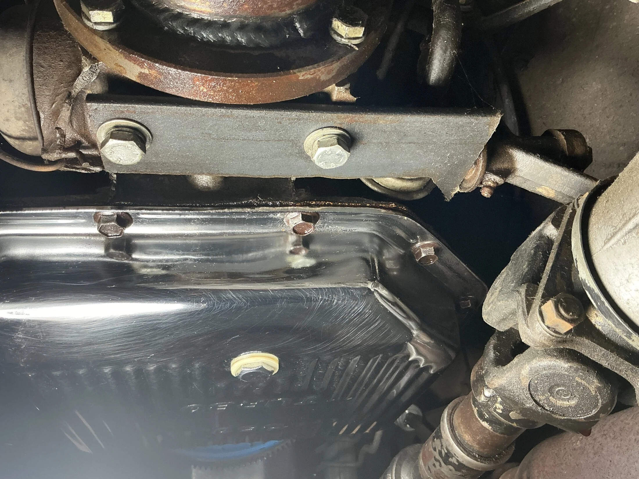

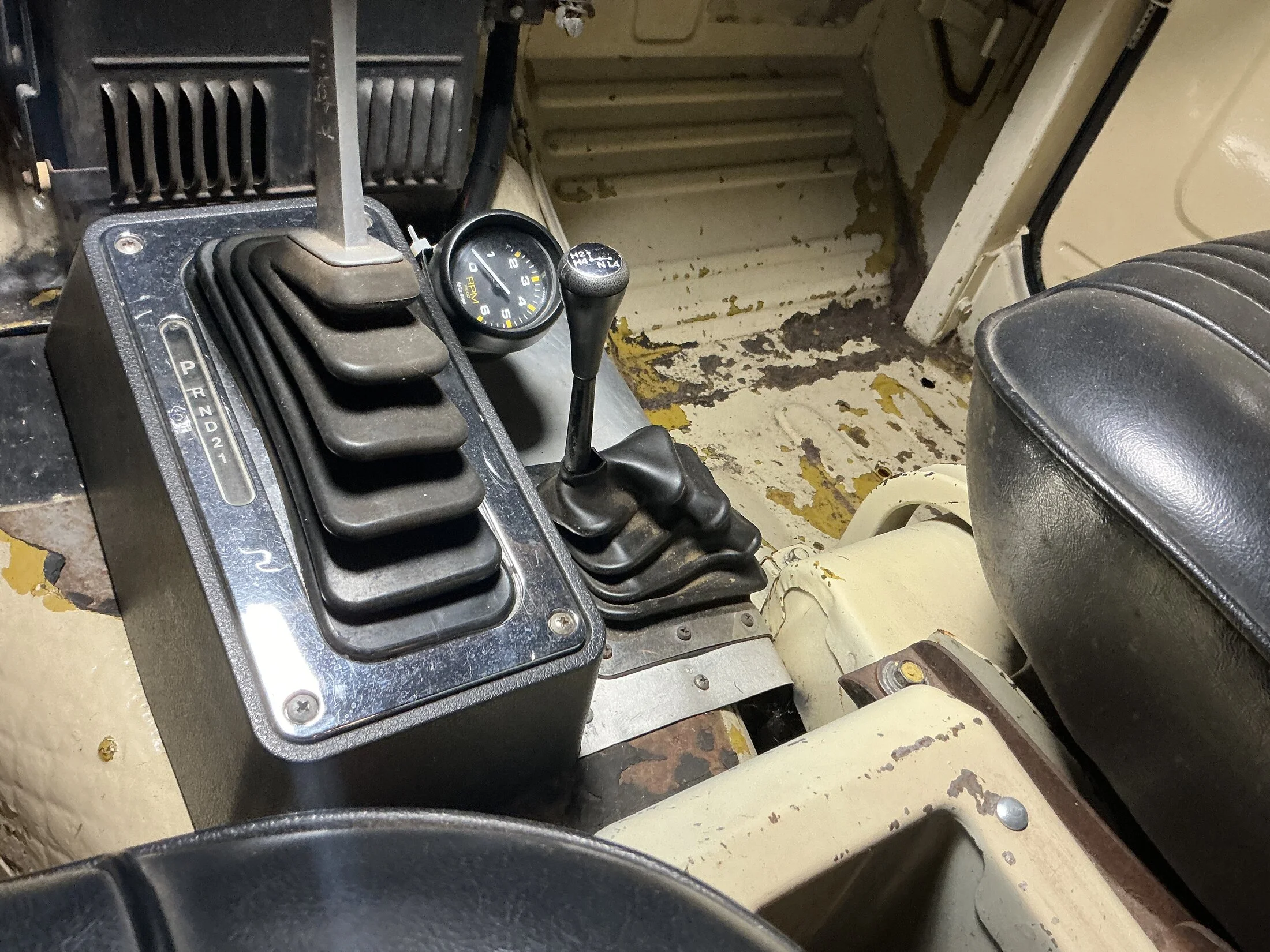

Here's are two pics of mine. We made a plate to weld the shifter's pivot stud to and mounted it using the old tranny mount holes. Obviously it's a bit further back so we had to chop the tranny cover and fab a new boot. In the process I ditched the sheet metal shift gate so I have Hi-2 and Lo-2 as well as 4WD.
