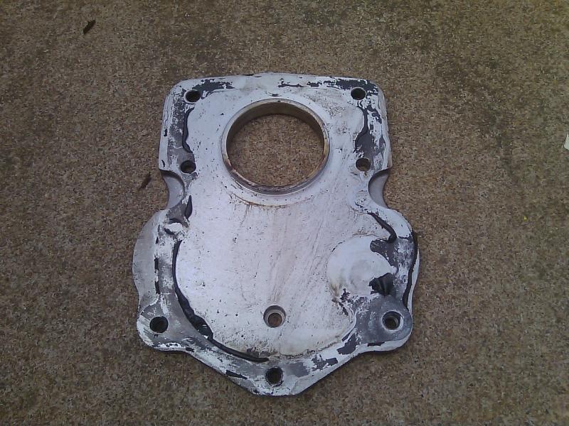

Don't know why that adapter plate is there, but start the process and take pix and post if you get stuck. You may want to post some pix of the tcase after you remove the adapter to see if there's been any mods to it.

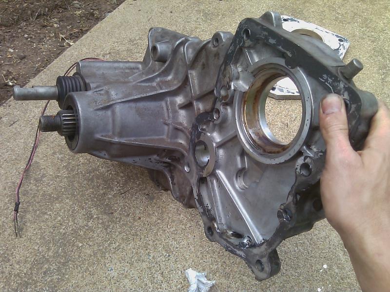

Holy smokes! That bolt is a pain to get off'. I still have not gotten the bolt off that is on my exsisting t-case. I had a 4 ft breaker bar and was actually moving the motor, and the bolt will not budge. I guess I will have to put some heat to it tomorrow. Anyways, here are a couple pics of the case I am trying to use. You can see the mounting plate that was on there as well.
At the very least, you're gonna want to put a new seal here.
That Nut on the output shaft is staked, so you'll have to pry up the stake notches and hold the flange with something. You can make a SST by using a some flat stock and drilling holes to fit over the studs.

The front half of that case looks to be the correct one for your tranny (4 speed with a spacer). Regardless of the idler size where the bearing on your tranny output shaft enters the tcase it looks to be correct. Also that small recess below the opening is actually for a small funnel associated with 5 speeds. You won't find it on early tcase's. What you may find on your old one is a hole for a bolt (right about where that arrow is) This bolt has been eliminated on 5speed and auto tcase's.
Check to make sure someone didn't mix and match on you. Make sure the idler shaft holes are the same size in both halves of the "new to you" tcase.
About that nut. Make yourself a plate that bolts to the flange. Unstake the nut (tap a small chisel into the notches to spread that part of the nut that has been pounded in) Put your wrench on the nut, make sure the plate is jammed against some thing and smack the wrench with a dead blow mallet. The nut will come right off. It is only torqued to about 94 ft lbs (Toyota specs) By the way you will need the plate/tool to re assemble the tcase it will also work on your differential flanges.

Thank you Spike and KYnot. Igot that little piece bent up and will see what I can build to hold that flange still and get the bolt off tonight. I cant tell you what a relief it is to hear that this case should work. Spike, thanks for the heads up on getting a seal for that opening. I am going to order a complete gasket set, so I will add a seal to the shopping cart. The internals look great. Everything really seems to be in very good shape.
An adapter plate to bolt it up to a different transmission.
To what I wonder, that would have a 19 spline output.
You better check the number of splines on the input and make sure the splines are correct. Who knows what sort of a frankencase that is. Where did it come from?
Got the old one completly off late last night. Everything looks like it will line up just fine. The only thing that gave me a scare, was the case I bought didnt have the pto gear. I did a little research on SOR, and that is actually the only gear in the t-case that is interchangable between years. What a relief, I can just use the one I have. There is one hole in the front of the case that I do not have on my new one. Kynot had mentioned that it may have that. Im not sure what needs to be done about not having it. I am ordering all new gaskets and seals tomorrow morning. I am siked that everything is looking like it will work. Thank you guys for all the great info. I will keep everyone posted.
That hole would normally take another bolt into a 'brige' across the middle of the 'spacer'...
When you go H55, you block off that hole in the t'case shell ... Don't remember if it's a blind hole or into the case itself...

You have to block off that one hole. I used a plumbing plug and locktite. I posted pics way back when.
Drew, he's asking the opposite: He's got a case without the hole, but the 4 spd/ spacer with that extra bolt hole in the spacer... What happens if he just leaves it out?
Missed that. It should be fine, but I don't actually know.
Thanks for the correction.
I would think that not having the bolt will not have any effect. The fact that the H55 and the auto tranny both eliminate that bolt would indicate that the bolt is not that critical. I would think that the spacer on a 4 speed is pretty much the same as the spacer around my 5th gear, the difference being that web.
And that bolt is not present on early tcases either as a bolt would run into the bearings on a non spacer tranny.
About that pto gear, if the tcase has a longer spacer you do not have to use it. When I tore down my diesel tcase, I found that it did not have a pto gear. The gear was replaced with a longer spacer (by Toyota, not an afterthought). But remember you can't just remove the pto gear you have to use the longer spacer that will account for the gap left by having no gear.

I will just use the gear rather than trying to find a spacer. It is the same part used from 1980-1990 according to SOR.
So if there is no bolt going into the tranny due to not having that hole, you dont think that it will cause any leaking issues
