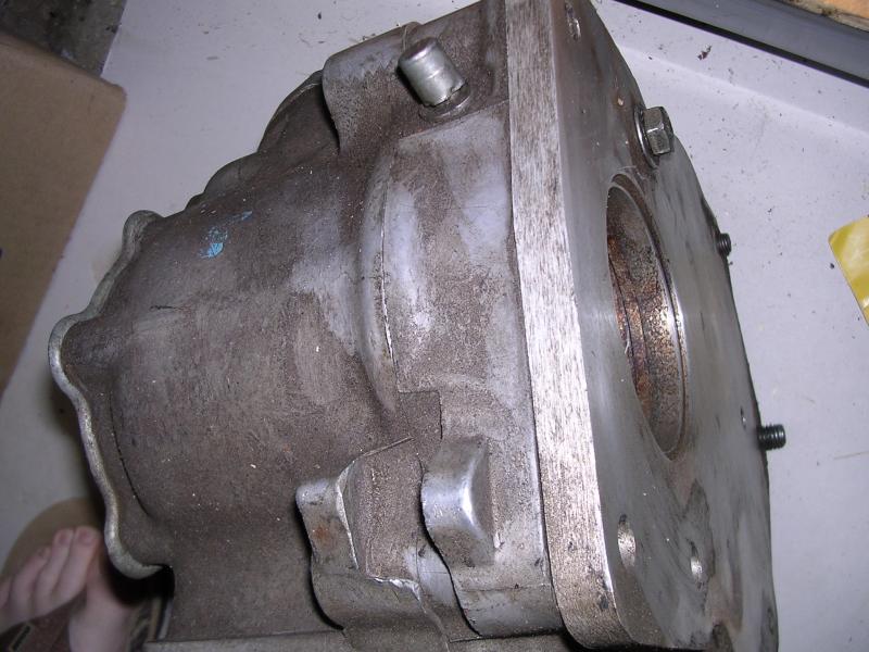

He cannot find a date anywhere on the case. Here is a pic he sent me. This is where I told him to look, but I guess they are not always in the same place. I think I will just get it and hope for the best.
Post 13, Pic #1, shows the early location for date code. On the rear of the case beside the PTO cover.
Sometime around 86 or 87 it migrated up to the very top of the case. (Which is fokking impossible to read w/ the body on :mad: )

I finally got the number off the case. It is 5I5683, so it should be a sept 85 which should bolt right up. The I is hard to make out, but the first response in this thread said that anything past 5/85 would work and it doesnt resemble any of the first 5 letters in the alphabet so I think I'm good to go. I will post the pic on here tonight, I just dont have access to it while I'm at work.
If your tranny has the spacer on the back of the gearbox the older t-case's will not fit. If the t-case is bolted direct to the tranny (no spacer) its the older style. The first pic is my older t-case bolted to a 4 speed and the other one with half the newer style transfer case is my H55 with the spacer.
One thing I found as I combined parts for my 5 speed install, the main transfer gear has the same splines older or newer but the gear teeth from an older case is a different size that will not fit a new case.
The seal surface between the gearbox and t-case is part of the tranfer gear on a newer style case and on older cases it's a seperate piece from the gear.
If the used t-case is off the tranny, take a pic of the side that bolts to the tranny and I or someone else can tell you if its the older style that may or may not fit your 87.
