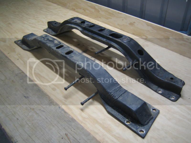

hey guys im swapping my g series tranny in my 83 yota to a w56. how or what do i need to do to relocate my crossmember for the added length of the newer tranny? any help would be greatly appreciated thanks

i cut out the center of my cross member and lenghened it to where it needed to be.
having the cab off made it easy

yea its a pre 84 tranny non removable bellhousing i like the idea of the bracket that downey offers but wouln it put to much weight behind the crossmember and cause the rear of the tranny to droop i run a CNC waterjet at a machine shop it would be easy to duplicate

well i got new clutch and everything in there tranny bolted up hole relocated for transfer case shifter. with the original crossmember bolted to the new w56. talk about a tight fit with the cross member all the way against the bottom of the frame the top of trans is hitting the tunnel i think we will weld some 1/2 in plate in between for needed clearance i wish there was an easy clean way to relocate this crossmember without it looking like hammered .....
