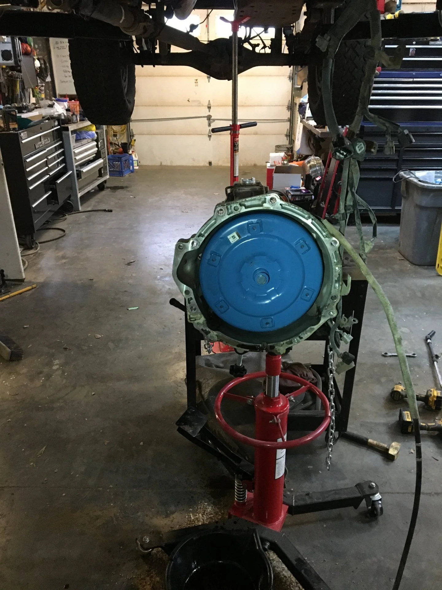

Looking for a good tranny jack option as we speak.
If you can line up all the parts to do in a short time, we might be able to work out a deal on using my shop / lift. Of course, we would have to kick @StucknKS out.
I have a tranny jack I bought from HF that I have not returned yet. Had to use it to install a transmission/tcase on a 70 GMC. If you need it, I can help. Do you need this for @StucknKS rig?
like this? I just pulled trigger on one from Amazon. @BILT4ME

Nope. Mine is the floor model and rated for 800 LB. Since you have all the cool toys, that style will work better with the lift.
BTW....How do you get it onto the jack?........ (Yeah, I know...Engine hoist)
