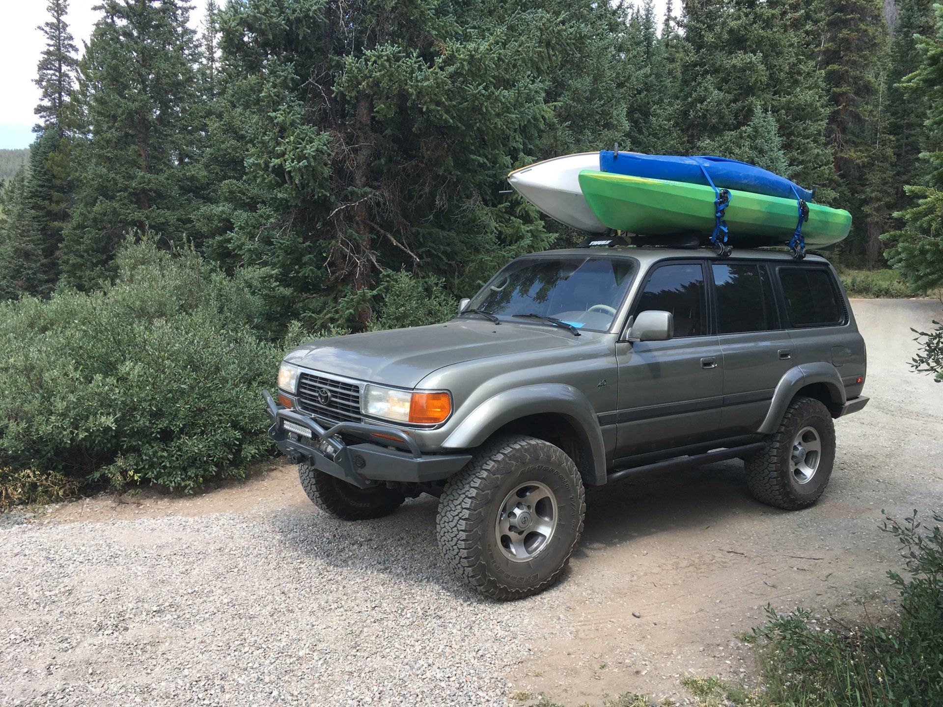

Just throw the kayaks on the roof? Works well for me.
