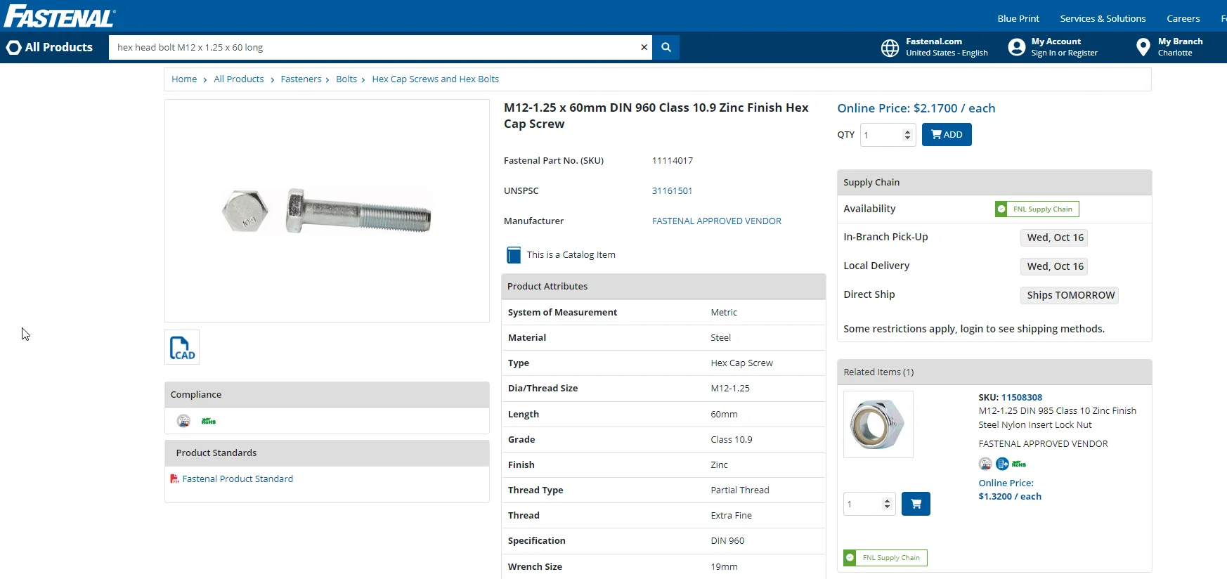

Where can I buy these infernal M12x1.25x60 grade 10.9 bolts?
Fastenal, Metric and Mutlistandard, Belmetric, or you could come by the house. Fastenal has two locations on Westinghouse Road; the others don't sell to the public. :(

If I can't find them:
this is the 616 Westinghouse Road branch.
