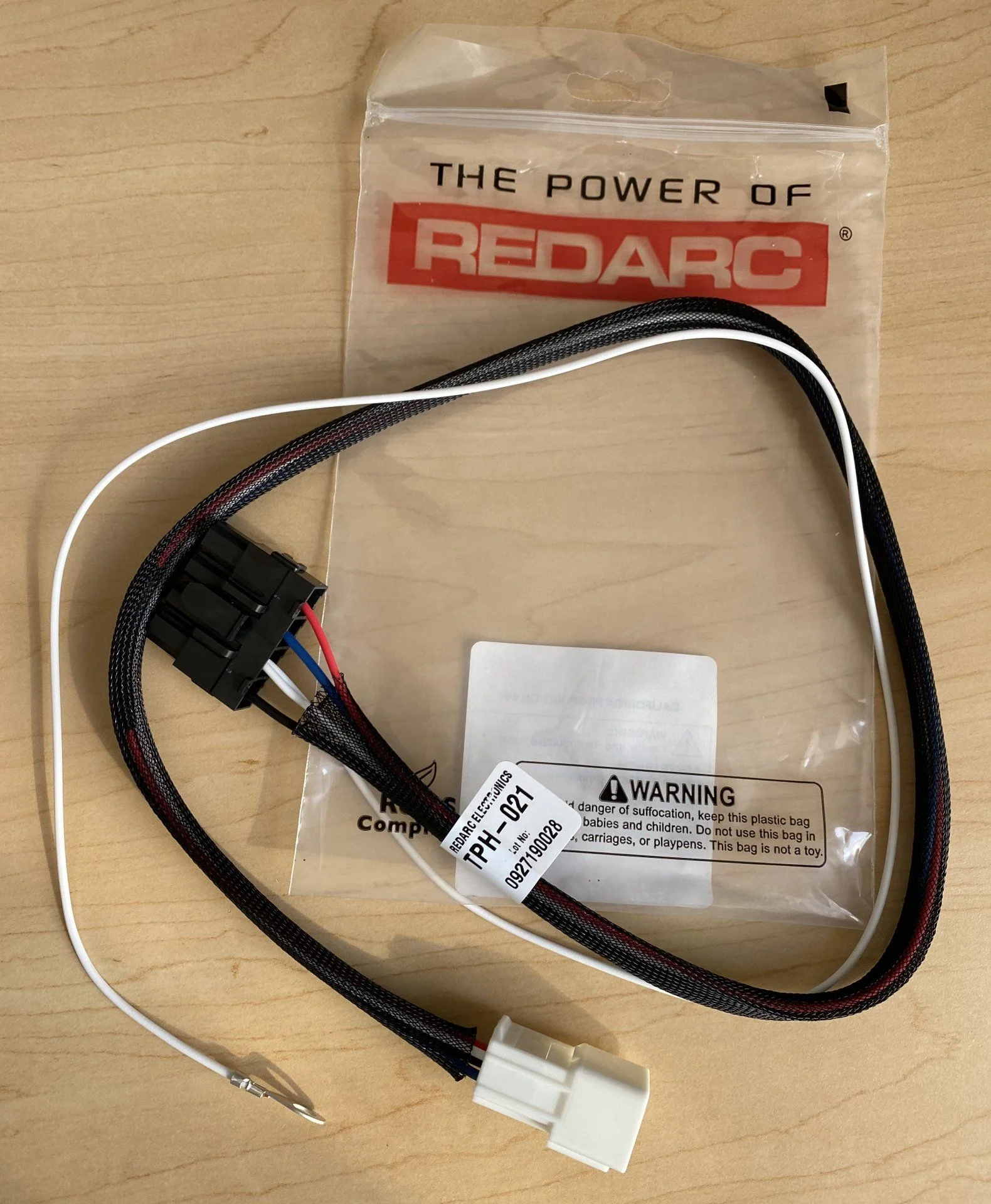

So the latest in my continuing saga. Still having the issue intermittently. Today I received the recommended wiring harness from Redarc. This one has plugs on both ends rather than the bare wires that were on one end of the harness I originally received with my TowPro Elite. (Thanks to @afgman786 for suggesting this though what I received is different than what he had.) Mark Bruce at Redarc support recommended I consider using this. The idea is that I can replace all of my lame splicing into the Tekonsha harness and plug this directly into “something”. So that is the question. Where do I plug this in? Also, is the white wire with the “eye” on the end intended as ground and if so where should I connect that. Here is a pic of what I received.
Yes that white wire is ground. If you remove the panels to get to where your tekonsha is plugged in. You'll unplug that harness and the white end will go straight into that. There is also a bolt under the steering wheel that goes into a metal bracket, I used that to ground the white wire.

Thanks, @afgman786! I would hate for you to need to pull apart your dash to take pics! The last time I had it apart I saw that the harness I spliced into had a white plug that plugged into a socked on the left side to the left of the steering wheel. I am hoping it is as simple as unplugging that and replacing it with the white plug on the end of the RedArc harness I just received. Also, thanks for the tip on the White cable and where to ground it. If this works it will certainly simplify things. If the problem continues to show up we at least will know that it is not my splicing! BTW, if anyone needs this Redarc TPH-021 harness they were out of stock at Redarc but I was able to get it through eTrailer. Though at eTrailer it shows as a different part number. But what was delivered is the Redarc version as the picture showed.
Also, thanks, @Sasquatch1. You are correct. The picture on the left side of the PDF is what I attempted to do. I am guessing (hoping) that the issues I have had are a result of my poor (or absence of) splicing skills!
