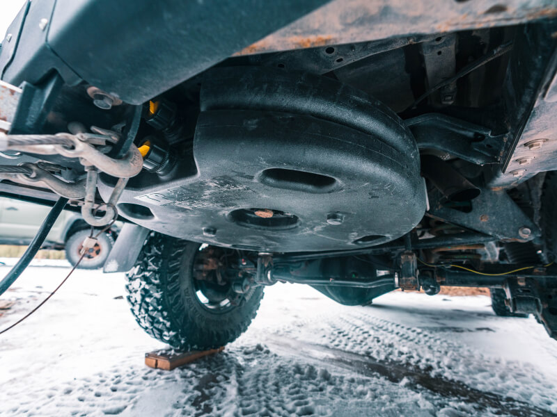

Just wanted to throw this out there. No affiliation here. I got a couple of Trail'd spare tire liquid tanks last week. Great customer service and nice product though a little pricey. But so are rotopax when you add all the mounting things required. I wanted a solution for extra water and gas and if it worked seemed like a good solution and location to hold the 6 gal of gas and water if it worked out. I was concerned about carrying fuel there, but would rather it there, then on the roof. I used two tanks. The gas tank I had at the top and water underneath to protect it if anything hit it. I Just got back from a 4 day trip in the South Tahoe/Kirkwood area with them. We did Pardoe/Squaw Ridge trail and a bunch of forest roads for reference of terrain. I filled them at home at sea level and traveled as high as 9500 ft with 90 degree weather. There were no leaks, and it performed as advertised. One note is definitely wash them out as there is a lot of debris when you receive it from the factory. Black plastic pieces. I shook them out, washed it and it seemed good. It is a little inconvenient to lower the tank to get the water on the trail or at camp (especially with dusty ground,) but as a backup source it was nice. I think this will be where I carry extra water for sure and as an extra 6 gallons of gas for the thirsty girl. Other note is I would probably put a large washer on the under side of the bottom tank to spread the pressure of the tire pulley. These are not epa rated for gas, but performed just fine, but of course use at own risk.
I appreciate the account on these! I'm thinking that this will be my solution to fuel storage on my Gx 460. I know that these carry no EPA fuel rating, but did you have any issues? It seems like the folks on the 4Runner forums fill them with fuel no issue. Also, any issues with expansion / venting of the tanks at altitude? From my past experiences with Rotopax, I would typically vent the containers when up high.
No issues with fuel. They have some flexibility to them so I think they expand. I didn't vent at all, and again that was filling up at sea level and driving to 9500 feet in heat. I would be curious about the other way though. If I filled them up at elevation and drove down how it would handle the vacuum vs expansion. Since I had the gas above the water, I would occasionally reach under to check for leaks and not a drop. I also smelled the water tank at the end to see if there was anything smell and couldn't detect any odor on the lower tank or the main gas one. It did kind of "reshape" the lower tank as the tire hoist pulls up through the middle of the tanks so the lower tank kind of flexed concave as you put pressure on it when you lift it tight, but I reached out to the owner and he assured it isn't a problem, and that the tank was designed with some flexibility in case there is too much pressure. I will probably be adding a larger washer where the hoists contacts the tank to give it some extra strength. Don't forget to flatten the tab on the hoist. You will see it.

Couple years old but wondering how they lasted.....
They are working good. I've kept them empty when not in use underneath and still working. I've used them for gas 4 times now (only needed the extra fuel twice) No leaks. It's a bit awkward to fill the tank with the small nozzle and the short scepter filler. Definitely spilled some gas, but having this solution vs a Jerry on the roof for me is a good solution. The material seems soft enough to expand at elevation gain, but it does deform (concave) a little with the tire chain pressure against the body as it holds it. I would think a simple syphon hose would work great but I haven't gone that route yet. I have it the lower on a rock once and it put a scrape in the plastic but not even close to puncturing it. They are pricey but since I don't have a Jerry holder on a bumper and don't want to put gas on the roof it works like a charm. The peace of mind of carrying the fuel for me or someone in the group is very worth it.

Definitely clean out the inside first REALLY well. There are plastic shavings on the inside when you first get them and even after that first go there was a bit of a color to the water on the first use. I should have cleaned them out better. I used one for gas and one for water the first 2 trips. First trip had the coloration but was ok after that. Looks like I could have cleaned them better. Since then I have moved them both to gas only use.
If you're using anything that is brand new for out of the box that is roto/plastic molded for potable water, you need to clean the inside first!
First thing I did when I got my Scepter cans was to use a little Dawn dish soap (just cause that's what we use in the house), rinsed them out very thoroughly, then with some plain liquid bleach (not scented or powder) and mix with water. Again swish around vigorously and rinse.
Now you'll have fresh clean water that tastes the same out of the container is when it was put in.
Doing that will ensure you've removed any mold release, oils, particulate, etc. from the factory.

good points. I did a proper clean with dawn a few times but didn't do the bleach....
So where are you carrying the spare? I had looked at the trail'd tanks a few years ago and thought it was a good solution for extra gas and water, but the one thing stopping me was what to do with the spare tire. I didn't want the extra weight of a rear bumper carrier, and if I did, I'd probably keep the spare underneath and put the gas and water on the bumper where it's a lot easier to access. Would it be possible to use a large metal plate under the tanks to act as kind of a skid to protect it?
