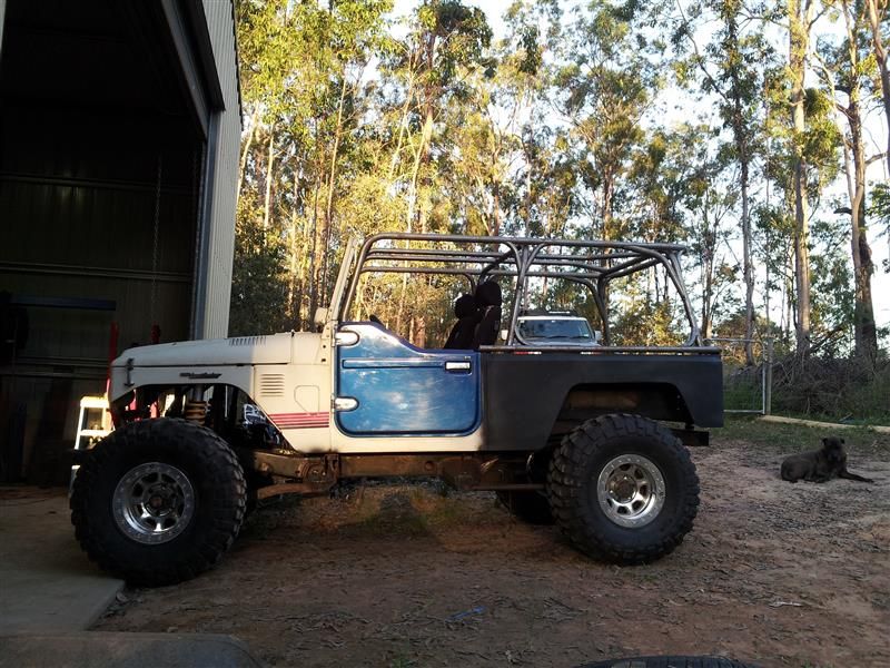

i recently redid my rig from a Spring over to 4/3 link.
Without question it drives better down the road than it used to.. it has a little more body roll than before, but i will be adding at least one sway bar to help out with that.
a note on spring rate: i went as light as possible with my rates, preloaded about 2" in order to get my ride height. 150/150 in the rear, 150/250 in the front.. this is more a setup for racing.. there is no perfect setup for trail/street.. its all a compromise for one thing over another

I ran a bronco PS box on my first one, variable ratio 2.2 turns lock to lock, upped the hyd force, fitted a steel top to replace the alloy one with roller bearing instead of a bush, and we made a pitman arm for it. I also fitted a Range Rover power steering pump, as it was easier to mount with a separate reservoir in the 45 engine bay. I also used the lower section of the Range Rover column, and had the Toyota section machined to fit into the collapsible section, so I could use the RR uni's and steering shaft under the bonnet, out to the box, mounted where the relay box normally is.
But that was in 1992, with the rear chassis chop, 35" tyres, 350 Chev conversion Highmount winch, and a custom tray, and we messed around with leaf spring trimming and grinding, longer shackles, and going through the Monroe catalogue, and welding on extra fittings to the shocks to extend the travel, and fitting more than one a corner back then, before shocks had shiny anodised parts, glossy stickers, and a set of 4 cost more than my original 45 series ;)
