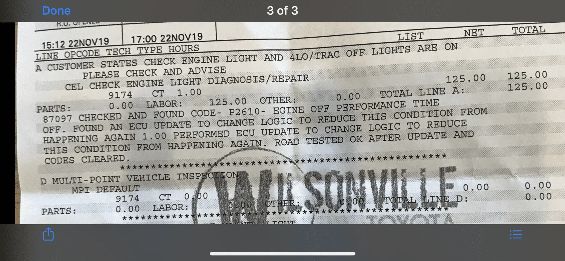

The tech didn’t note the TSB, unfortunately but here are the notes. It’s possible, maybe even likely that the ECU flash will resolve the issue. The reason I asked if anyone had seen this particular code and issue is because I’m leaving for a fairly lengthy trip Wednesday morning and would hate for the issue to come up again while on the road. Especially during what looks like may run through some pretty nasty weather.

It looks like TSB 336-17 fixes this. And, if the vehicle has less than 80K miles, it‘s covered under the emissions equipment warranty.
Thanks for the info @Sandroad - that’s what i was looking for. Makes me feel a little better about hitting the road tomorrow.

@ElJayBird - as @Sandroad notes, the TSB states it's under warranty for 8 years or 80K miles. If you are in that ballpark, time to ask for a refund. If over...sorry, they got you.
