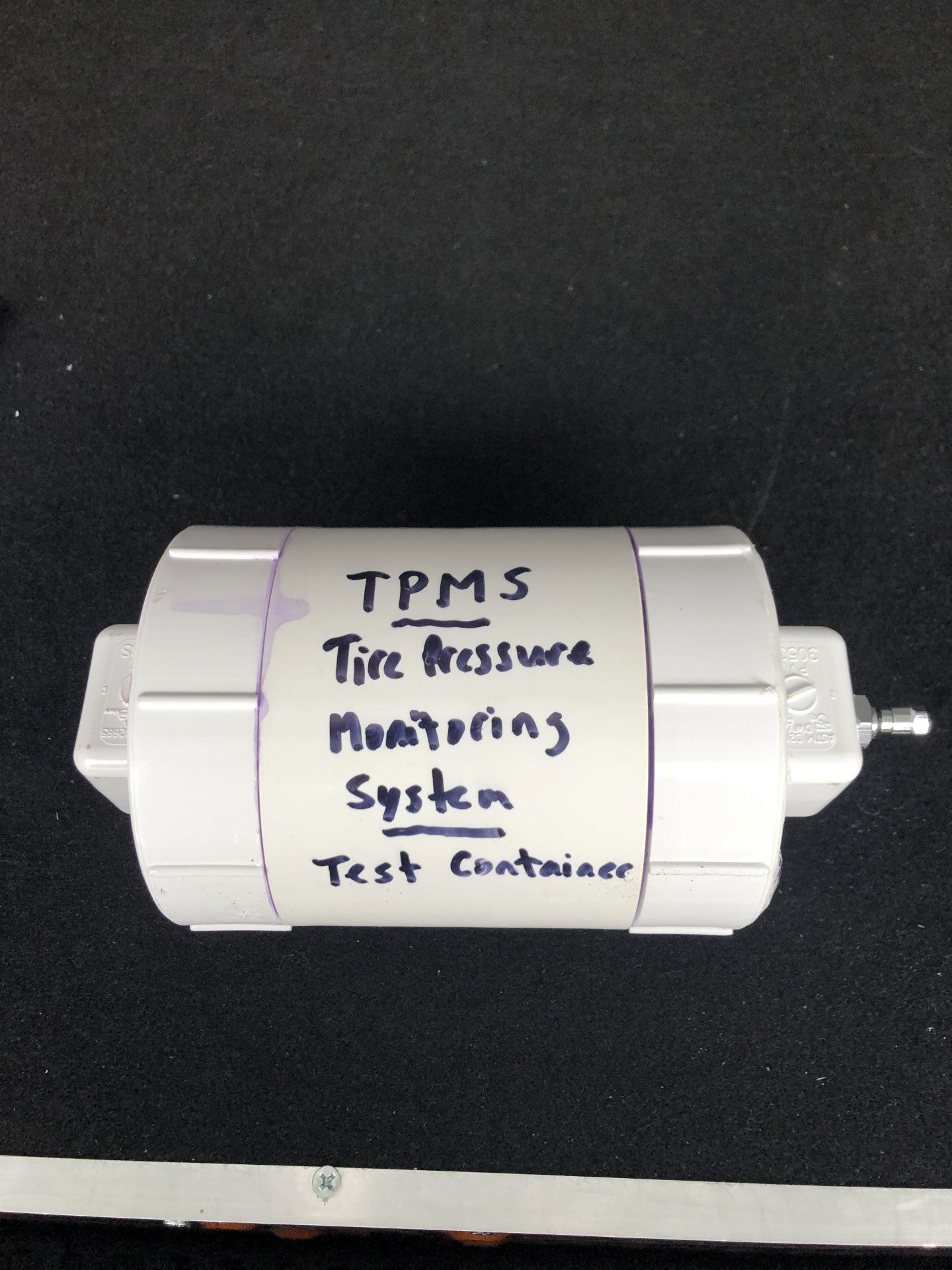

What was your reason for running all 5? Were you swapping snow tires?Yes. I am running all 5 sensors in a PVC container at the moment.
Long story, not that interesting. I bought 5 sensors and had them installed with new tires, I couldn’t get the computer to read them, despite being put into Techstream correctly. I contacted DENSO, and after months of back and forth, they admitted that their fitment information was wrong in their system. I had purchased from Rock Auto, which DENSO says is not an official distributor so they wouldn’t do anything for me. Rock auto won’t help because the fitment chart from DENSO says they are the right sensors.What was your reason for running all 5? Were you swapping snow tires?
Rather than deal with getting to a tire place and swapping sensors during Covid and winter here, I just threw the old ones in a pvc chamber and pressurized it.
Unfortunately I broke one sensor at the valve stem when I broke the bead on the old tire trying to remove it, so I don’t have a full usable set anymore. It reads pressure fine, but can’t be installed in a rim anymore.
One of these days I’ll get them reinstalled. Another $100 in labor plus parts down the toilet.
