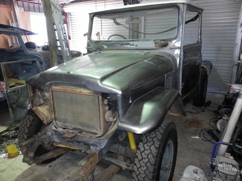

https://forum.ih8mud.com/attachment.php?attachmentid=860326&stc=1&d=1391671342
This is the ute in its current state. it looks a mess but its actually still driveable and licenced for the road etc. I just have some panels removed.

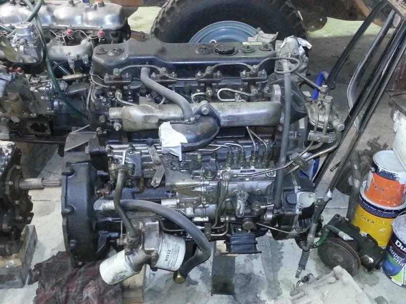

https://forum.ih8mud.com/attachment.php?attachmentid=860327&stc=1&d=1391671342
And this is the 4BD1 motor that will be going in.
