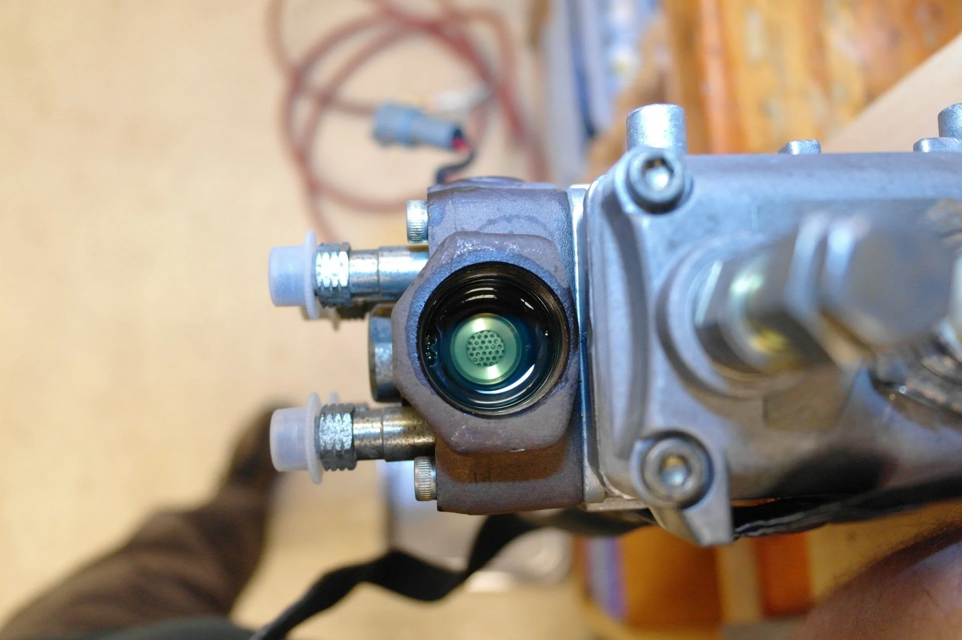

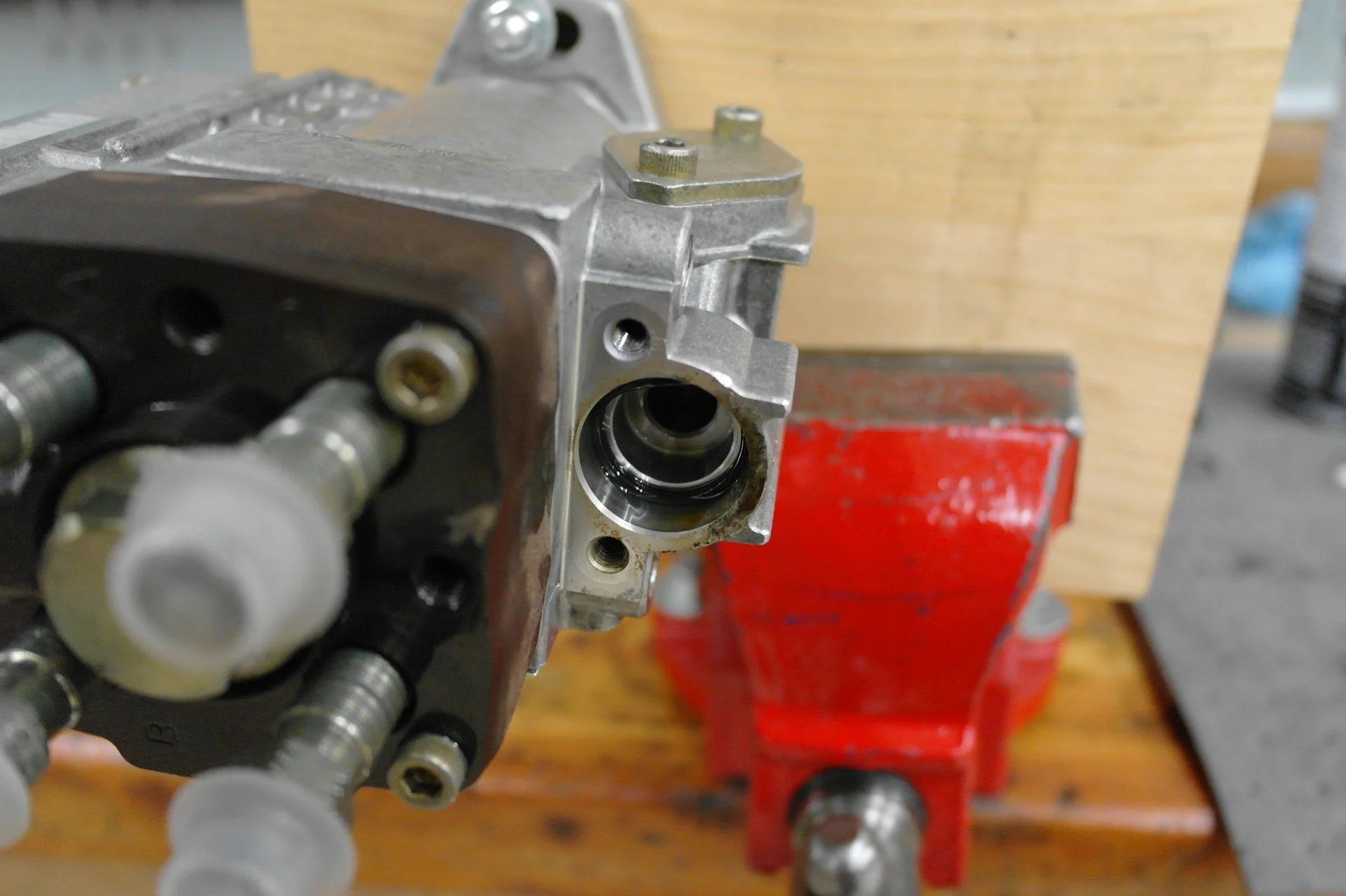

The electronic L series diesels have a filter under the spill control valve. Maybe they cleaned that. I've also heard that debris can settle in the bottom of these pump and screw up the timing control valve functionality (it uses small hydraulic passages to actively control timing).
Here is a picture of the filter under the spill vavle:
And here is a picture of the timing valve location that can fill with debris:

Yes, Ive seen and cleaned the filter in the 1HZ pump. I think all rotary pumps have a mesh filter like this somewhere. Debris inside the pump would probably kill it. If anything gets inside the pump it is more likely something that dissolves in diesel but separates when not in use. I found some slimy oil sitting on top of the mesh filter
