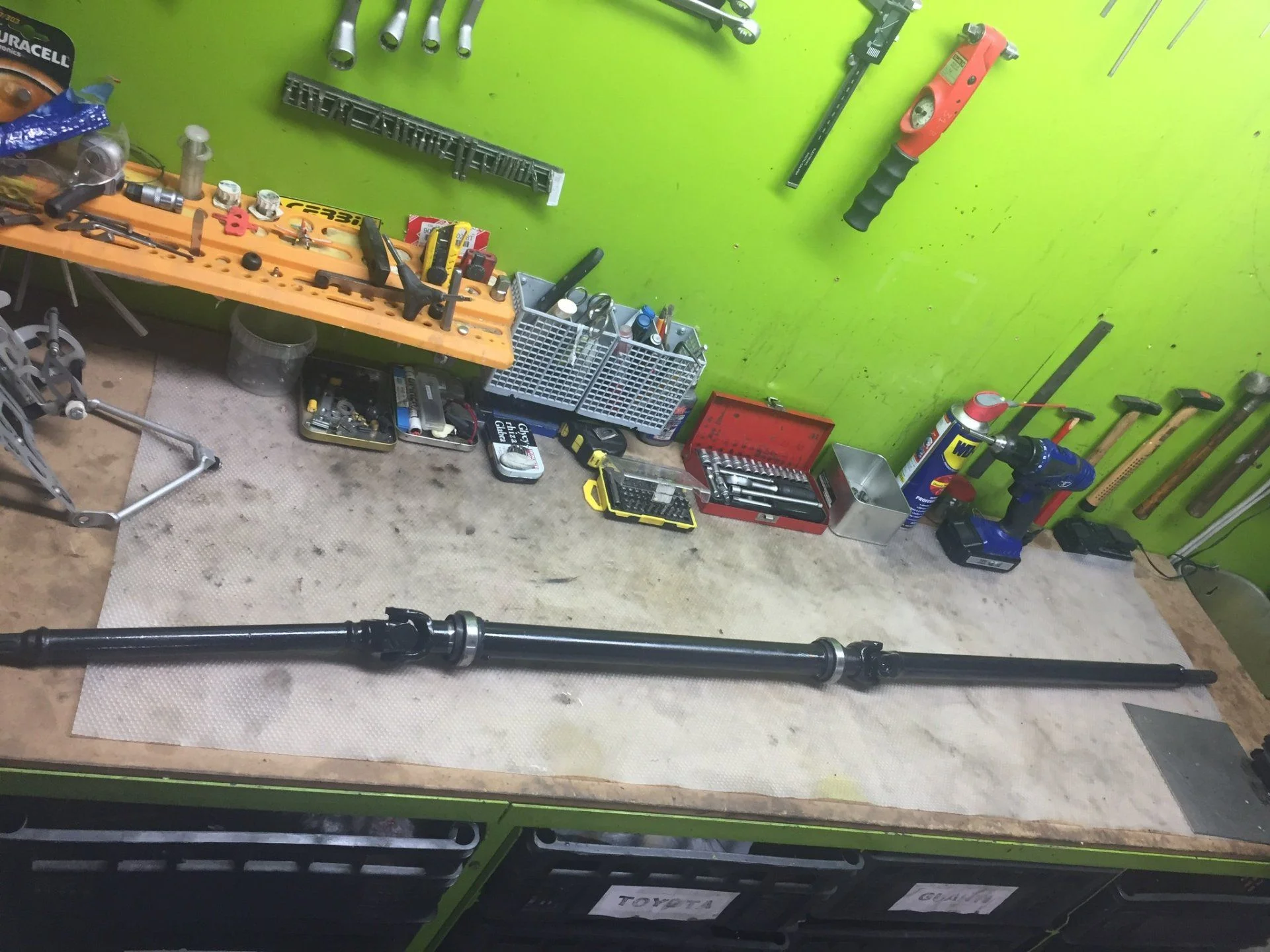

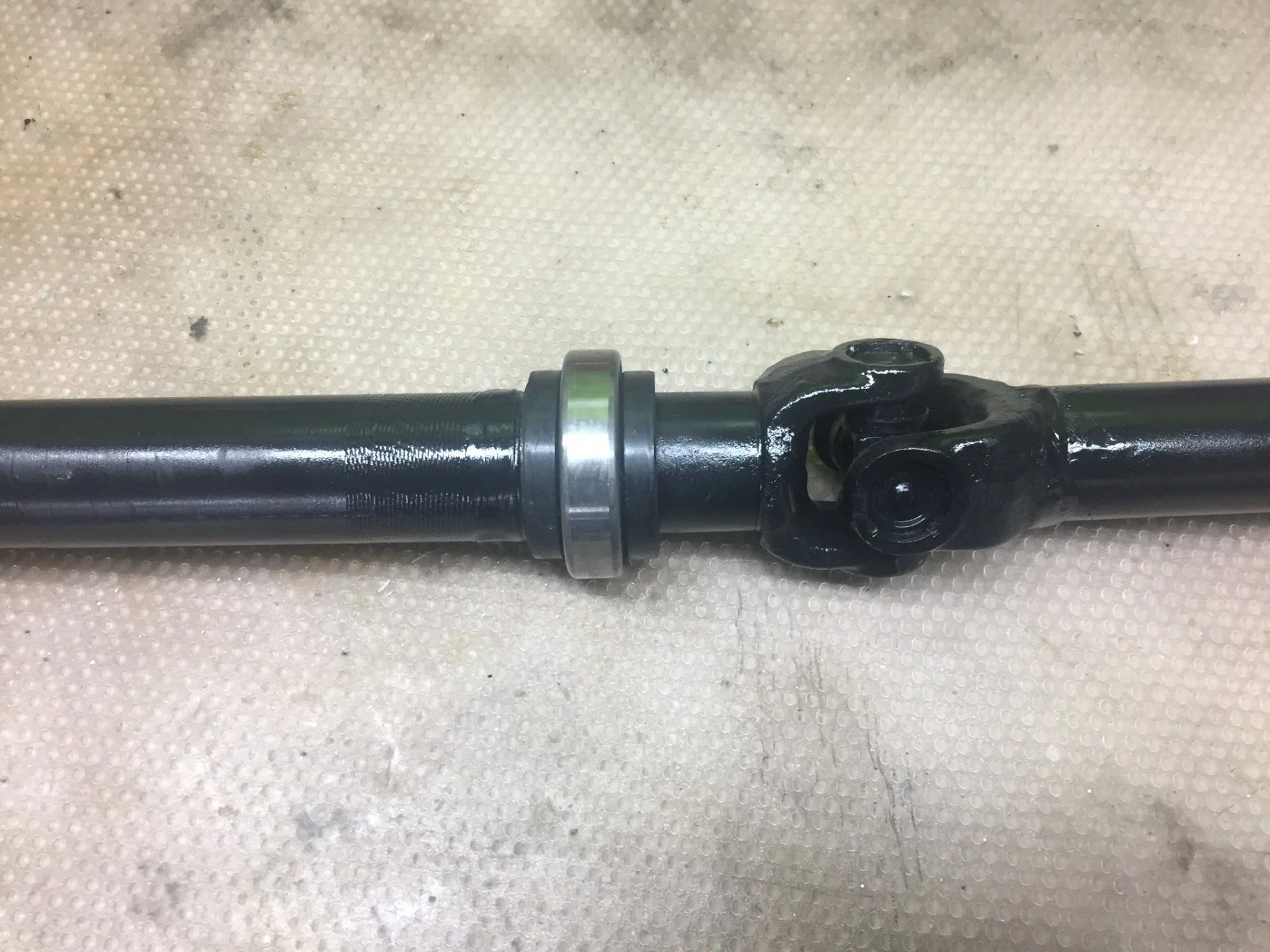

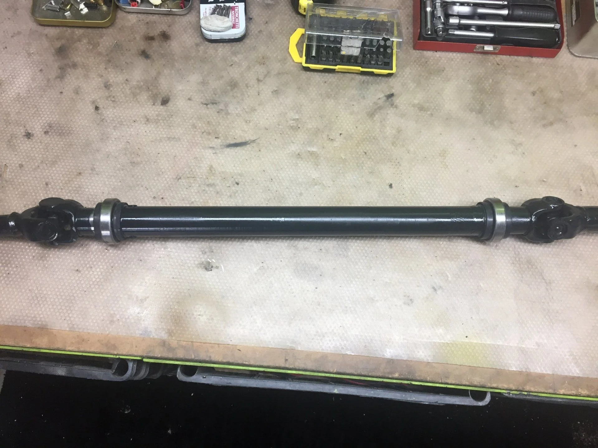

I was stuck between a rock and a hard place , been unable to tear a part the trasmission shaft , in order to change the bearings .
That were completely shot .
At last after trying many places I found a guy that would cut the center shaft , mill down the diameter to fit the new bearings .
Weld and balance it all .
Change a iffy spider and prolong the shaft to adapt to my new transfer case ( 80 in a 78 ) .
All well done
Now I must make the new bearing holders , and fit it .

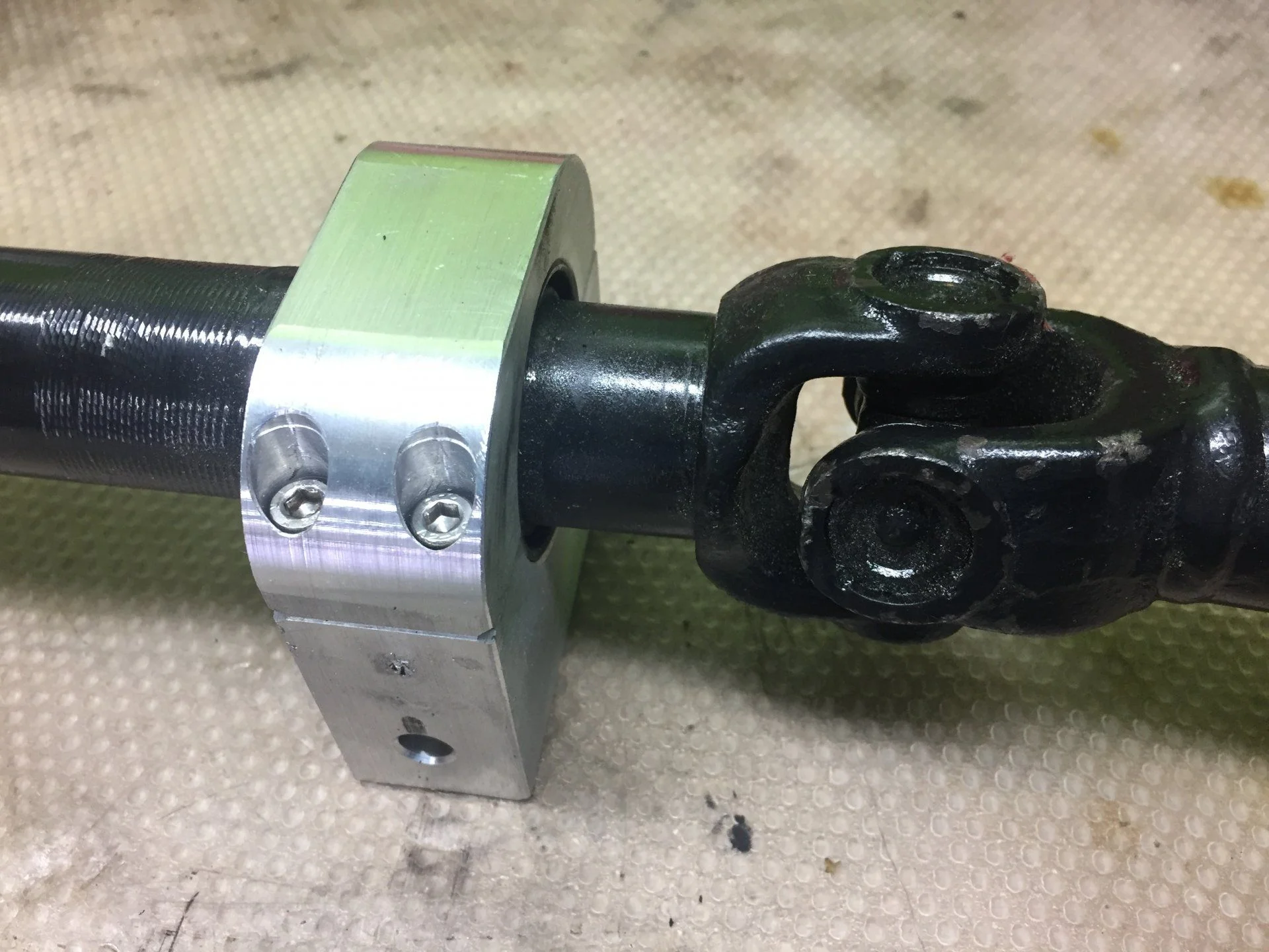

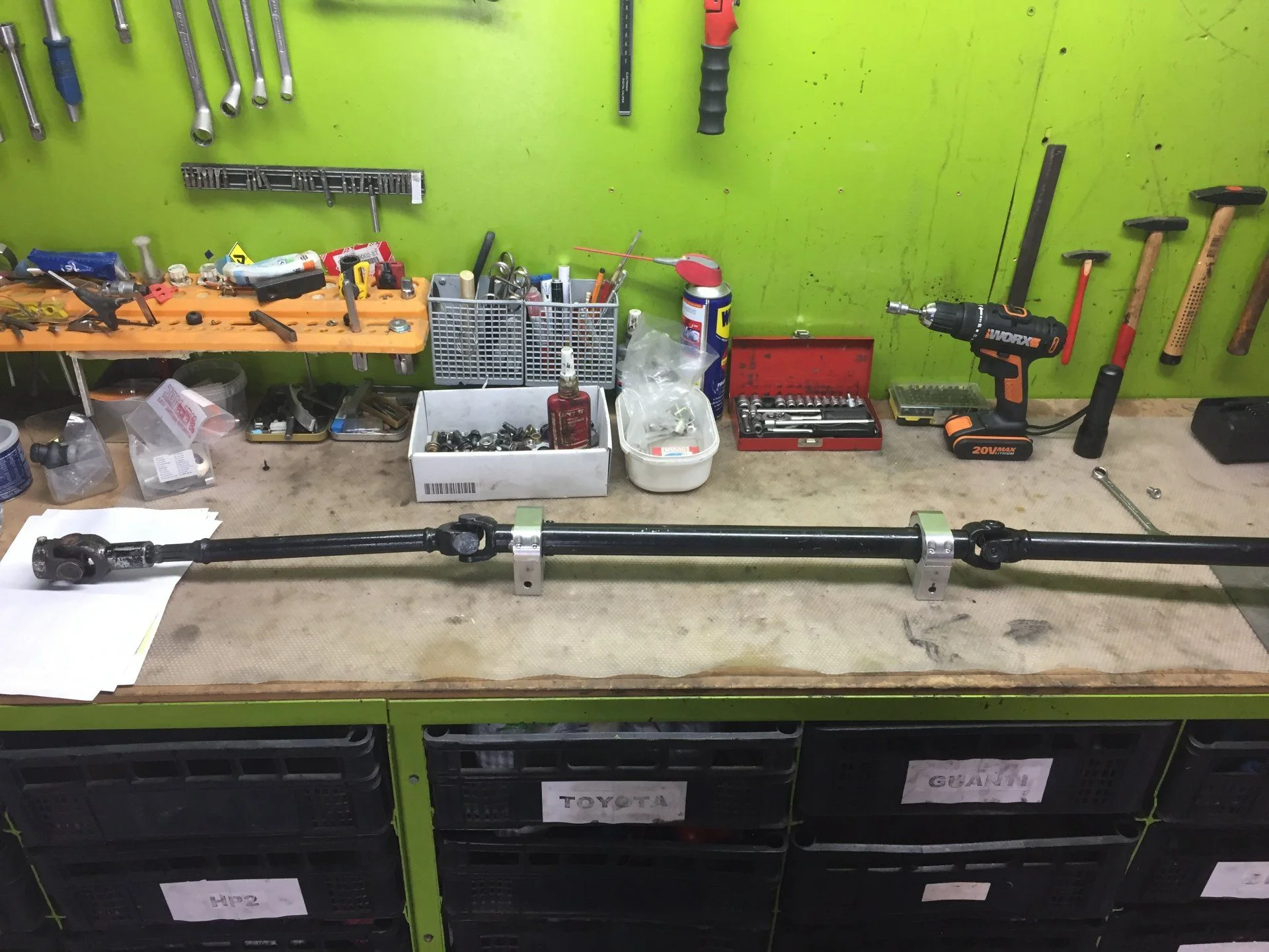

hi Guys , sorry for the long absence , but as you well know things get in the way .

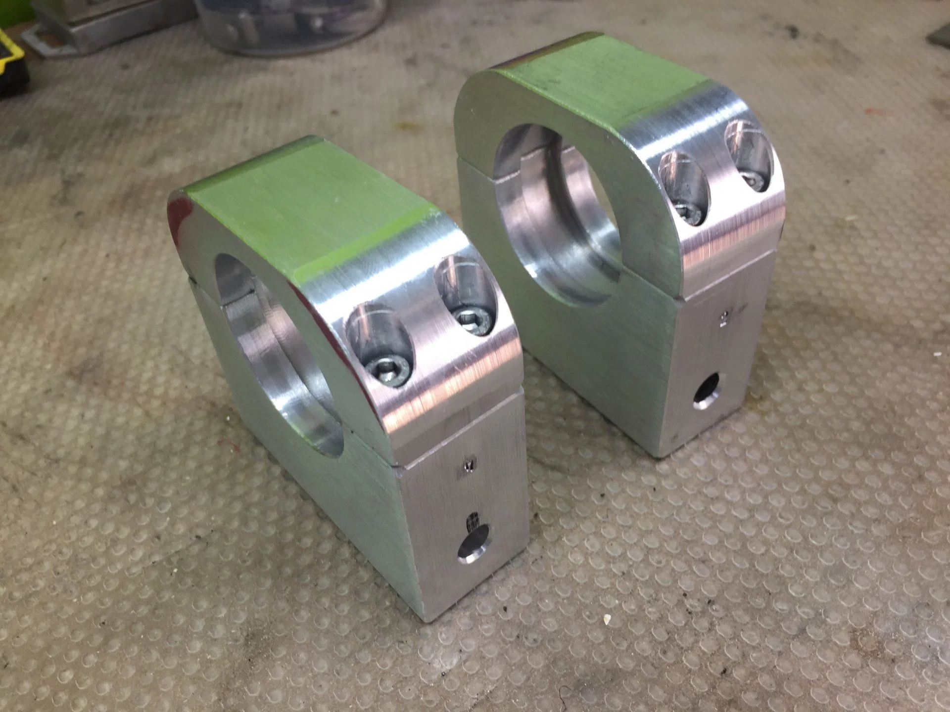

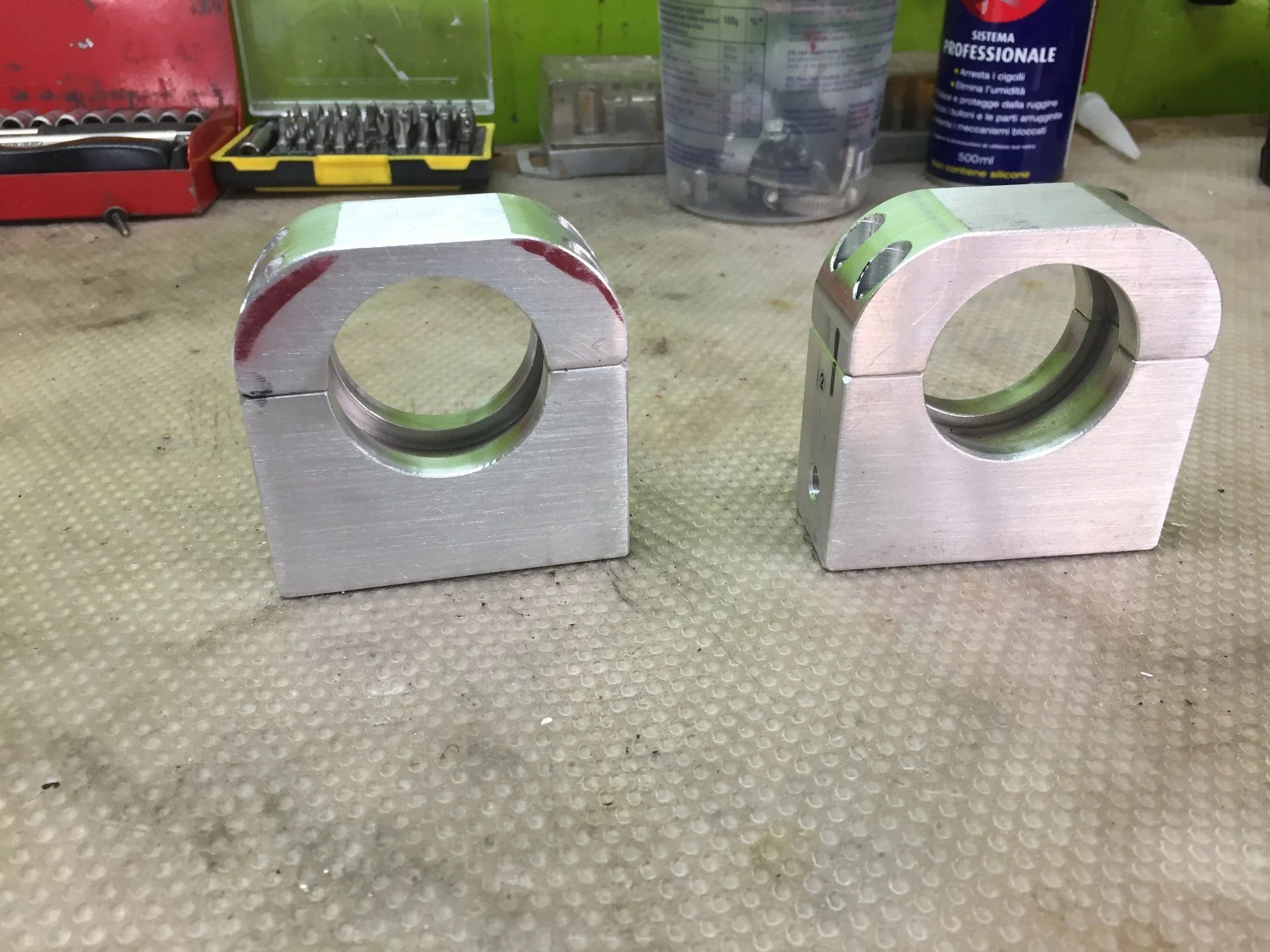

at last I found a friend of a friend that was able to make foe me a custom made bearing holder , suitable for my needs .
they are made in Avional , a strong aluminium alloy , I think series 2000 ?
here are some pic.
the bearing holders are intended to hold the central part of the transmission shaft firm and steady along the chassis .

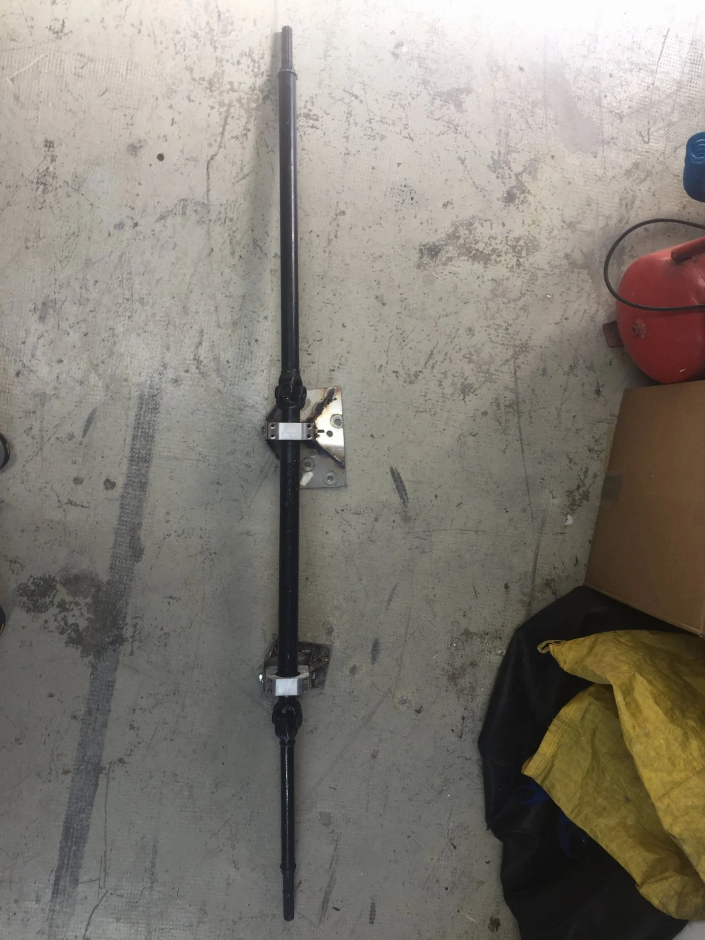

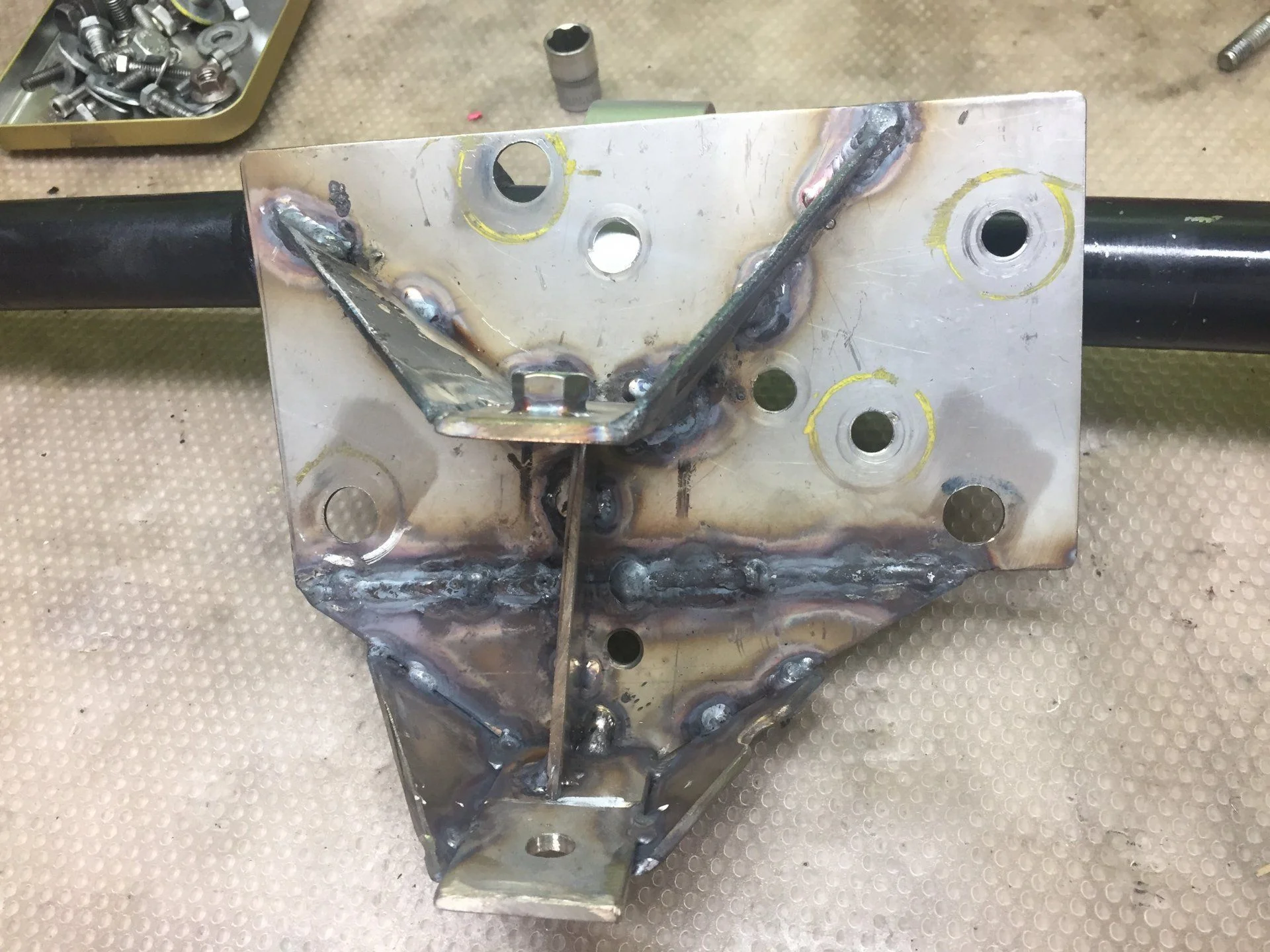

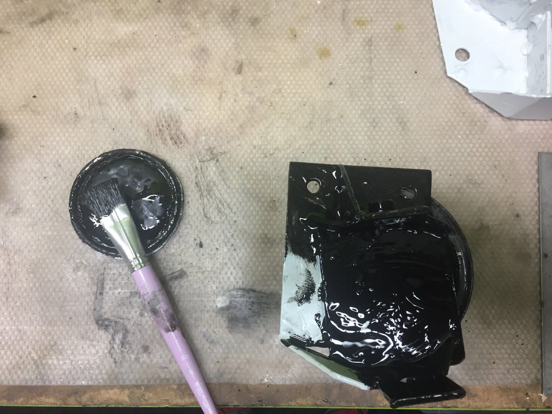

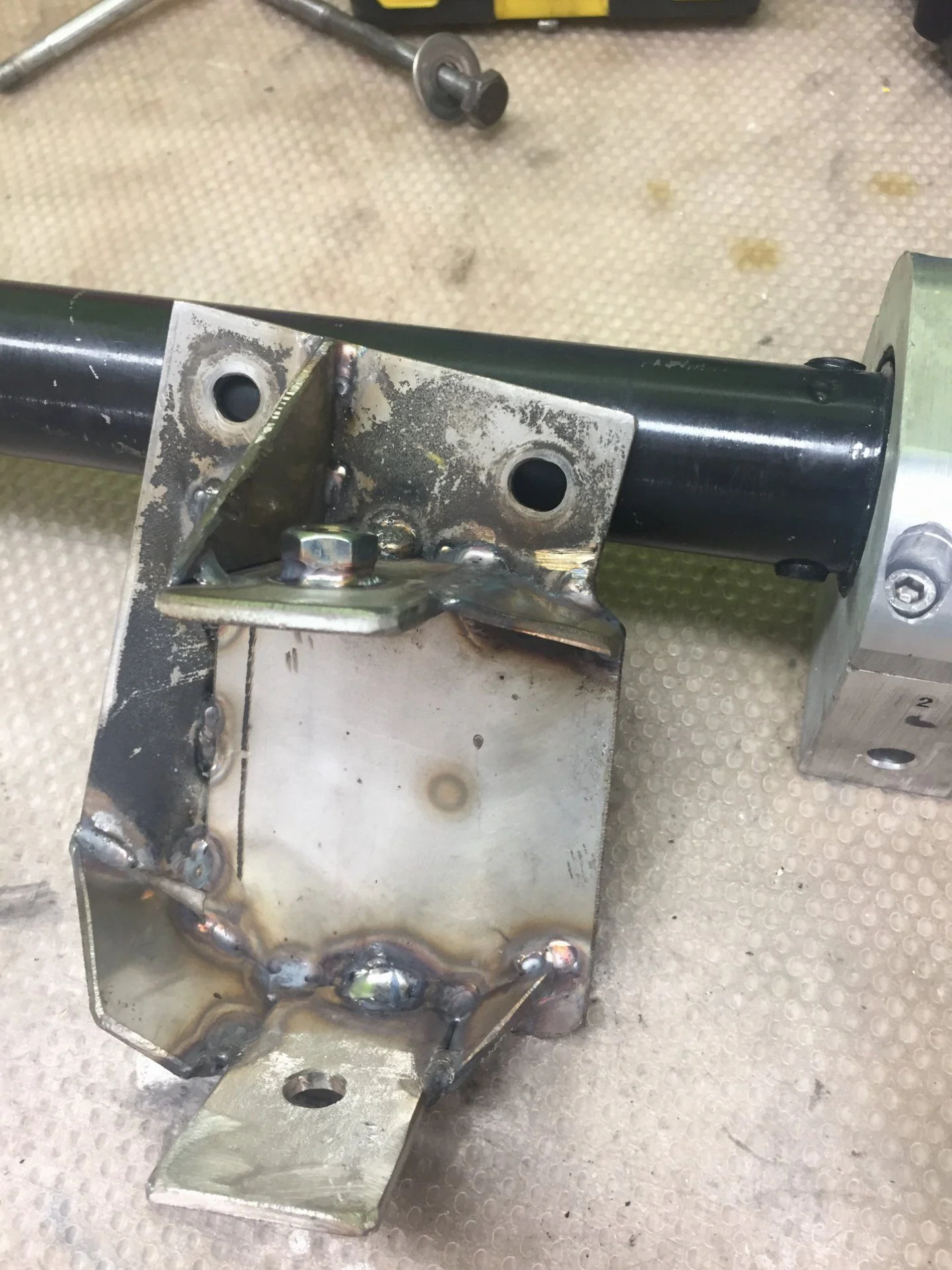

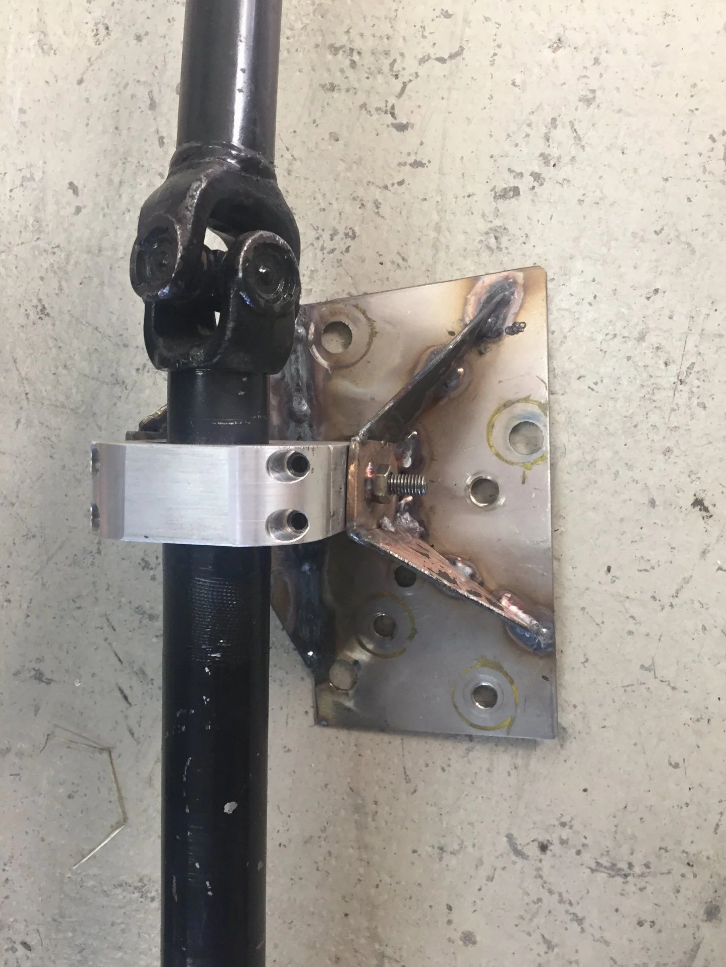

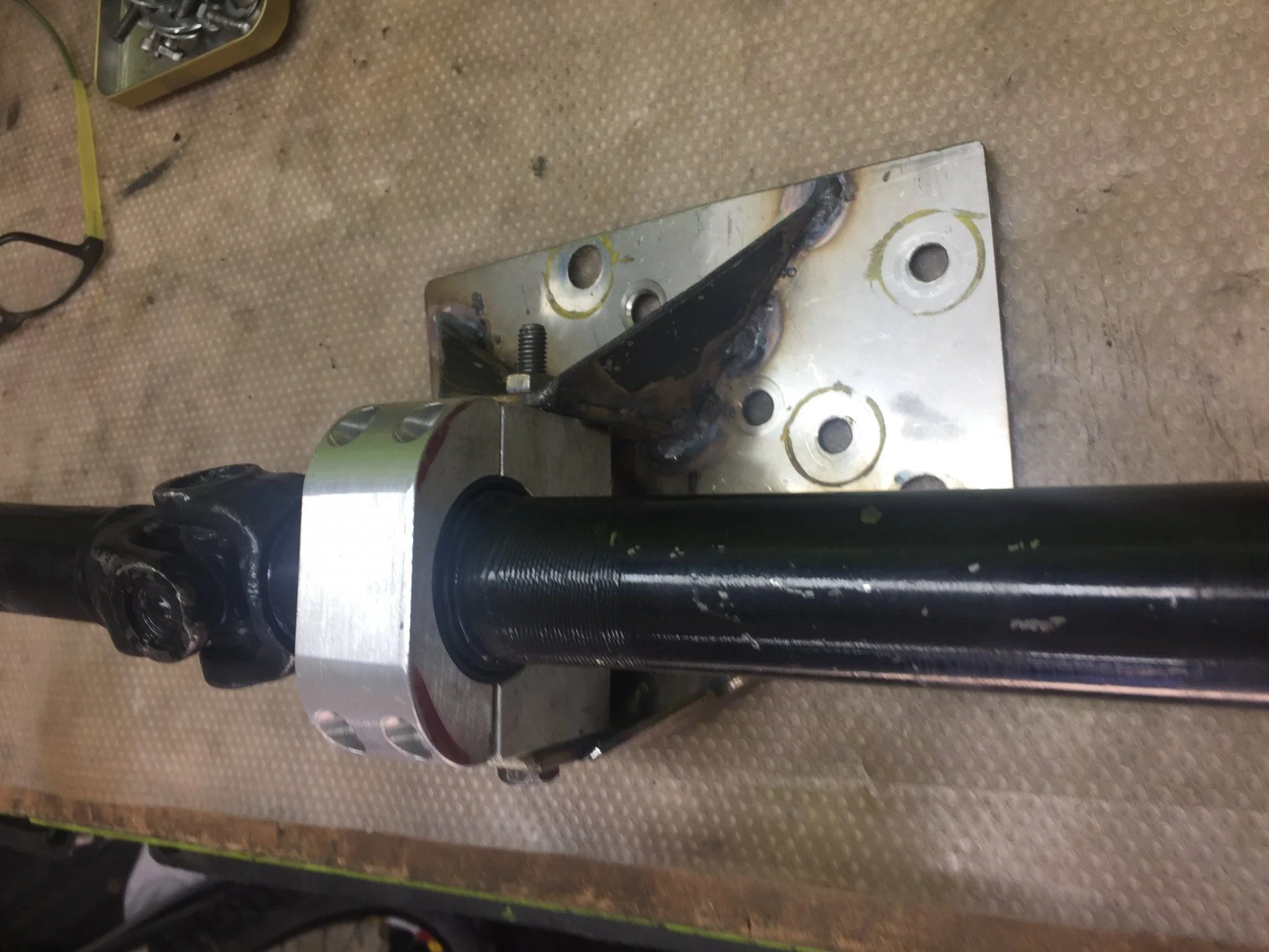

But as things are never easy and strait , the original frame bolts holes are not right for this transmission shaft .
so I hade 2 options :

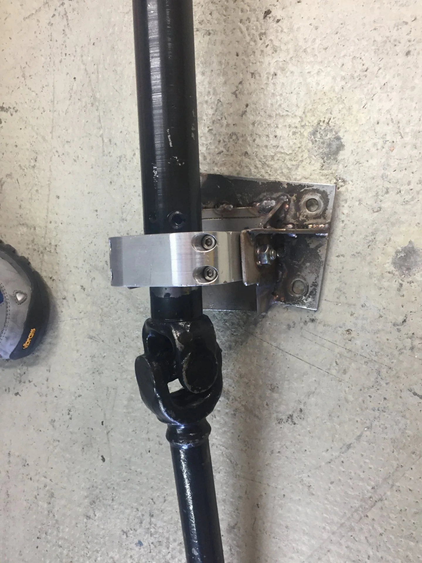

1, make new holes and threads on the frame in order to hold the bearings .
2, or use the standard ones present on the frame , but make new custom brackets .
i choose the second option , because to make new threaded holes in the frame is not easy , the walls are too thin , and the working space is tight .
here are some photos of them :
Thanks ,
We'll see if the job is well done as soon as I fit all parts , and start pulling .

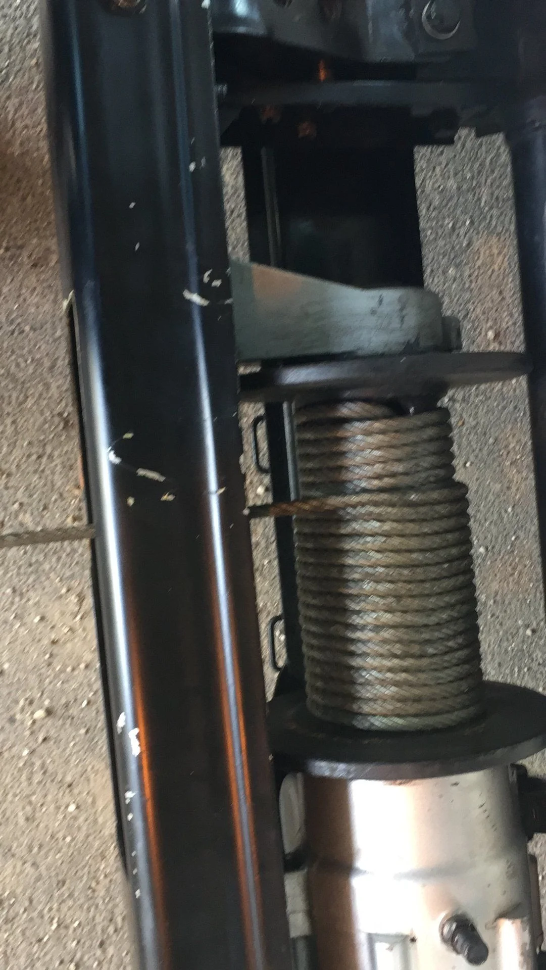

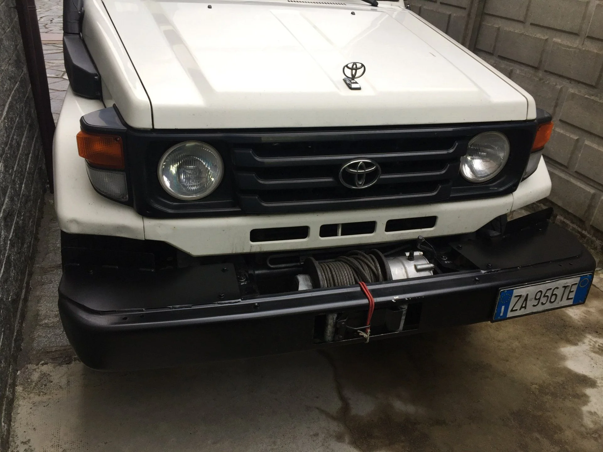

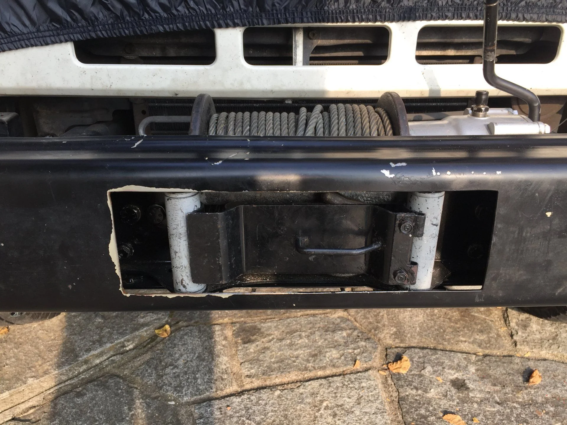

At last the end has arrived .
today last issues with mounting the transmission shaft , a pita in placing all bolts .
very narrow space .
Then it took me some time to roll up the cable , nice and tight .
but at last it works fine and pulls like a beast .

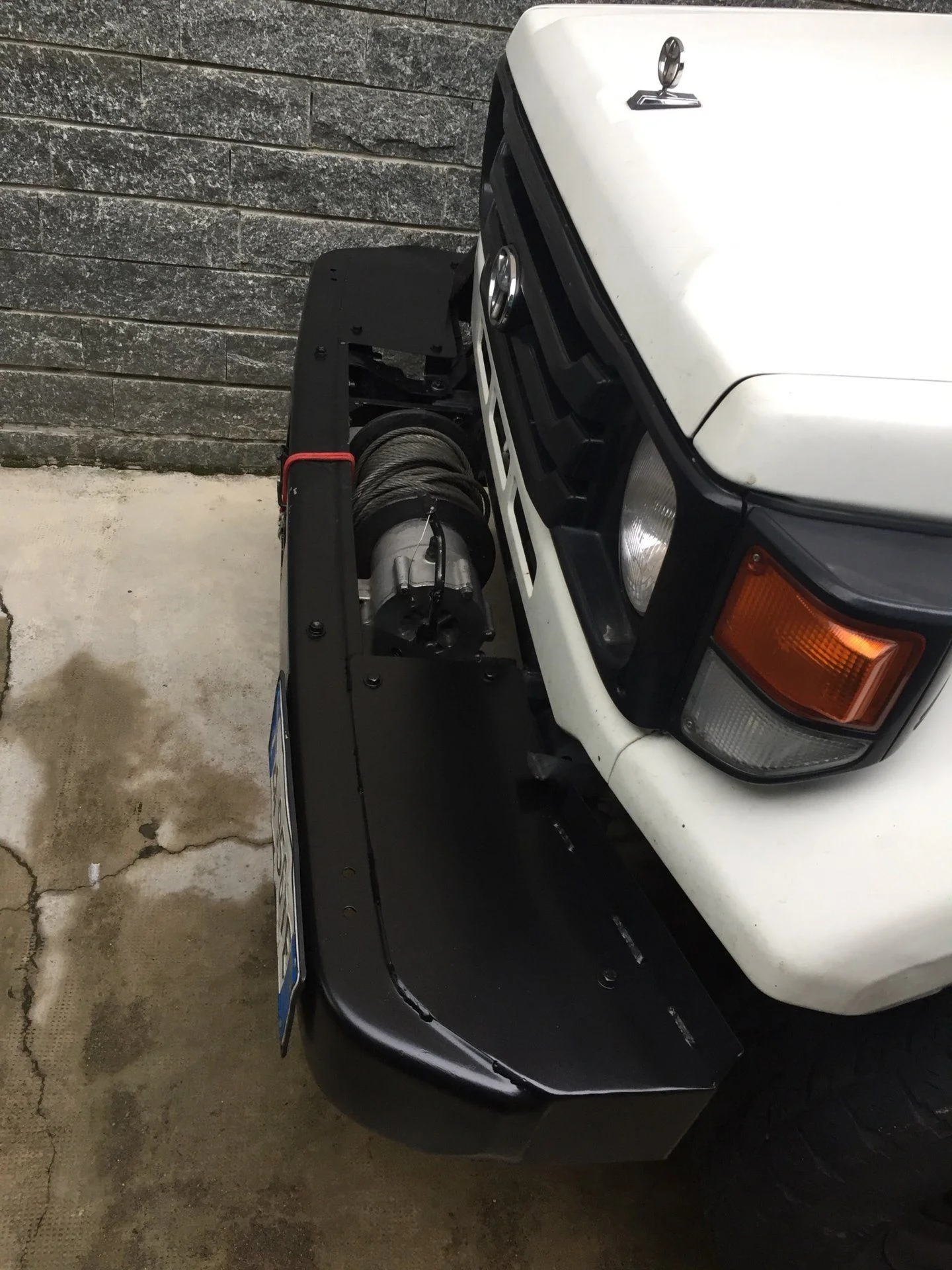

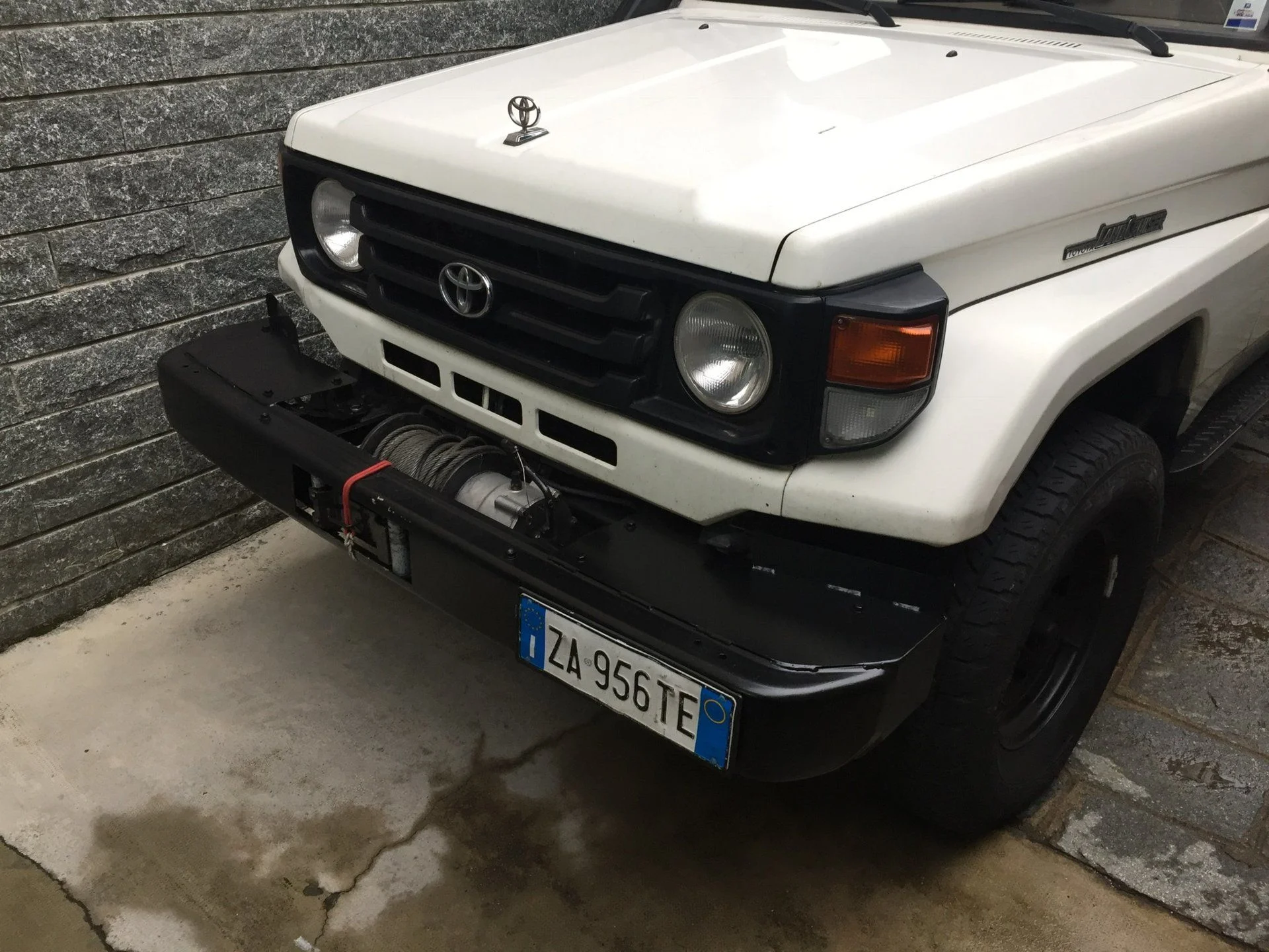

Small progress.

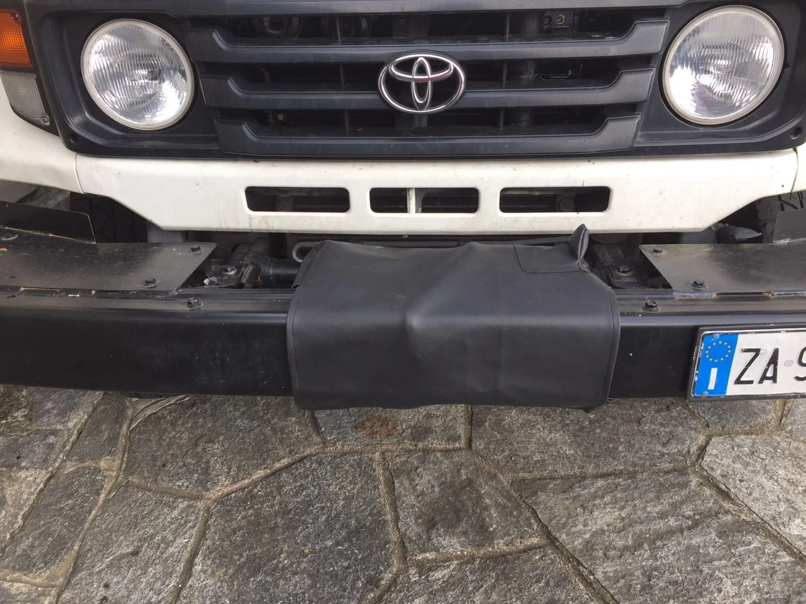

Didn't like all the empty space between the bumper and car, so was looking to find the OEM plates that cover up this part.
They are a viable but very expensive .
Turned out to make them inhouse .
Here is then final result after painting.
Nice finish on this project. It takes time to do it right!
