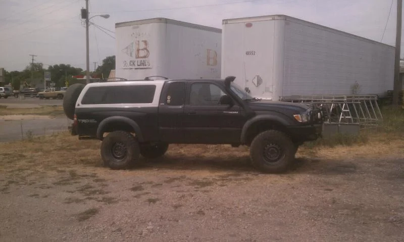

I used to run the 16" Tacoma spare steelies on my FJ55 using spacers. Look the same as the one you have pictured but black. Never had any problems on road or off. Seemed plenty strong to me, although I don't know for sure whether or not they are a lesser wheel b/c they are a spare.
Hope this is helpful.....good luck

The 16"x7" 16hole from a 1st gen tacoma has 4.5" bs.
Checked this morning and 4.5" is right on.
Also, I had to have the front center holes enlarged to fit over hubs on the FJ55. Don't know how pertinent that is to those considering this wheel, but worth keeping in mind.
I ran 1" spacers with these wheels without any issues. Loved the wheels and only changed b/c I wanted to go back to stock steelies and caps.

Hey Scrap, spacers were mainly for rubbing, but also aesthetics b/c the tires looked too tucked in.
I assume you'd need them enlarged slighty, too, but the FJ55 has Warn hubs and your 60 axles are Aisin. Not sure what the difference in diameter is.
