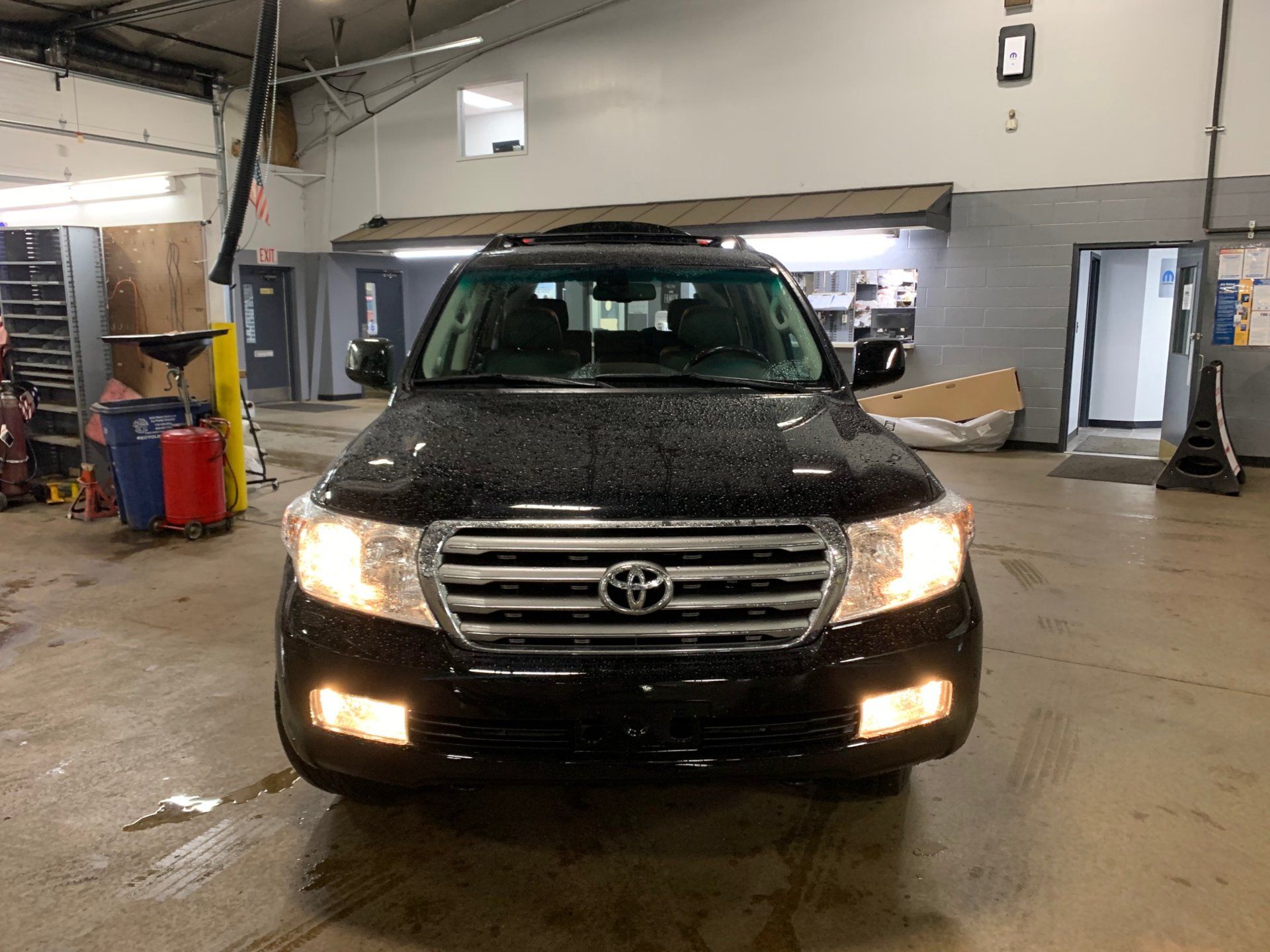

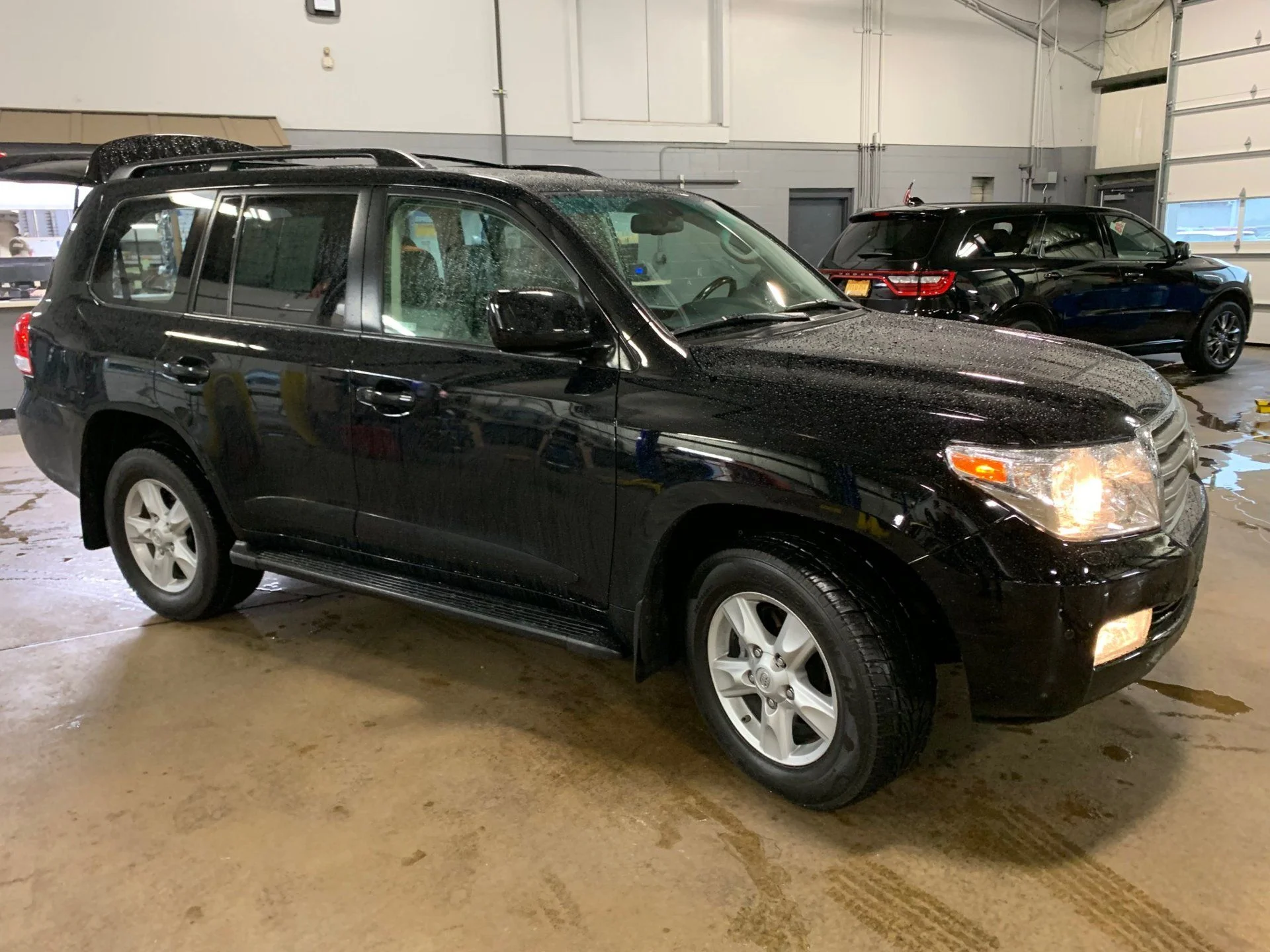

So this little honey came home with me last night. Man do these 200 series drive great!
I did call ahead to make sure they had it cleaned up and inside so I could see it while it was dry and also crawl underneath it.
2010 with 35k miles. Started life for 6 years in Arizona then ended up in northern IN and the second owner traded it for a new Jeep Grand Somethingorother.
X2 congrats glad it all checked out, happy trails :cheers:

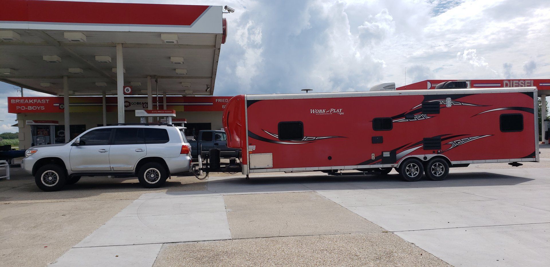

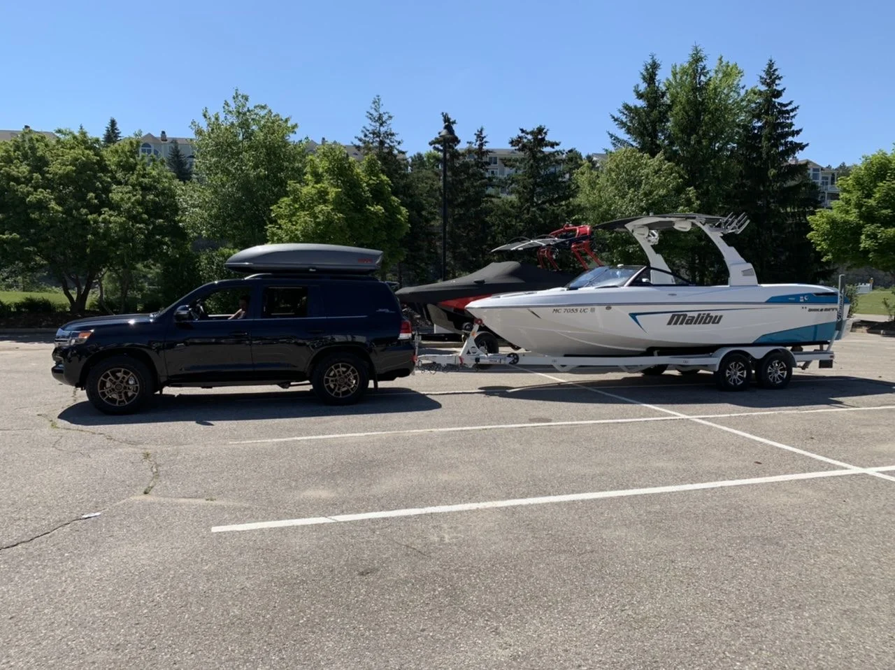

They do just fine :) I did add internal coil air bags and a weight distribution hitch after this photo. This was from the first time out with it just testing to see how it tows.
Wow! I'm currently sorting out trying to find an installer for airbags on my 2018 LC. Which airbag and hitch did you use?

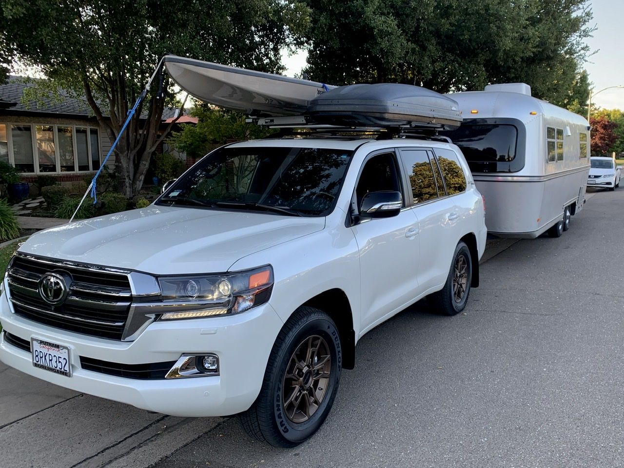

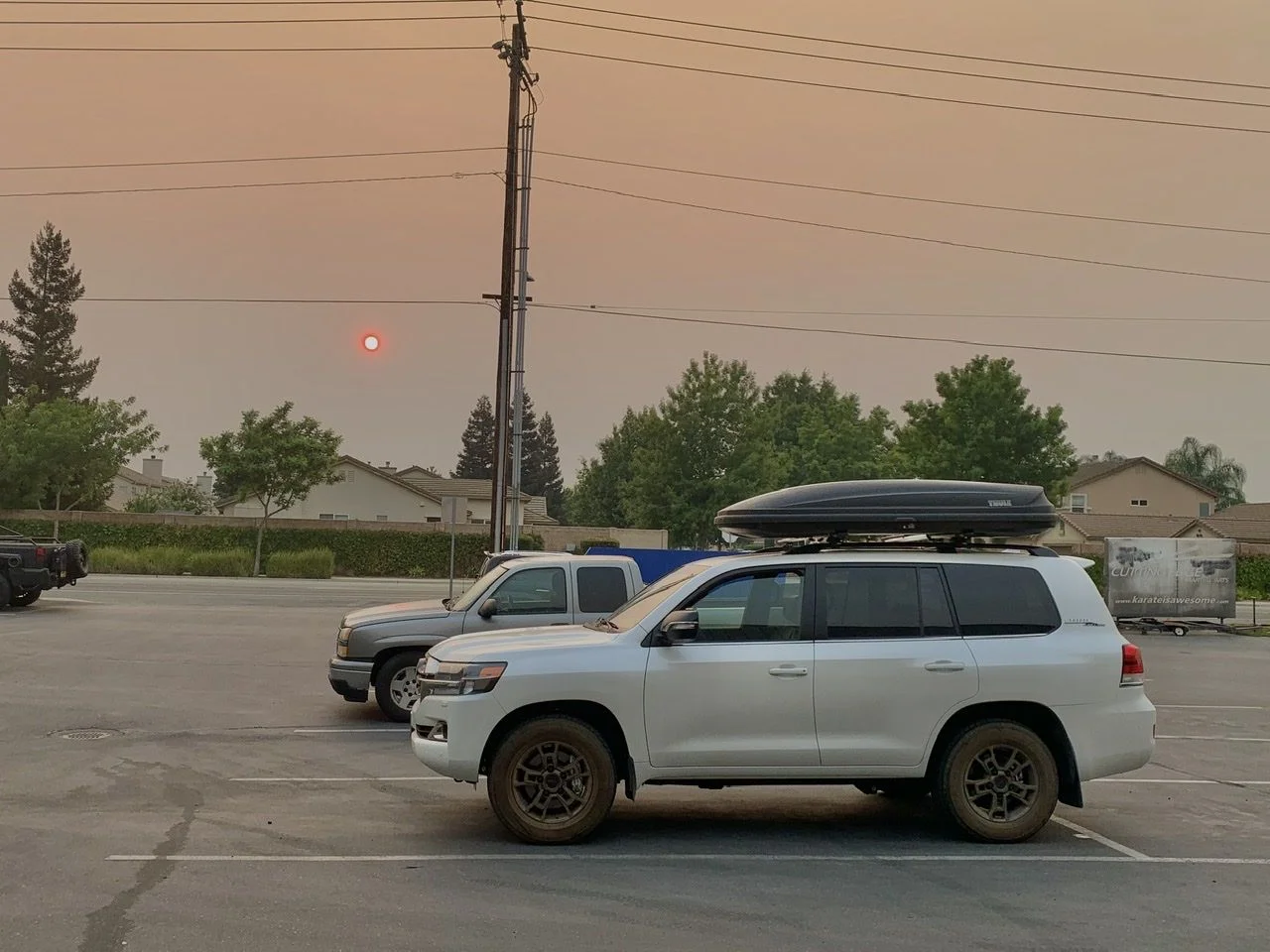

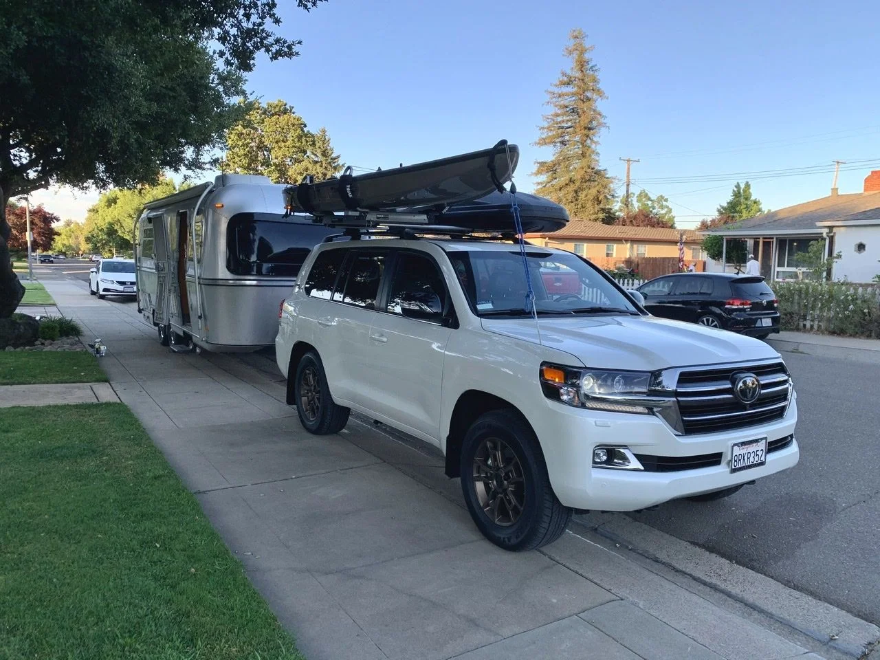

First actual trailer trip. Just finished 1500 mile.. with about 1000 towing. I used to tow the same trailer with a 100 series and then a 2016 Ford Expedition. The Ford 3.5 twin turbo is a great motor but lacking much engine braking. The cruiser V8 did great. A good RPM for towing is around 3000 and if pulling a decent hill 4000 RPM did fine. Lots of flexibility with the 8 speed. Always in ECT Pwr mode and mostly in manual S position limiting the high gear to 4th or 5th. Any long uphill or downhill I just manually shifted instead of letting the transmission try to figure it out. It didn’t stay in a lower gear long enough. This trip was generally uphill going and downhill coming back. MPG.. 8.5ish and a bit over 10 coming back. (To smokey hellish California) The trailer loaded is about 7,400 lbs.
Very pleased with how stable and easy it was. Actually better than the Expedition. I do have a new Equalizer brand WDH which may have contributed to that. The 2005 100 series would sometimes get a slight.. funny weight shift while slowing during a corner. The 200 was just solid. I used the cruise control quite a bit. Especially on long two lane roads.
Suspension is stock with stock tires. This was a concern but with the WDH the cruiser was level and never seemed to get close to bottoming out at all on unseen whoops in the road. ARB drawers loaded with my normal tools plus other stuff in the back, space case and kayak on top. And about 150lbs of poodles. Cruiser did great. Uneventful.. which is good!.
Is it a 200 thing where we can’t pull all the way into a parking spot? I do the same thing all the time. Looks like a great trip, nice hunting dogs.
