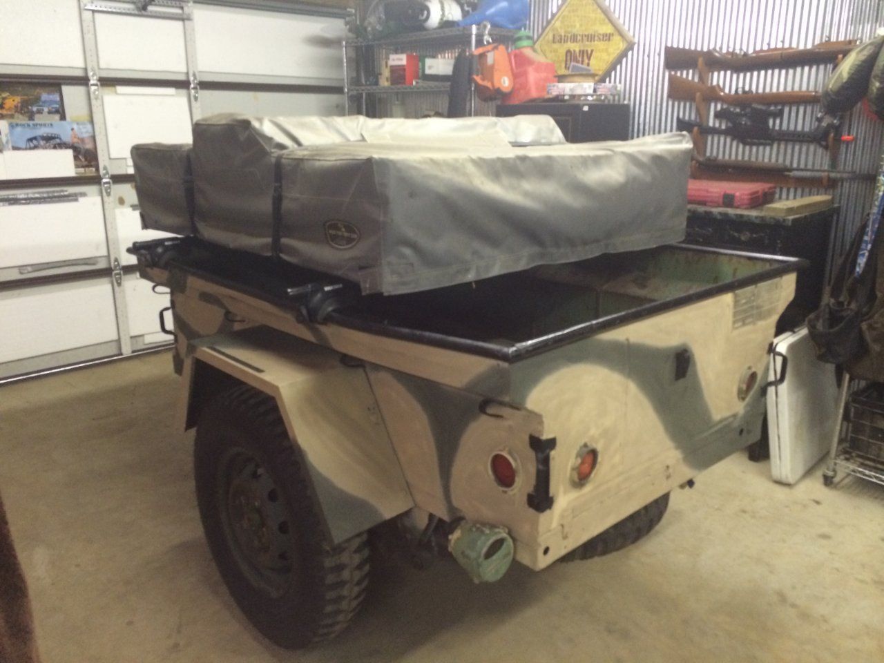

I got some great tailgate ideas off E Portal. This way I don't have to put a lid on it. Will haul wood and cooking stuff in here.
A receiver in the rear will be a good way to put a down leg in the rear to keep it from tipping while in the tent.

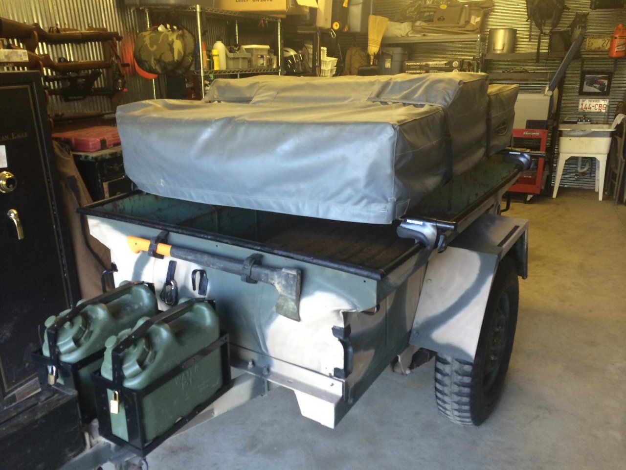

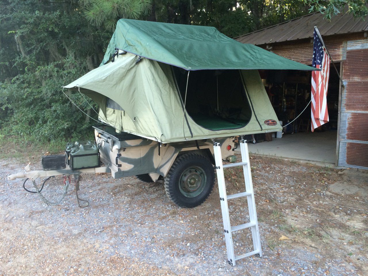

Well I played with the trailer on different spots on the rack and ended up with it pushed forward so I could easily access the box with the (future) tailgate up.
One advantage here versus the other way is that there is enough tongue weight I don't need a kickstand in the rear.
Weight at the jack with full water and tent stowed. Trailer empty. Easy to pick up and move still as the tongue is so long and it's balanced good
Knowing you and Red, I'd straighten the front leg and install dual rear stability/leveling legs!
