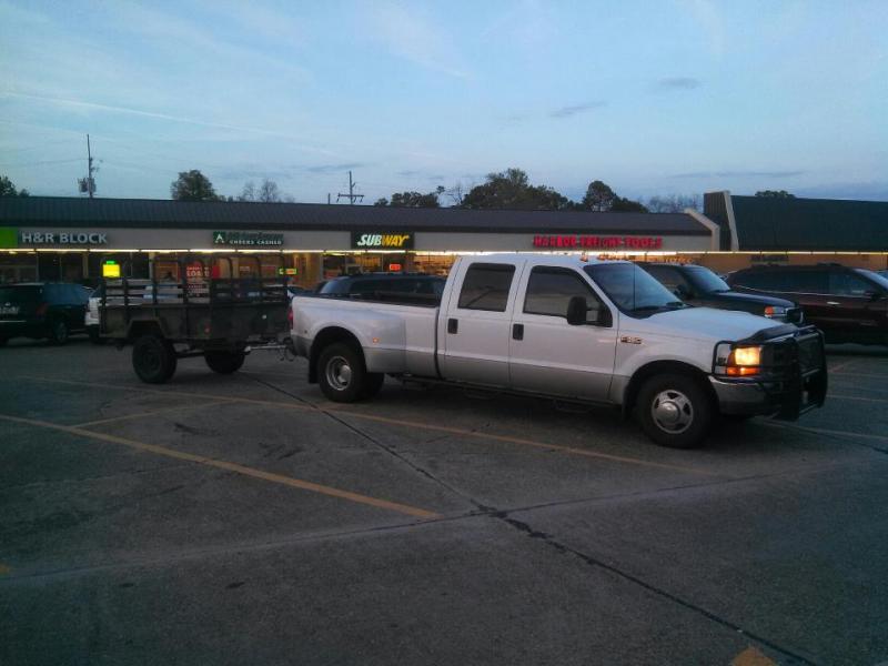

Lessons I have learned from hanging out in the Tow Rig section on Pirate4x4:
#1: if you ever tow ANY load with something less than a 1 ton you are guaranteed to kill a station wagon filled with nuns. Please note this is a minimum, if there is a rock crawler on the trailer you should strongly consider using a MDT. :rolleyes:
Needless to say, no nuns were harmed getting this home.
not only sending the nuns to meet there maker.
if you are towing more than you tow rig capacity "GVW" U are in deep do do :cheers:

:lol: sounds like they work for U-Haul :whoops: and nice trailer bud :)
ya don`t need a CDL unless ya tow or haul for hire. ICC DOT commerce rules then apply .
U really DON`t want & certainly don`t need a federal travel paper!
