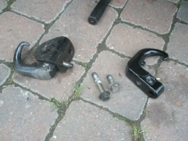

I have been given one of these:
I wanted to confirm my thoughts that it is not a recovery point but rather a tow or tie down point. Is this correct?[/
For light recovery it is fine, I have broken 3 of these under heavy pulls/snatches. If you do need to perform a heavy pull make sure you have a dampener on the line between the vehicles to keep the line from snapping back violently. It's not a pretty sound when they let go. I honestly don't think many people need to worry about this, but for safety reasons you can't be to safe. The little "d-ring" mount is solely a tie down bracket. Do not use that for pulling/recovery, it will give way at the worst time.

Perhaps best then to remove both the D rings and the one I have pictured that is already on the truck and replace with propper recovery points.
I would invest in some Spresso FRB's. I know you are in EU, and shipping may be expensive, but having proper recovery points is vital. Pulling from poorly designed recovery points is never a good idea, heavy or light load. I have never trusted the 100 (even with aftermarket tow points) under heavy pulls. Between the front diff or the recovery point/locations I'm not sure which is a worse design.

If you add an ARB bumper, and possibly others, the supplied bolts are not long enough to include that hook.
Yeap, that was my dilemma too.
I dont follow. Are you referring to the rear ARB? Because I ran those with my front ARB for a couple years before I removed and replaced with the older style recovery bracket. (the ones that were around before Spresso). I didn't have to source different bolts to run those hooks on the front.
^ Just for the record...if you are referring to the original FRB as shown below...then this was my original design for a recovery bracket. I had a batch made from 6061T6 with milspec hard anodization...and then there were a couple other members that offered a steel version of same later on.
My original frame recovery bracket wouldn't fit some of the ARB bumpers...and hence the impetus for the redesign.
I hadn't remembered you did the first run.... man that was a while back. Mine is the same design but in steel. Either from the first or second run after the original.
