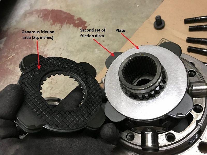

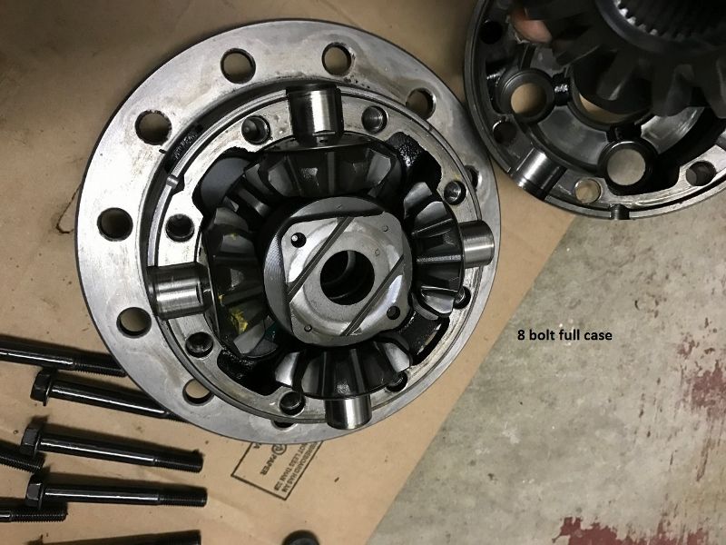

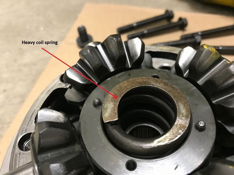

No experience with that LSD...though it looks to be quite strong. The Toyota unit is rough looking..but robust. It works O.K. but needs quite a bit of wheel spin before it actuates. Any 'original to the vehicle' unit is no doubt in need of new Friction Discs and maybe the 'steels'.
Since you are 'down under'....you might contact 4x4 World there. They might be able to shed some light on the various LSD's.
Toyota LSD (photos borrowed):
The Toyota LSD is a clutch type LSD and the Torque Lock LSD looks to be a Torsen type LSD.
Clutch LSD: will have lockup when a tire is in the air but wears out over time. The clutch lockup action will work all of the time.
Torsen LSD: will spin a tire when it's in the air but will never wear out. The Torsen lockup action only works when power is being applied and gears are turning AND both wheels have at least minimal traction.
