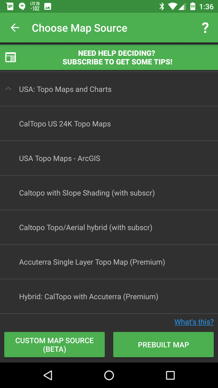

You pick and choose, you can also import them from outside sources.
Has Gaia allowed support from the app to select the USFS Maps within the app or do you have to load them in manually?
Then to be super nerdy with my Nexus 9 tablet I can run split screen with Android 7.0 and have APRSdroid and BCNV up and running.
It's within the map. USFS Raster as well as a couple others from Cal Topo.
You can also upload motor vehicle use maps from national forests that have them published online (typically those which have already passed their travel management processes).

Topos available for the US -
USGS
USFS
Cal Topo
Vector topo
For any of the maps above you just highlight the area (big or small) you can also adjust the available zoom for needed level of detail to control file size. Along any of Gaia maps you can DL the aerial view that can be overlayed on top of each other. It nice to DL both the aerial and the topo together on an area of exploration so when you come across a road that is not numbered or does not show up on your topo map you view where it goes using the aerial view.

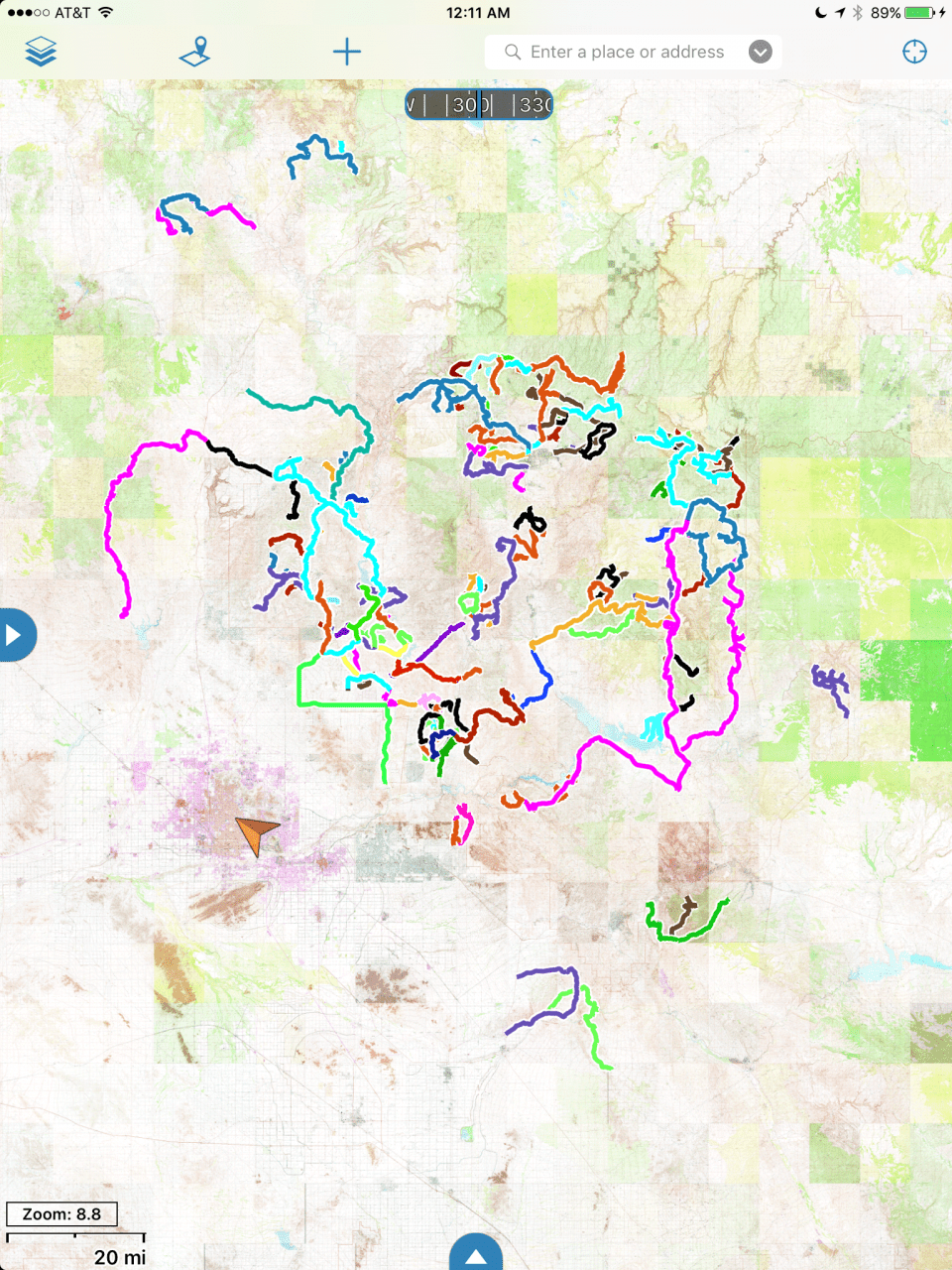

I do volunteer work for Tonto National Forest, so quite a bit of it has been there (nearly 1,600 miles of dirt since April of this year alone). Maybe I need to focus on getting out more? :hillbilly:
22 months worth of tracks in AZ:
