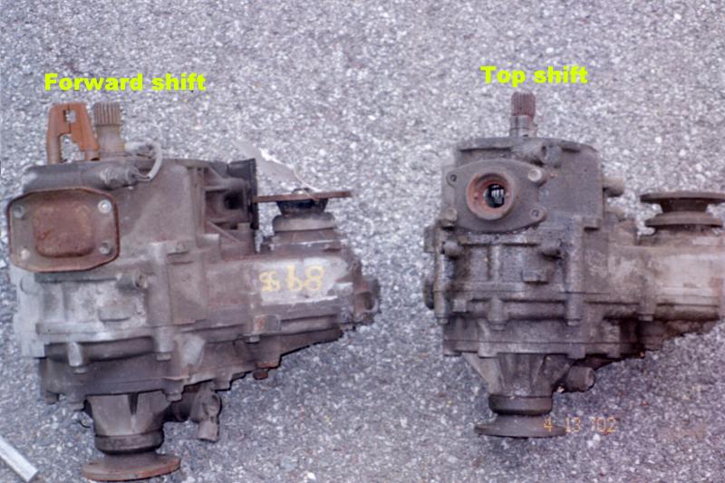

It's not so much which trucks, but which transmission. Most of the G-series trannies are forward shift, I believe all the R-series are too. Most of the W-series are top shift.
Good selection of pics here:
Rebuilt Complete | Marlin Crawler, Inc.
I believe your carbed trucks both have G-series transmissions.
Very simple answer:
(1) All 1979-83
(2) All 1984-88 with 22RE EFI engine
The 1984-88 22R carbureted engines all have a front loader, and everything 1989-newer is front loader.:beer:

The top shifter, and to echo Jim, is EFI only...
