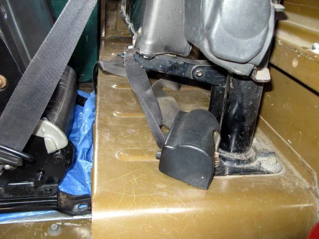

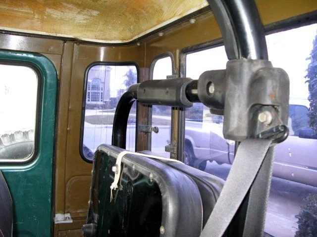

Top and bottom both attach to the factory roll bar originally. Hard to imagine what parts yours is made of without some pics. Sounds like you might have a top from an earlier year.
Ignore the extra lap-belt reel attached for the jump seat. It's not original. You can see the lower shoulder-belt reel above it though. In the bottom pic the driver's seat is sitting in the back when I was working on my tranny, in case you were wondering.
